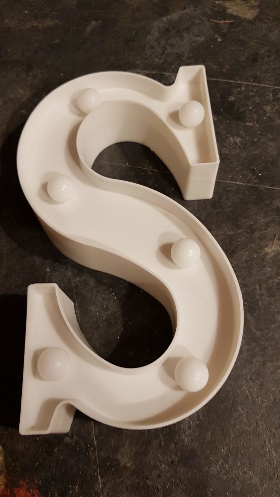

I'm after some advice about letter lights I've purchased and the best way to wire them all together to work from one switch.
If you look at the photos you will see the letter 'S' I have purchased along with 3 others so have 4 in total with each one having to be powered by batteries individually.
They all use the same power which is 2 x AA batterys obvioulsly 1.5volts for each giving me a total of 4 letters at 12volts.
As I said they are powered individually and I want to be able to turn them all on and off with one switch with one power supply so I would appreciate any info on the best way to do this, I do need the power supply to be quite compact.
Many thanks
Edit - Could it be as simple as extending the on/off switch wires from all 4 letters to connect to just one switch keeping the AA batteries in each letter?

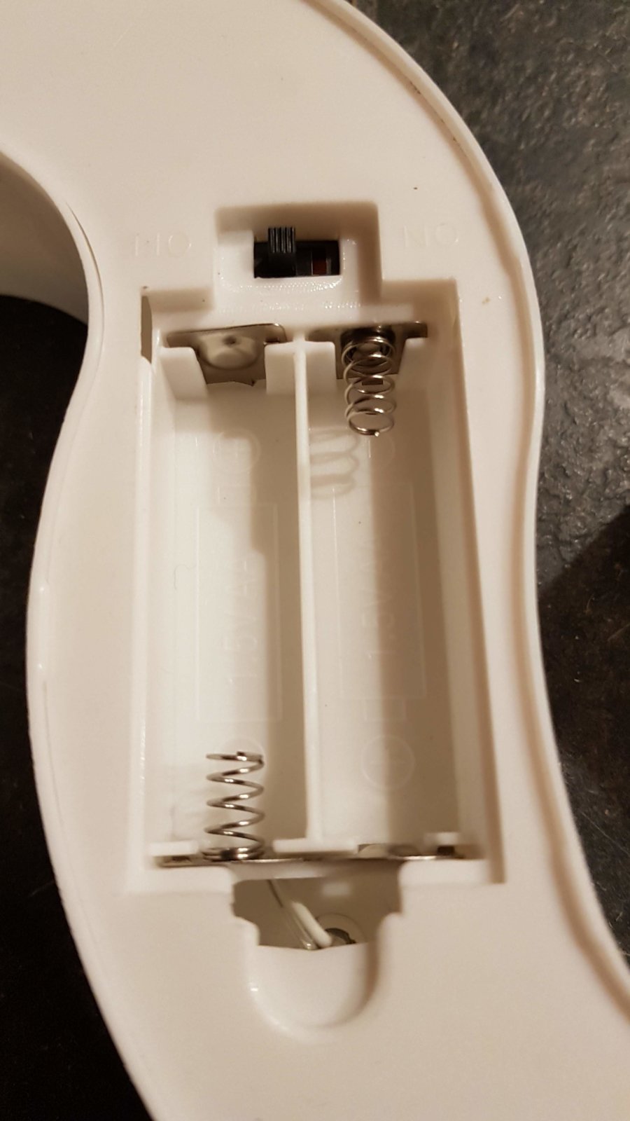

No, 4 letters at 3 volts. They're wired in parallel.
The two 1.5V batteries will be wired in series to give 3V.
easiest way will be to get some thin twin flex, connect that to the two battery terminals (at the switch end) on each light and connect at the end through a switch to a separate battery holder. As this will be supplying several lights you might want to use 2xC or 2xD batteries as they have much higher capacity than AA. You will need to observe correct polarity + and - throughout, as the lights may be damaged if the polarity is the wrong way round.

Some of these letters have LED elements that rely partly on the internal resistance of the battery as the current control. Larger batteries with lower internal resistance may allow higher current flow in the LED elements.
Could this knacker the bulbs then?
It might reduce their life a bit, depends on the quality of the elements.
Correct.
I've handled some lights for displaying glass crystalware which specified 2x D NiCad and emphasised not to use alkaline or zinc batteries. Of course the trader did not have a Scooby and used Duracells, none of the LEDs lasted as long as the first set of batteries.
Quick update guys, battery holder came and I'd already wired the lights in parallel and the holder was in series anyway. Connected it up and works a treat so many thanks
