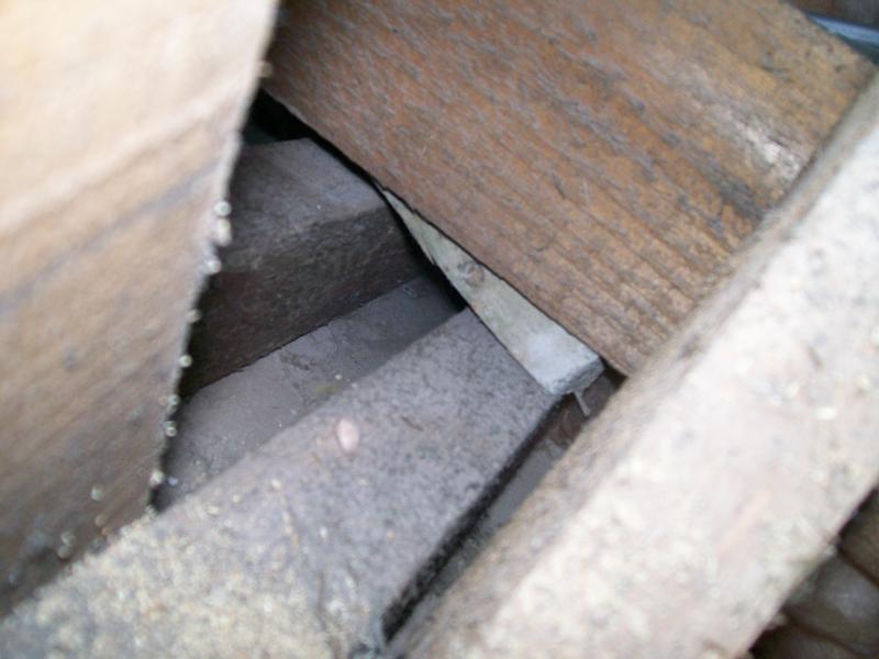

Second, my plan was to lay timbers down on the ceiling binders (?) 'cos they seem fairly strong, but they have breaks in places to accommodate pipes as you can see. Also, they seem to rest on the actual joists and are toenailed (?) into them. I thought they were meant to support the joists, not rest on top of them......?

In any case you shouldn't rest anything on the binders. You are correct when you say they should support the joists, they do this from above, holding them up, but they also serve to keep them equidistant and prevent them from twisting. So any weight you apply to the binders will be transferred to the joists and make the ceilings crack and bow.
The binder should not have been cut like that to install the pipe, unless there is a wall beneath. Far too often you see cables and pipes that have been installed by just hacking away any bit of wood that gets in the way. Like you say, shoddy.
You might get away with installing deeper joists alongside and fixed to the existing, this might mean you can lose the binders, as the joists will become supported by the new ones, which must be sitting on loadbearing walls. Noggins or struts will also be needed.

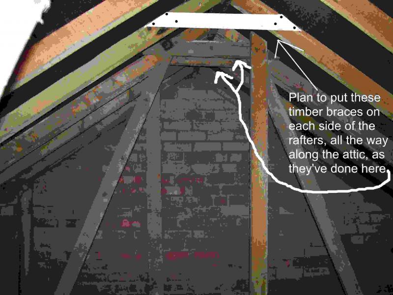

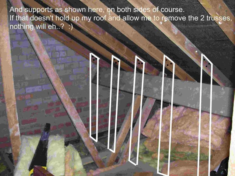

this is what i plan to do, to support things in order to allow me to take out those trusses:
what u think?
That vertical hanger makes me think even more that it's holding up the cut section of binder.
Ading all those vertical studs won't do a lot, unless you plan to remove the chunky purlins (which I do NOT advise!)
The horizontal spars at the top may not help much but certainly won't do any harm.
What you need to do is figure out what's going to happen to the binder once you remove the 'truss' I suspect bad things.
You might be able to supplement the binder with a much deeper section of 8x2 or 9x2, fix this alongside the binder along it's full length, and cut over the pipework. This will mean that the binders original function is reinstated.
These are just suppositions though, and I recommend getting expert advice before taking out anything from your roof structure.

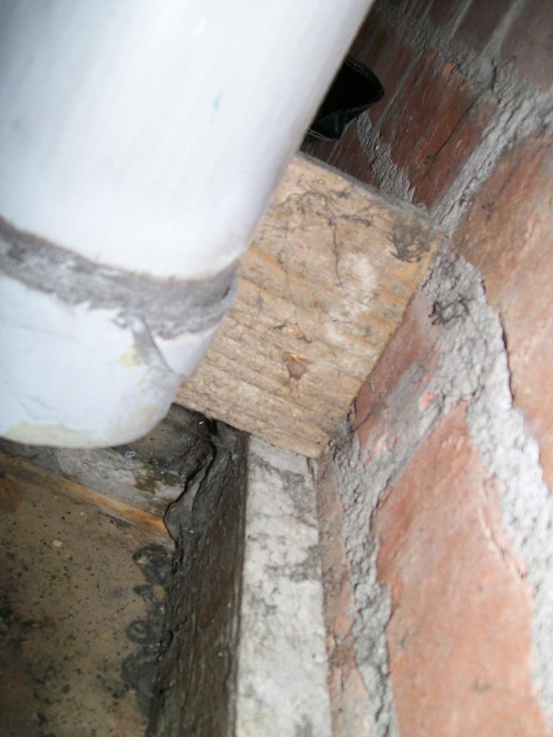

See pic for the wee scrap of wood propping up the binder near that cut for the pipes. Its laughable isn't it?

That binder is only an ornament. It needs to go into the wall so that it supports the ceiling joists. That's its only job. Nothing to do with the roof.
The rafters are supported by the substantial purlin and looks pretty good to me. Can't see what the truss is all about.
Thanks, its good to have your suspicions confirmed about something. In which case, all the 3 binders are ornaments, 'cos none of them are attached to the brick-work in any way.....................................its a joke.
