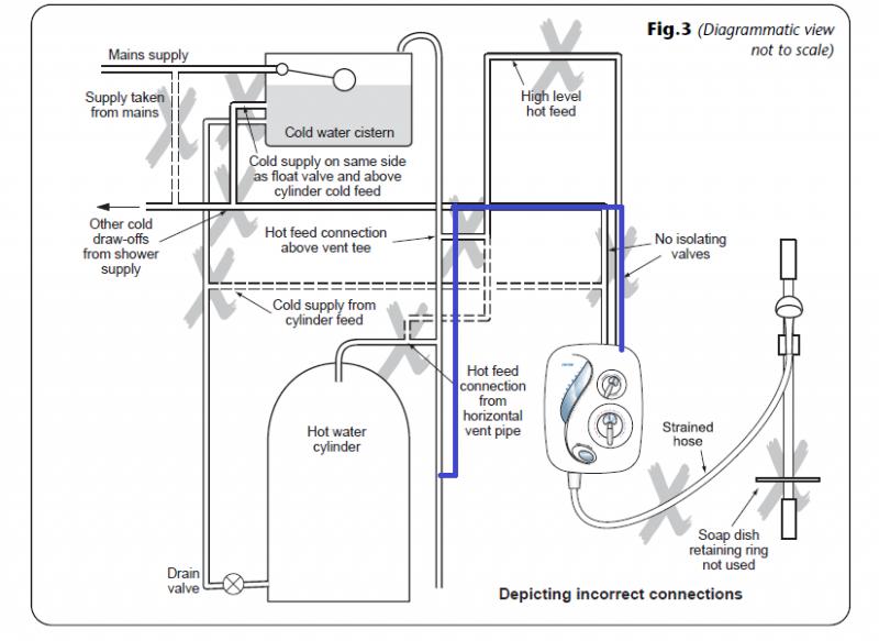

On the below diagram the instructions state i cant feed my shower from the high level and shows the hot water supply going above the cold water tank with a big cross through it. I have drawn on the diagram in blue where i would like my hot water supply to run, will this be ok ?
up into the loft to loft floor level, then along loft floor (level with cold water supply pipework but 500mm below cold water storage tank)
