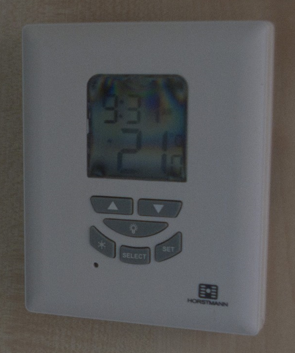

I have a Total Home TTHWFP heating controller as of the start of the year. It was fitted alongside a new relay box by a heating engineer. I have it programmed to come on for a couple of hours in the morning and the same in the evening and it was initially fine. Around May this year I remember waking up in the middle of the night to find the radiators on when it certainly wasn't cold enough to require this according to the programming. I temporarily fixed this by just manually switching it on or off and time got away from me....we had a really hot summer where the central heating wasn't required and I just never investigated further.
Today i've turned it on again for the first time just to test because I know it will need to be back in use soon and it is immediately acting up. Its on the Auto setting (i.e. programmed to kick in twice a day) and the thermostat has both:
1) Had the flame icon (so requested heat) when the temperature shown on the screen is definitely above the temperature that should trigger this. The boiler fired up.
2) The boiler has also fired up when the thermostat does not have the flame icon.
3) The relay box has shown a solid red light for some part of the time, which doesn't actually appear in the troubleshooting section of the (very short) instruction manual.
These things have happened within a couple of hours. Fundamentally the heating should not be coming on at the moment because the room is warm enough but it definitely has done so intermittently. Does anyone have any ideas for troubleshooting this? I'm confused whether there is an issue with the relay or thermostat or both. I've now just turned the thermostat to 'OFF' but would like to have some heating at some point! The device itself is probably under warranty but there would still potentially be the cost of getting a heating engineer to come and install a new one even if I got a new device.

CountryFan's got it, fresh alkalines (not rechargeables) and a rebind sorts half of these wireless stats, do that first. On the solid red light, on most of these receivers a solid red LED means the relay's made, ie it's actively telling the boiler to fire. So if the boiler fires with no flame icon on the stat, the stat and the receiver are disagreeing with each other. Either the relay in the receiver is sticking, the binding's dropped out, or something else is calling the boiler in, like a timer or a cylinder stat. Once you've rebound it keep an eye on the receiver, if the red light comes on with no flame icon on the stat that's your answer. Worth checking where the receiver's mounted too, jammed right next to the boiler or a router and they misbehave. The flame icon showing when you're above setpoint can just be the stat cycling on its proportional band, check the cycle rate in the installer menu while you're at it.

1. Flame icon on but no details as to the setpoint and the measured temperatures, Certainly if the flame symbol is lit then I assume the thermostat is asking for heat.
2. Not clear whether this refers to a current of historic event, but boiler on without a call for heat from the controls may be caused by a zone valve sticking open after being idle for several months.
3. Red light on the receiver usually refers to a loss of radio comms - as already dealt with by others.
Finally you reported that you have turned the thermostat 'to OFF', but not indicated the result. Did you mean you selected the OFF setting, or removed power to it? Precise reporting of symptoms helps greatly with remote diagnostics.
