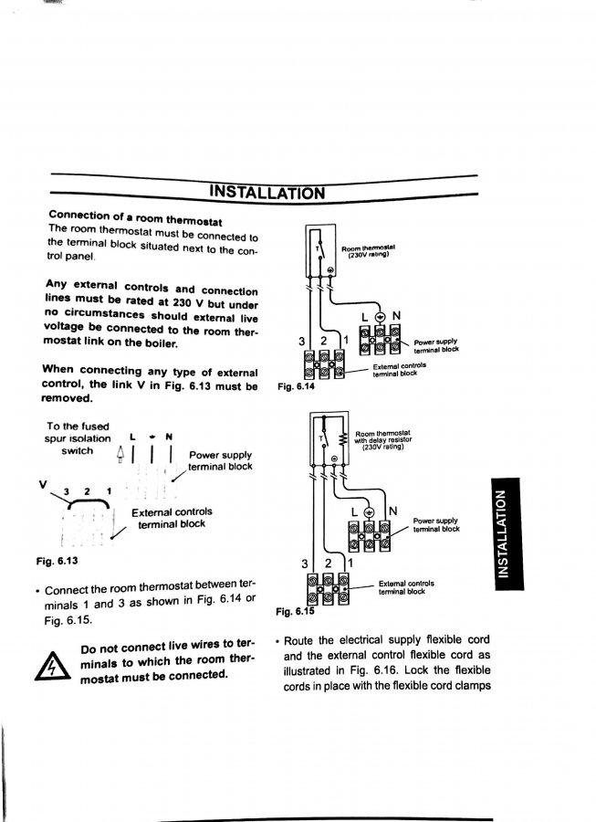

hello anyone can help me with wire a thermostat ??
thank you very much !!
That info seems enough for a competent person to connect a stat.
But Biasi boilers must be connected very carefully or damage can result to the PCB.
I fear damage the PCB, to avoid..asking

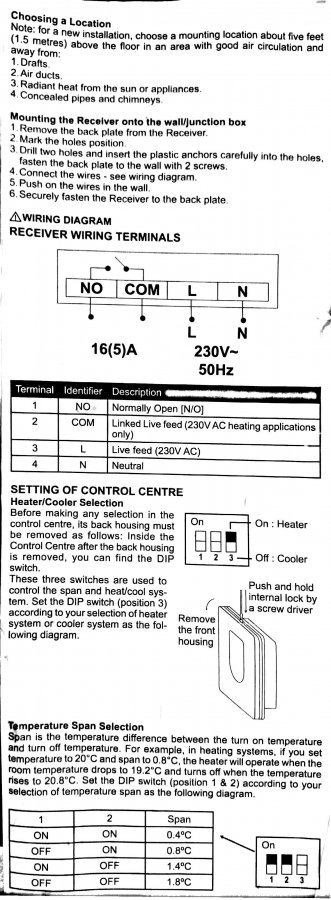

Can anyone give me advise, NO and COM where I should connect

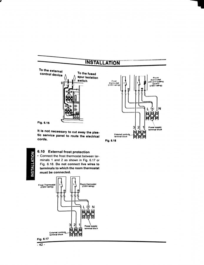

NO and COM go to 1 and 3 shown on page 2
Boiler is supplied with a wire link across 1 and 3. Your external control NO and COM replace the wire link.

thermostat has a COM (linked live feed) and "L" live feed
on wiring diagram L and N is connected to the neutral and earth?? if that makes sense
Is exactly what I write. To get the boiler working for CH, 1 needs linking to 3 and boiler runs for CH unless Hot Water tap running; NO and COM does that linking when timer makes a call.
Get an installer if above does not make sense
