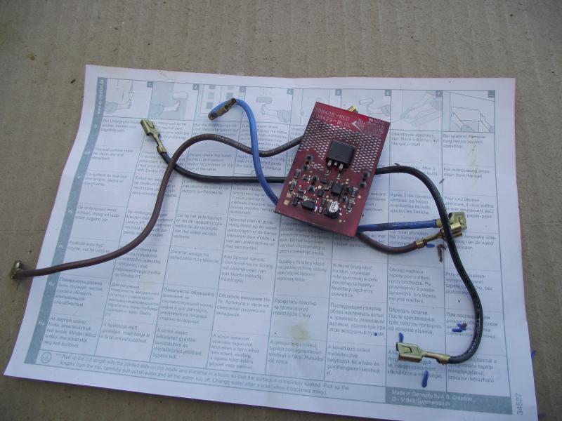

I bypassed it initially just to prove it was the cause and then replaced it – I need a lower suction for curtains/cushions so didn’t want to bypass permanently and lose the lower power option. NB the PCB design has actually changed (still 4 terminal) and is wired slightly differently – there is a wiring diagram included with the part which gives full details.
I very much doubt it is possible to repair a PCB, I did try giving it a clean and looked for anything obvious but more in hope than anything else.
I suspect, given the young age of my Henry and the similar experiences of others on here, changing to a HI/LO switch with a light has not been a positive move for Henry.
Do you still have the old board?
Any chance of a photo of both sides of the board and of the diagram even though thats for the newer board. Much appreciated.
The old board might be in the bin, I'll have a rummage if it helps. Will happily scan the wiring diagram for the new PCB for you. Can you message me your email address so I can send it direct to you - don't know how successful I'd be posting a photo on here!

Just to revive this thread i had the same problem with my 2 yr old Henry so removed the small pc board and wires as shown in this photo.I then wired up the two white wires to the opposite side of the on/off switch and all is now working except the turbo switch which we never used anyway..easy.

- Failing this, some Henrys have a hi/lo switch that may be faulty. As has happened twice to me in one week with 2 different Henrys. This switch is attached to a tiny circuit board further within Henry's casing. Unscrew a further 3 screws to get to the motor compartment, making sure to lift the casing off the right side up. The wires from the hi/lo rocker switch can be clipped off and transfered directly to the on/off rocker switch, where the live and neutral should be. Simply throw away the useless circuit board and keep the disconnected hi/lo switch in place if you wish. You will not have the hi/lo facility anymore. As your Henry gets older, you may find the hi/lo facility becomes an annoyance anyway! Not worth the hassle to replace in my opinion.

Thanks for the advice on bypassing the PCB & Hi/Lo switch guys!
You're guidance was much appreciated.
You have saved another Henry from the dump.

I know this is a very old post but I hope someone still can reply. I have numatic stopped working. Cable is and on/off switch is ok too and motor as well I tested by directly connecting to power. I am trying to bypass pcb hi/low switch.
As per this
The two white wires that go to the motor. They go to the on off switch one will be live the other neutral then discard the wires to the hi low switch and it don't matter which white wires just any one on live other neutral terminals.
I can also confirm the hi lo switch failed for me too.
And this
Here is a picture of the writes after removing the pcb board:
[/img]
As said above the 2 white wires from the motor now connect to the on off switch.
Pictures shows both white wires connected together? Is this right? I tried it but i get nothing?
Do i connect 1 white to brown and the other white to the blue on the switch?
