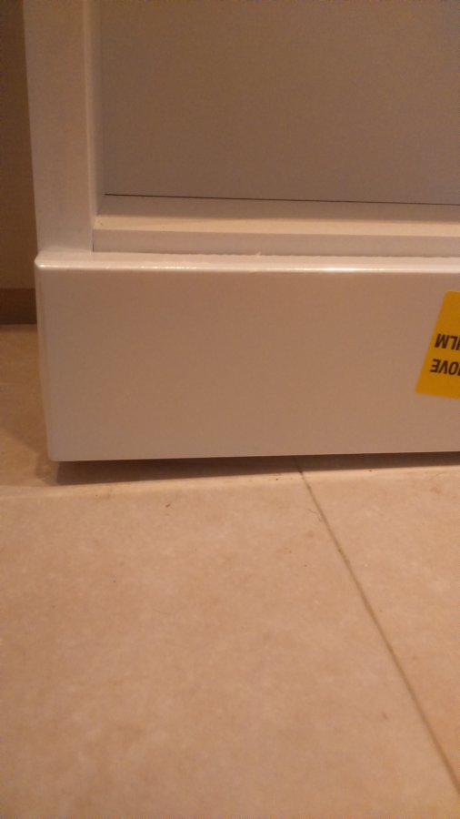

I've just installed a new vanity basin unit in a small cloakroom and have found that the floor is not level. This has created a 9mm gap one end (see photo)
Any help with on how to hid it?
Thank you

Removing the bottom edges that prevent it from sitting level.

Thank you.
That's probably the best way. I was hoping that some sort of sealing strip was available.
I'll get the power plane out. Luckily I haven't started the pipework yet.
Thanks again
David
find a piece of wood or something the same size as the biggest gap, then place a pencil above that piece of wood and draw a line along the base following the floor line , now you have a cut line to saw off which will match the floor while keeping the unit level , then you've got to sort the other sides ..
is there feet/studs on the base of that uni photo helps.
is the right handside of the unit sitting on the tiled floor,
maybe raise the right side 4.5mm then a nice bead of the plumbers favourite will tidy it all up.
Easily do able,

The right hand side is on the floor.
I will trim it down. I will need to make sure the edges are well sealed to prevent water damage.
Thanks everyone for your help and support.
