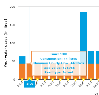

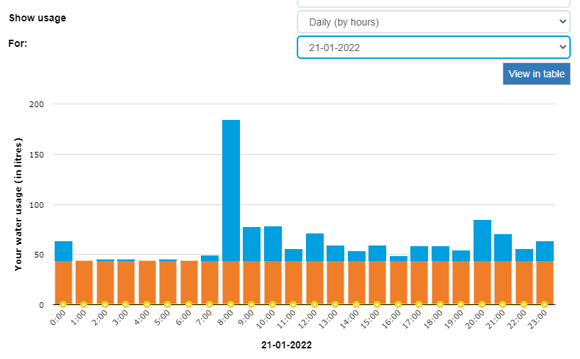

Problem: Our smart meter is indicating that we currently use 44l per hour, even when we're away for the weekend, and even when it's 3am in the morning. The meter (a thames water sensus) is installed at the boundary of the property.
The usage increase started approx October 2021 and has been steadily getting worse and worse.

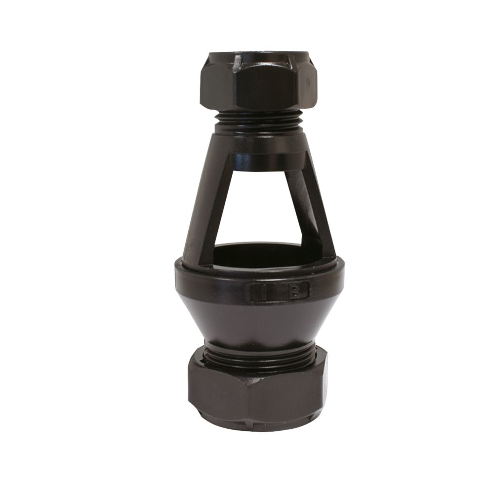

Q) Do either of the 'cylinder' or the underfloor heating have a 'waste pipe' and that could be continually leaking water? How would I check

It is not clear if this flow rate is evident when you think you have everything OFF.
Why is the 44L/H coloured brown in the chart? Is this perhaps a notional rate to pay for the supply itself? (dunno tbh)
That is an impossible amount of water usage or loss per hour. It makes your weekly consumption around 796525 x that of our weekly consumption. You simply cannot get much volume to flow through a domestic pipe and if it did, the whole neighbourhood would be under water. Either your meter is wrong or your reading of it.
The chart is from Thames water's website. As far as I can tell, the brown 44L/H is highlighted to indicate to the user the minimum hourly rate for the day.
I don't think it's the notional charge, though I'm going to go and check the tariff right now.
Cylinder does, as in the picture above.
The UFH, boiler and related items do not, any leak there would result in the pressure dropping to zero very quickly and the boiler would stop working.

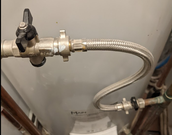

There is another possibility - someone has left the filling loop for the boiler open, and it's constantly filling and the water is being let out of the pressure relief valve, which may not be in an obvious place.
Check at or near the boiler for a silver braided hose with a valve on each end, both should be closed. Post a picture of what's there if unsure.
That's more like it. You suggested 44m3 per hour, in fact it is 44L per hour. 1000 times less. That is 12672L per week, or 12.672M3 compared to our 1.4M3 per week. Still a lot.

OK I just checked the bill. I can't see any indication of a 'notional charge' - aside from the flat 'service charge' which is minute in comparison.
The 228m3 indicates consumption.
Hi flameport,
Thanks so much for the reply.
The filling loop is closed if I read this correctly:
