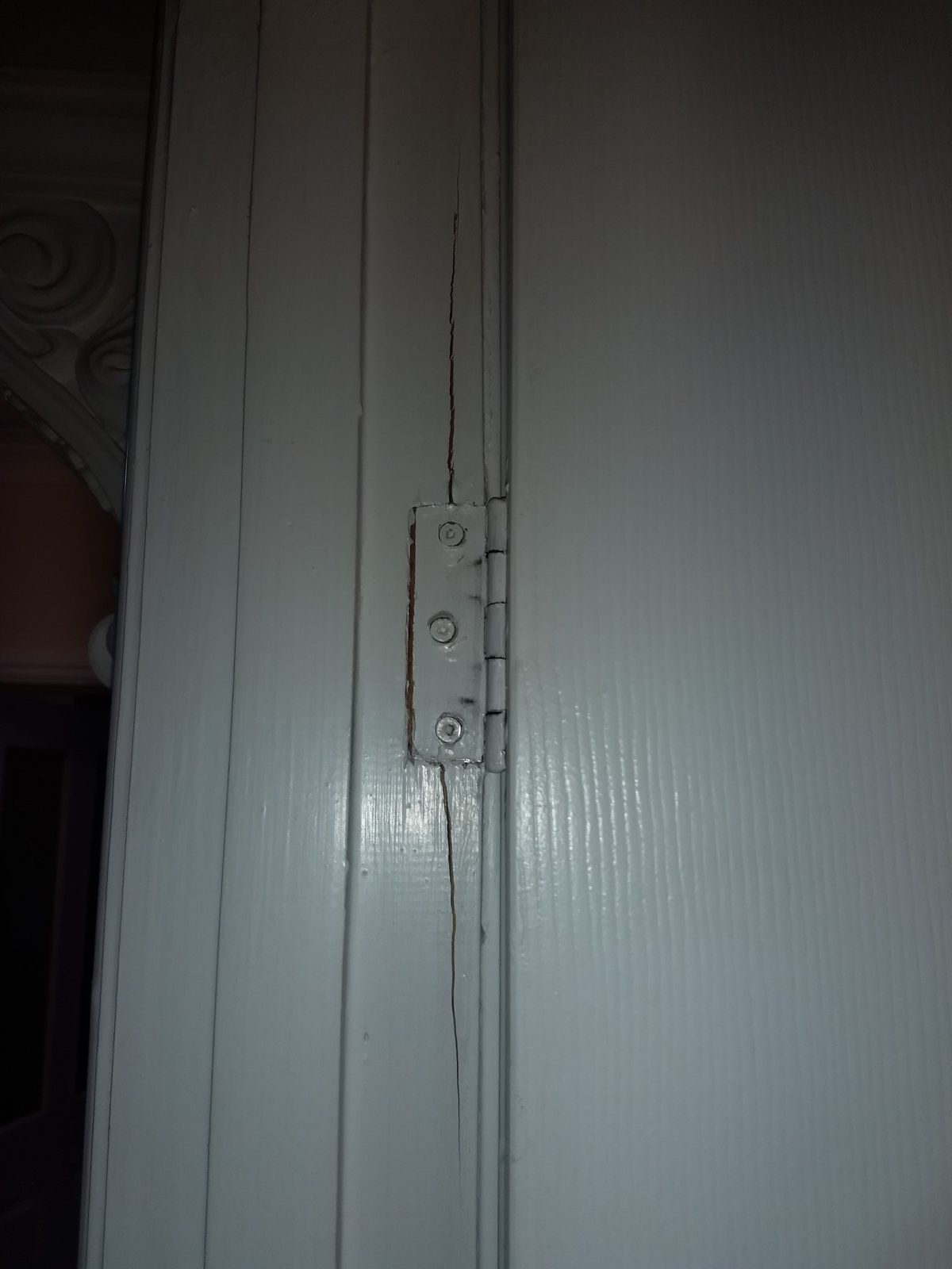

Hinge cracked on door ? replace
31 May 2019
Hey Im doing up this flat and the door wont close.
Further inspection reveals the hinge and wood is cracked.
What should i do?
thx

moggul, good evening.
What bit of the image is the door?
Is the wood with the crack toe door?
Ken
Door must be binding to split the frame. Remove and adjust . Glue and pin frame .
