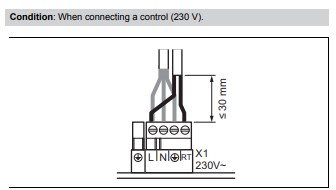

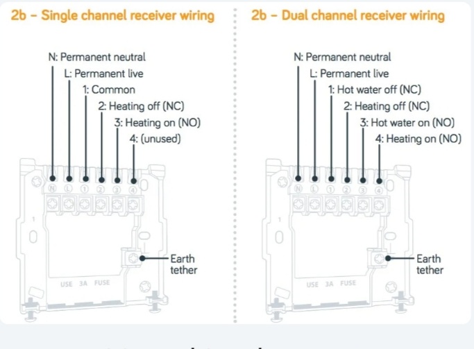

We have a standard boiler and a Hive 2.0 + Hub wired up. However, we are switching to a combi, will this still work or can it be easily adapted by the plumber; or are we having to buy a new one?
Not sure what you mean by a Hive 2.0, but if you mean you have a Dual Channel Hive presently controlling central heating and hot water, and you want to fit it to a combi and use it just to control the central heating, that can be done, it just means that the hot water channel of the Hive won't be doing anything.

Thanks, I mean the Hive 2.0 thermostat as opposed to the original V1 model.
The OP has a dual channel Hive - not so good on a boiler that has an ELV thermostat circuit...
Ah, but I have inside information from another thread from @gerbils ;)
Vaillant ecoFIT pure 35kW
And whilst is does have a 24v control option, it also has.....

Hmm Hive themselves said it's no problem.... is it best to buy a new one?

Not a problem for you, as @stem has pointed out - your boiler has a 24V control circuit and a mains voltage one.
Just ensure your installer knows which one to connect to :)

No problem technically, but personally I would probably buy a new one because the Dual Channel Hive, will have hot water control functions that won't do anything, and that would bug me. But if you don't mind that........
