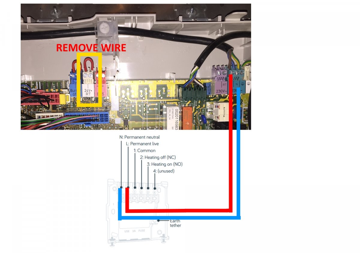

Hi
I read multiple sites and still not clear on the wiring for the Hive 2 system.
Attached is diagram, can anyone assist where (1)common and (3)Heating On should go.
Any help appreciated
Put a link between the live and the common on the Hive receiver back plate. The heating ON goes in the purple connector next to the mains connection in the boiler. (i think it says RT).
Hope that helps.
Hope that helps.
Thanks, so if i'm correct it should look like the attached?
The Heating ON needs to go in the right hand side off the purple connector (closest to the live wire ). The link is correct. (just use a small piece of wire to link common and Live).
