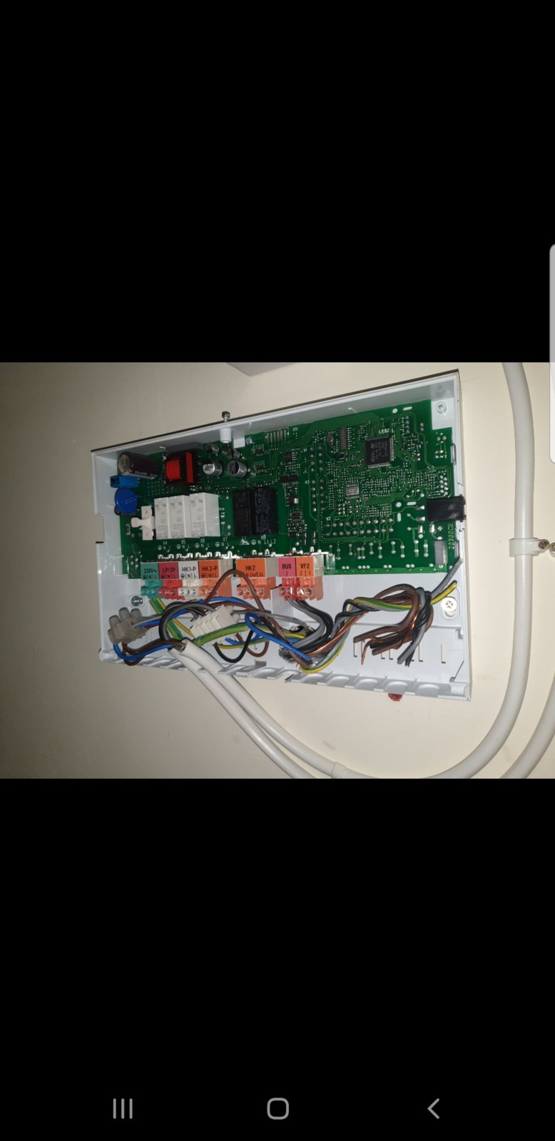

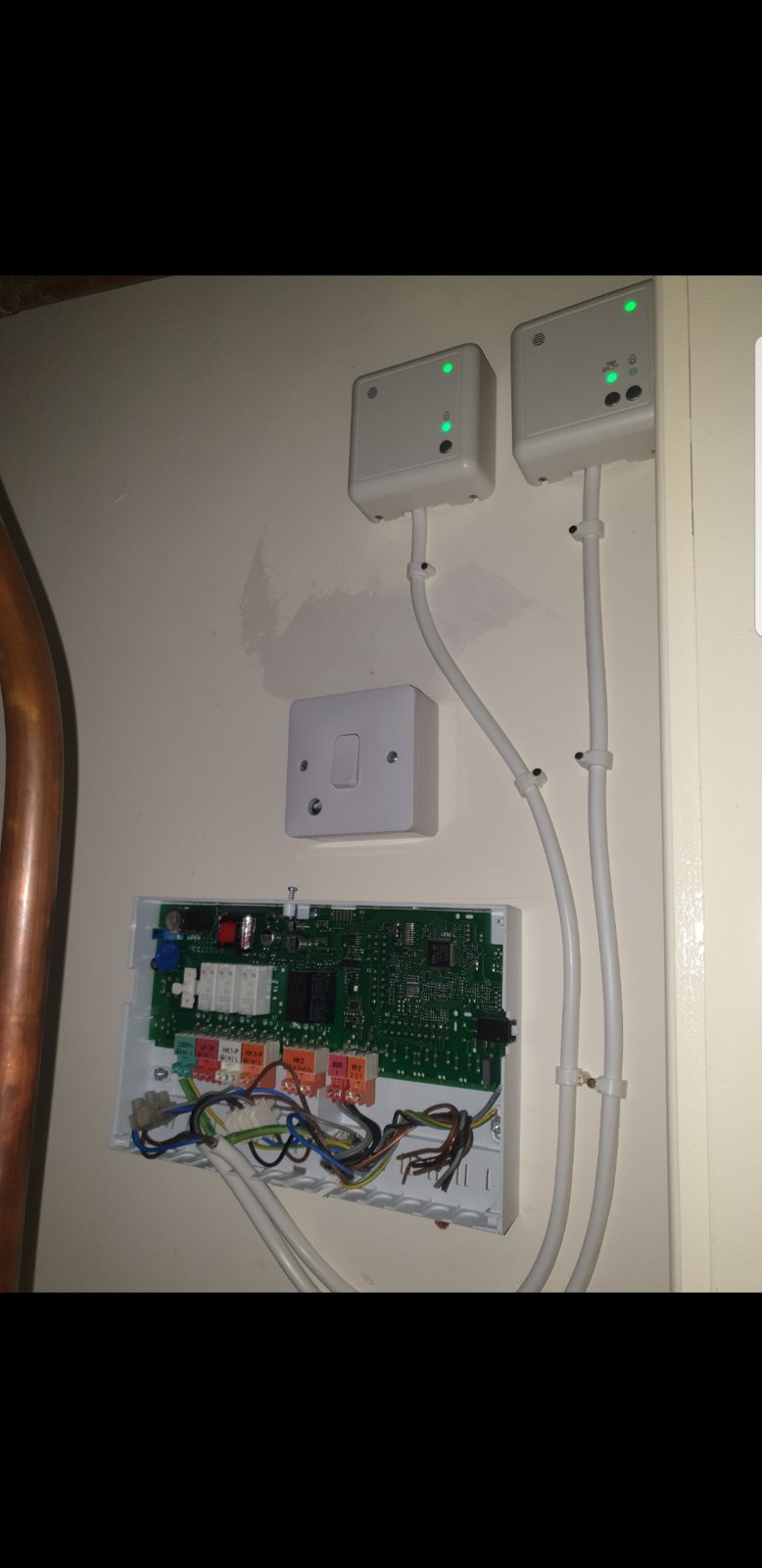

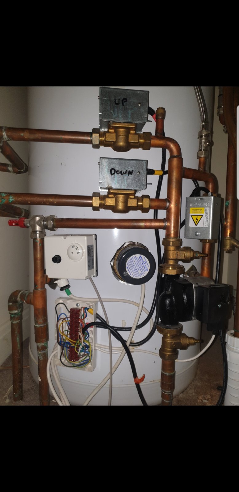

British gas have installed hive today for me and the lights are coming on on the hive receivers when I turn them on via the thermostats/app but the boiler is not kicking in. The engineer has installed the receivers upstairs next to my hot water cylinder. the Honeywell valves that direct the water are opening up but the receivers are not talking to the boiler to heat the water up. However if I turn my old vaillant wireless thermostat up the boiler then kicks in and heats the water giving me heating and hot water but when I turn the hive off the boiler is then overheating as the hot water has no where to go. I have attached photos of my boiler/hive set up/water cylinder. Where do I go from here? Should I get british gas to come back out or is it something simple like a link needs removing or putting in?
OK so British Gas has fitted a on/off system which can only use 230 volt control to a boiler which has ebus and 24 volt control, however there is a 230 volt option, so although may not be the most suited system it should work, and clearly they should have not left the covers off the control panels, and can't work out why with Hive there is any connection to the bus, but any faults are down to British Gas to correct, what is the point getting some one to fit it, then fix it your self, they will have to arrange a hotel until fixed.
If you want you could try moving the bleed leavers on the motorised valves to bleed position and see if that will temp give you heat, but even if it only needs a simple link then it's down to British Gas to fix it.
Ok will be straight on to british gas in the morning. It looks like the engineer has taken the power directly from the fuse spur above the ebus control panel so I'm guessing the ebus panel has been made redundant. As for the control panel covers I took them off to take photos to post here. Thanks for shedding some light hopefully british gas will sort it out.
OK so British Gas has fitted a on/off system which can only use 230 volt control to a boiler which has ebus and 24 volt control........,

I would be also be asking questions about that too. Why has the old room thermostat been left wired in, and not decommissioned properly?
Also, where is the cable strain relief here. These cables should be clamped, secured, or enclosed in trunking. An accidental pull on them and you could have a problem.
I can't believe a 'professional' has done this. What a bodge!
This is awful on so many levels, really poor quality installation work and likely a downgrade on nn what you had before
Hopefully you get it sorted, unfortunately British Gas did a worse job than that when they 'installed' our Hive system! They left the room thermostats neutral and earth connected in the wiring centre and left the other ends floating in the back box. Took a few nuisance RCD trips before we worked that one out.

The pictures however show up and down on the motorised valves, and there seems to be two Hive bases, which makes on think the old motorised valves are still used, this seems in most cases daft, OK my house where the flat under the house is rarely used, having a motorised valve to turn off flat makes some sense, but in the main house we have 11 radiators, want the toilet and bathroom always heated, at 8 am I want the temperature to raise in two bedrooms and kitchen, but 10 am I want the living room heated and bedroom temperature can reduce, by 3 pm want dinning room heated, by 8 pm the dinning room and kitchen can reduce heat, by 9 pm the bedrooms are heated again, by 11 pm the living room is allowed to cool, the craft room and office we press the button to change from eco to comfort when we want to use them, I am sure most homes are the same, two zones are not enough for the modern house, you want more like 8 zones, so zone valves are out, and programmable TRV heads are in. And the whole idea of Hive is using Hive TRV heads they talk to the wall thermostat.
