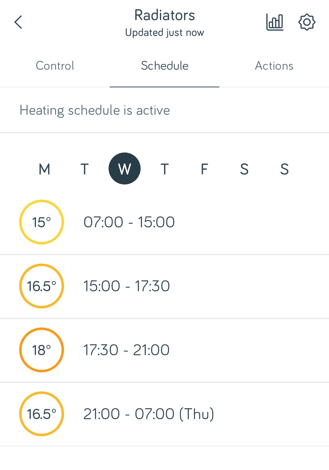

This may not be the right place to post this but would anyone advise the settings to set the Hive heating too?
What I mean most economical and keep the house warm - don't want to set 18°C all day when don't need to if that's what I do.
Just give me an idea of the temps to set.

My current setting each day and thermostat sits in kitchen area.
I would personally start by dialling your night time temp down to whatever you can get away with before the lady of the house complains.

I presume you don't have Hive TRV heads? So the unoccupied spaces at night are still being heated as much as the bedrooms.
Your oil boiler isn't capable of modulating so it will cycle to maintain that night temp which is the least efficient way to run it.
Because my home is a modern well insulated building, I leave the overnight setback temp at 13 degrees and don't get any complaints. Heating kicks in at 6am again for us, but again, our heating system warms the house very quickly compared to our last place.
There's so many variables and it will all be trial and error to find what works for you.
You can reduce the heating demand by 0.5 degree at a time or by reducing CH time by 15 minutes and keep testing that for a few days and see how you go.

Thanks @Ricardov12 good advice I have set the nighttime heating back to 13.5 see how that goes.
