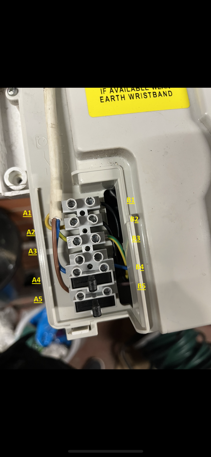

I'm wanting to install the hive system on my boiler, but there's something I'm unsure with. I found the following post which has the exact setup as mine but I'm not sure on the next step.
You can also see the relevant manual pages on the other post: Wiring Hive to Main Combi | DIYnot Forums
See attached photo, which I took of my terminal block and numbered A1-5 and B1-5.
So my understanding is that the black and grey wire from a 5 core cable would go from where the loop cable is (A1, A2) to points 1 and 3 on the hive receivers.
I'm unsure where I would put the live and neutral of the same cable into the terminal box. I'm thinking using the points B4 & B5 and keeping the wires that are already there? Or do I connect from the fused spur like the manual diagram (but would require a separate cable).
Thanks in advance!
