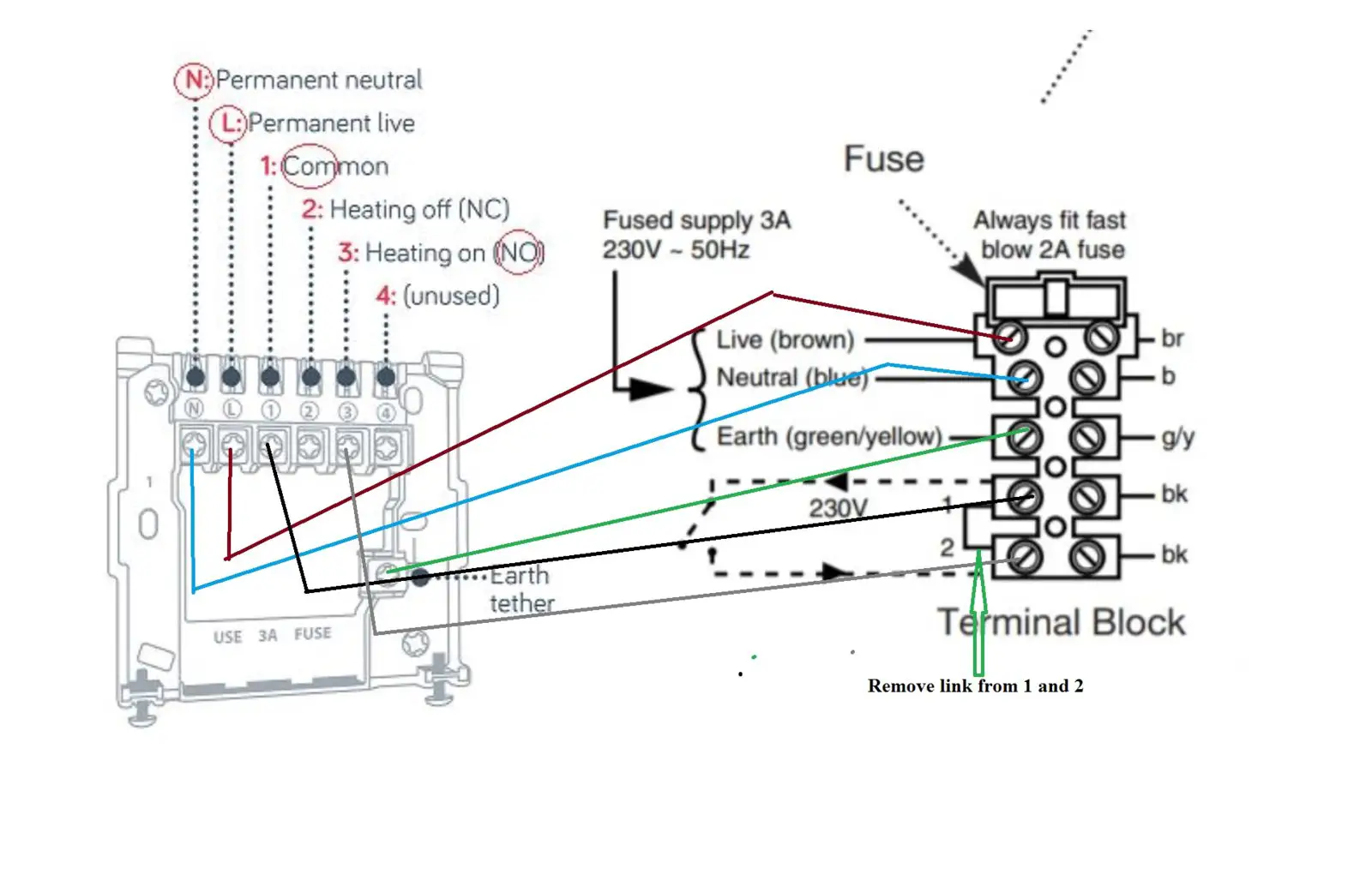

Hi guys,
Im looking to replace my Salus wireless stat on my Main Eco 30 Elite with a hive system. Ive been looking around and wanted some clarity on my plan here. So ive got a Salus RT501RF(TX) stat and on the boiler its a RXBC605 reciever.
Looking around on here and online am I right in thinking I can set the reciever on the boiler to manual so always on basically:
And then wire the hive in line with the current on by copying this diagram:
I am also presuming from the above the link from 1 and 2 will already be off on mine as I have a stat already?
Thanks in advance guys, I just wanted to get my head around it before I take a look inside as this seems to simple to me! Finally will the current stat be wired on the same side as the hive so i would have 3 wires in one side or would that be on the opposite side of the terminal block?

It seems too simple to me as well. I'm no expert, but I've a feeling something is missing. Where are the wires you want to join the Hive to situated? Isn't the current stat wireless?
Yea the current stat is battery operated and wireless to that reciever thats on the boiler already.
It looks about right to me! :)

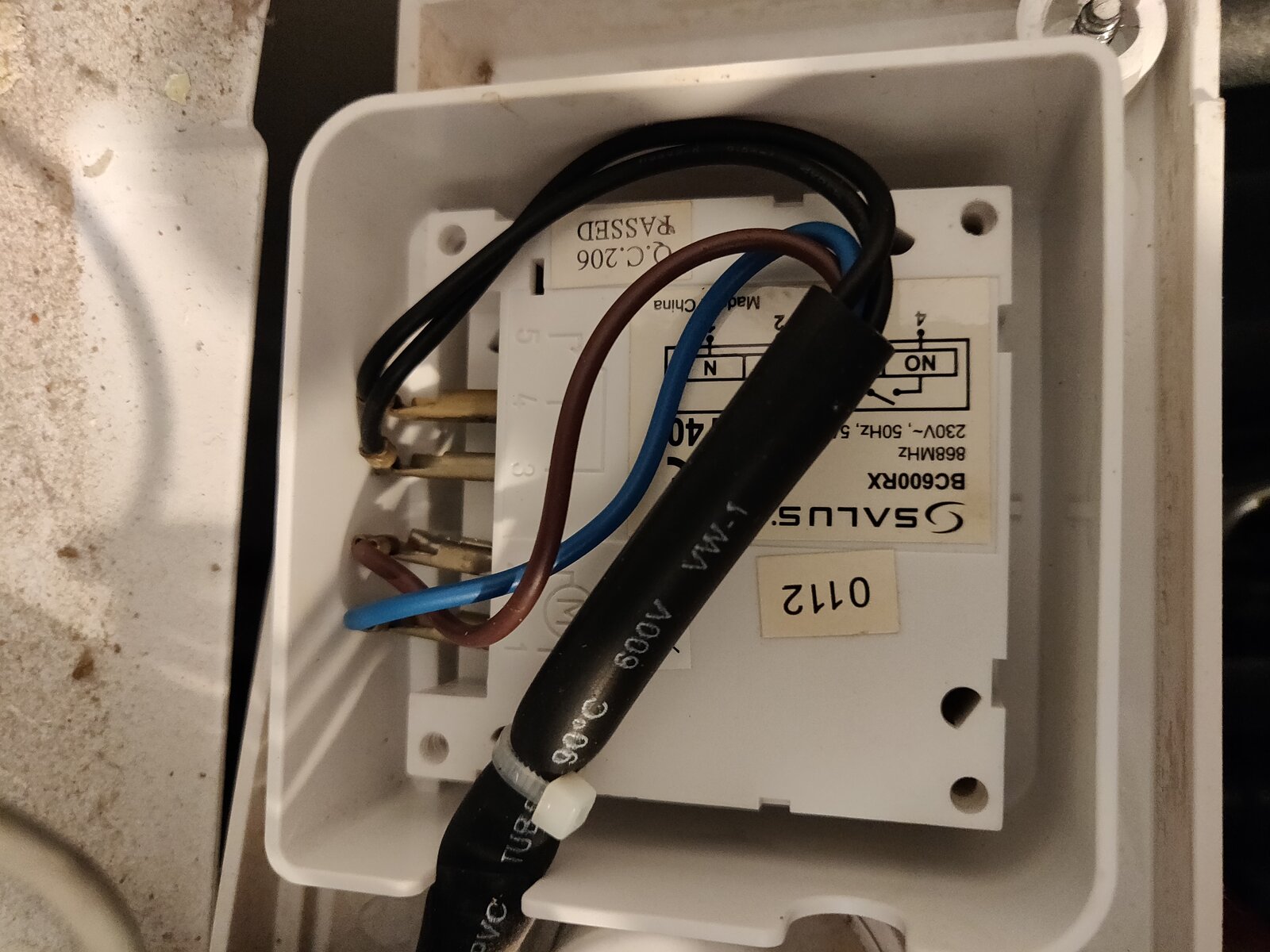

We've been asked a few questions about the built-in Salus receivers before.
Whether the previous posters have understood our advice or not; it has been reported that switching the receiver to manual, doesn't allow a new thermostat to work.
Bridging together the wires connected to terminals 3 and 4 on the Salus, would be the best solution. Even if switching to manual worked, the salus would be constantly holding a relay on, causing heat and consuming power when it needn't even be there.

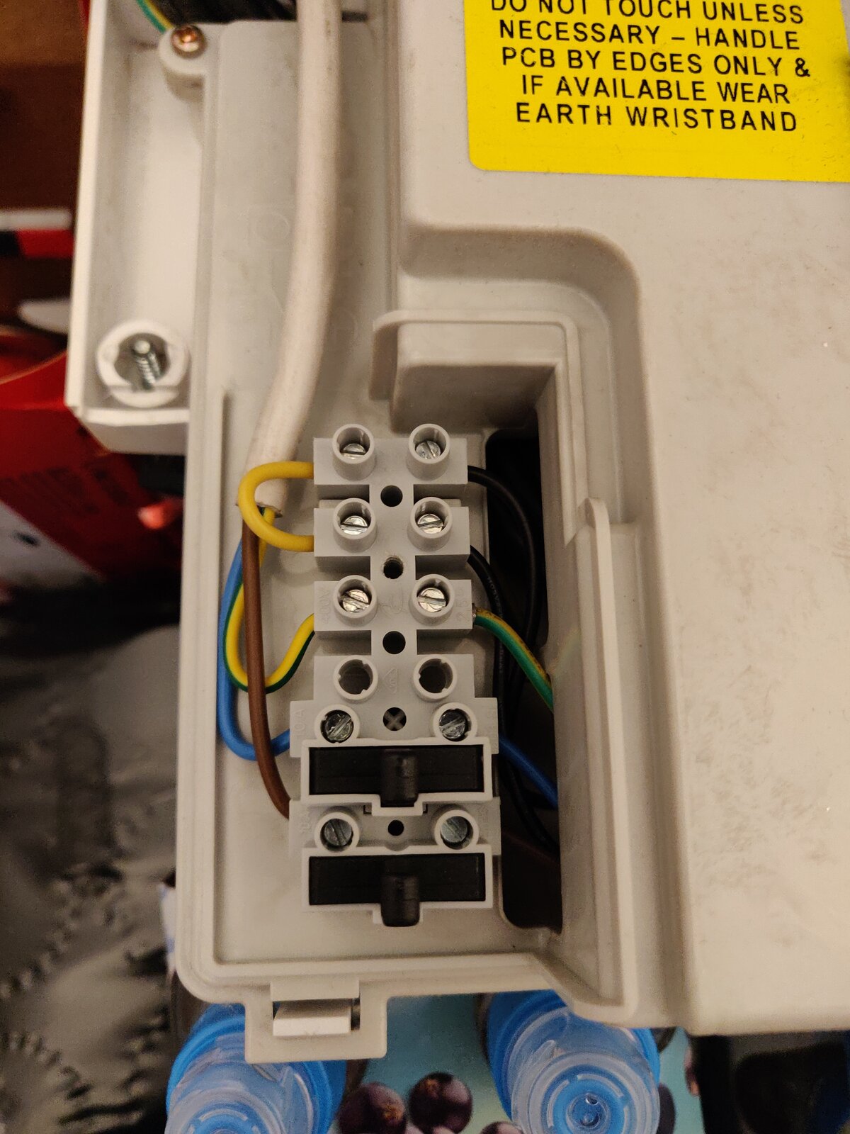

The link will probably still be there and will need to be removed, because the Salus receiver is usually connected internally to the boiler.

This is what we have on the boiler I checked this morning so if I get a terminal and link 3 and 4 together on that internal salus and leave it as it is basically bybasses it?
Typical that the salus has just started clicking and buzzing after I removed it, time to change it I think.
So to confirm leave the live and neutral on the salus reciever then just connect 3 and 4 together wen though its now broken this will still work right?
Yes, that's right.
PS> shouldnt the yellow link wire on mine already be removed as I have an external stat?

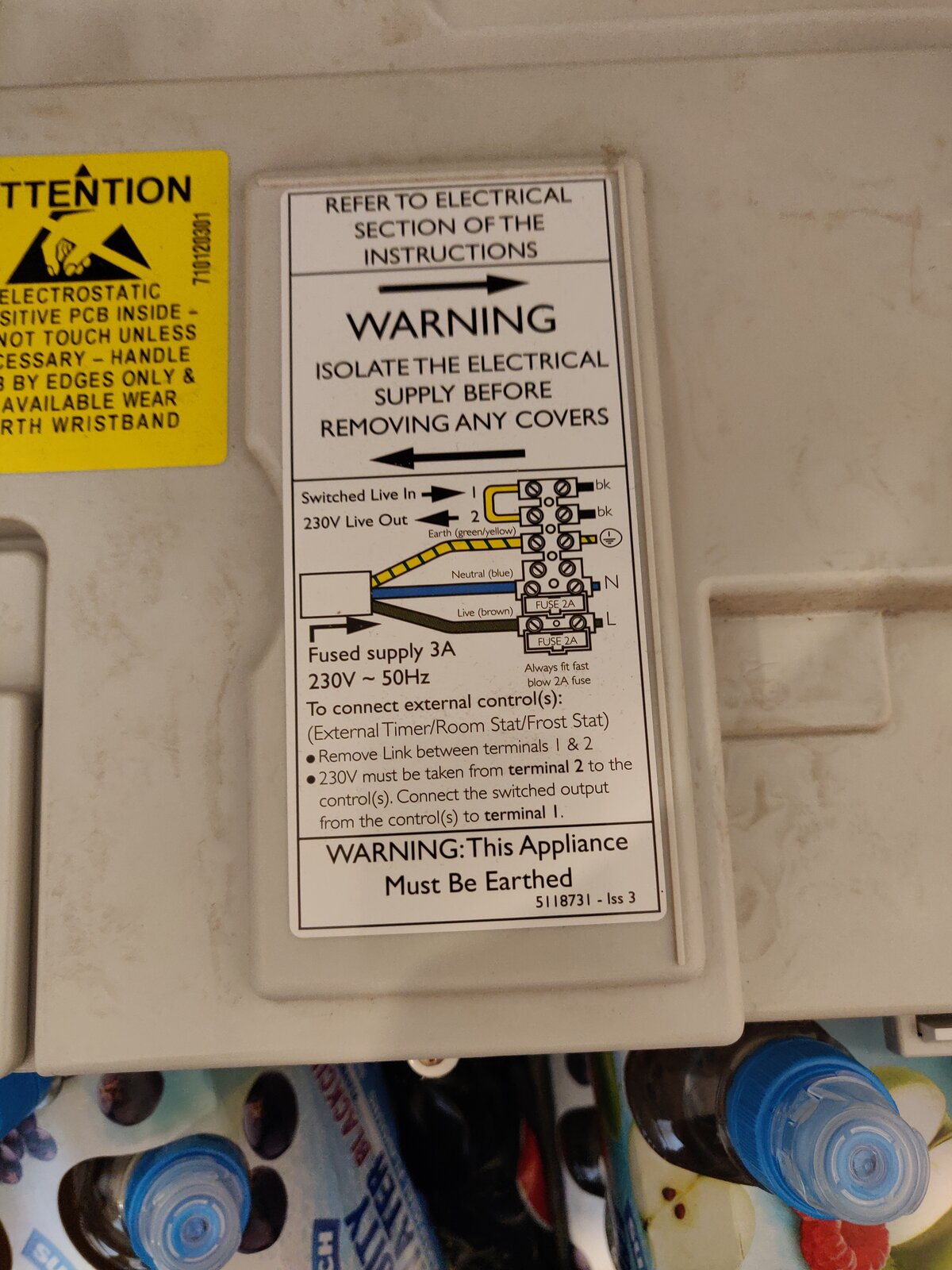

Also on the warning sticker it says 230v should be taking from block 2. From the wiring diagram above for the Common is howing to connect to block 1 is this not the 230v feed?
It's the manufactures being cautious. If the power feed is taken from block 2, the feed is protected by the boilers internal fuse. If the fuse blows and the boiler dies, the thermostat will also be dead.
However the risks are not hugely higher, if wiring directly to block 1.
Thank you so pretty much all I need to do is:
1. Wire the hive in as per the original diagram I posted.
2. Remove the yellow link wire.
3. Link 3 and 4 together at the old salus reciever end.
And im good to go?
