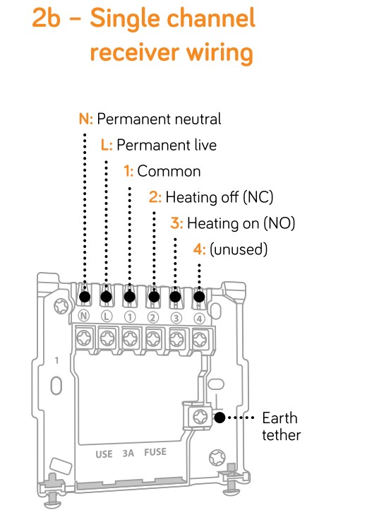

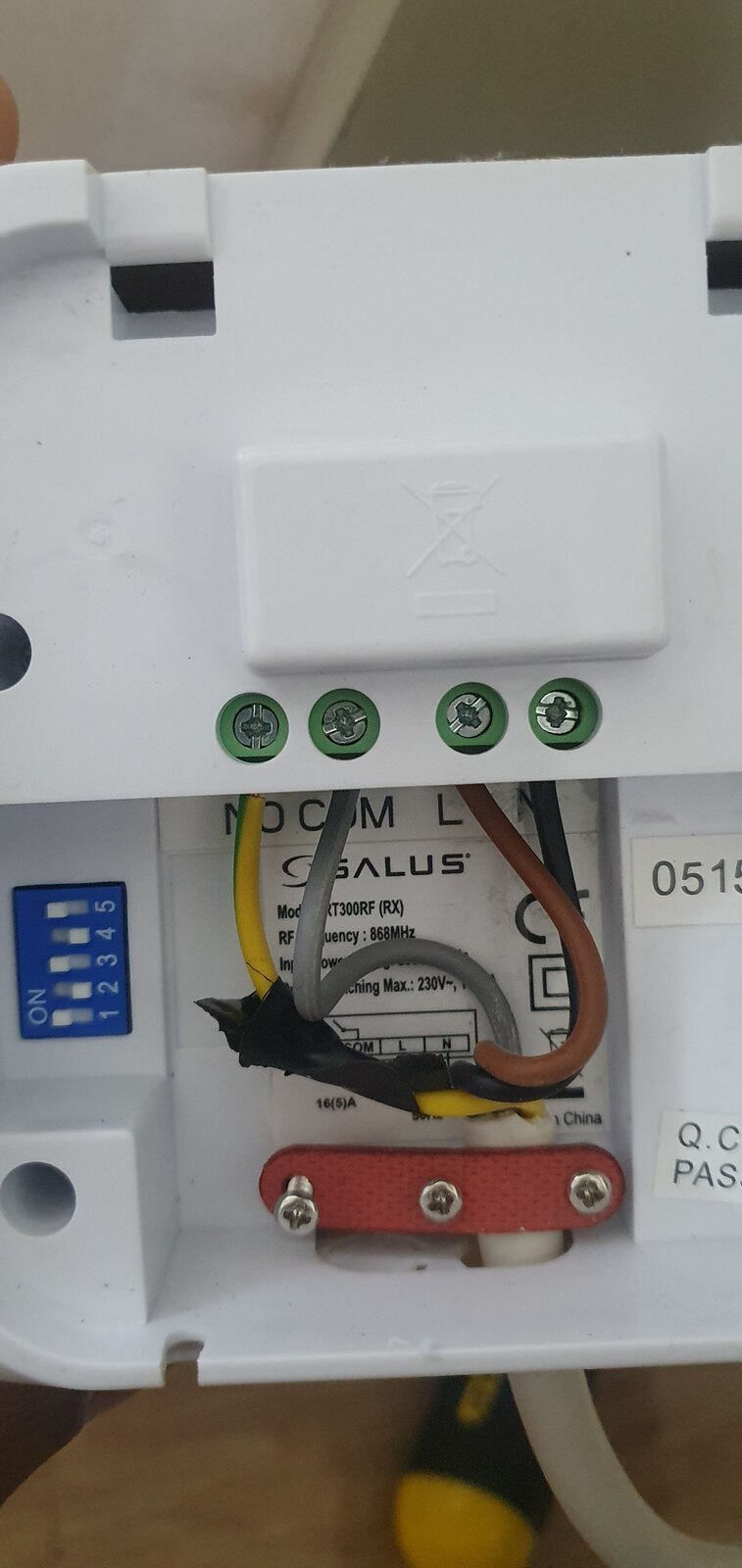

I have a Baxi combi elite 30 boiler and looking to replace with a Hive.
Attached the current wiring.
Am I correct in saying from Salus to Hive:
NO = 3 on hive
COM = 1 on hive
L = L on hive
N = N on hive
Nothing goes into the earth tether on the hive?
Thank you!

If you’re going to use that green/yellow as a switch live, best practice is to brown sleeve , or wrap with brown tape.
