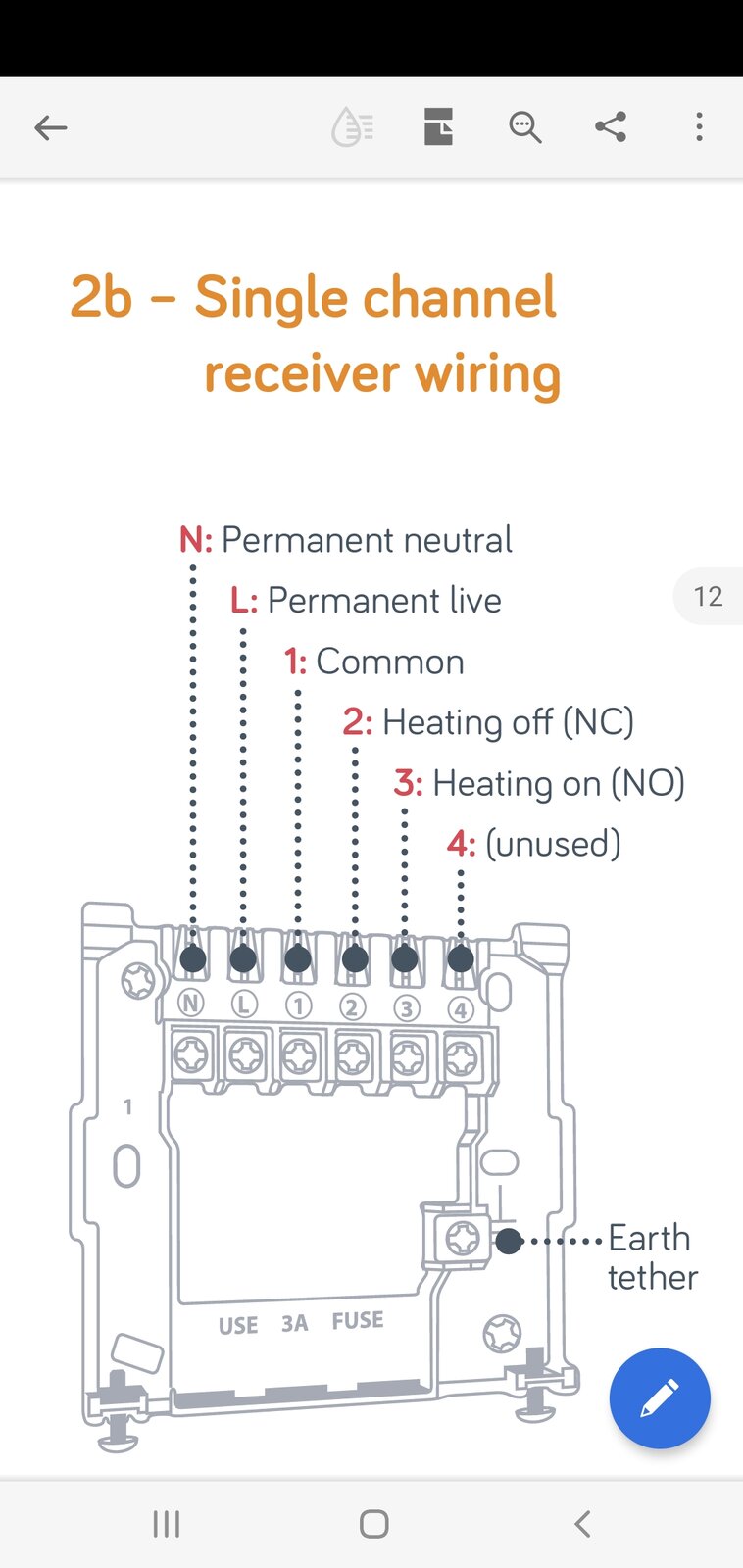

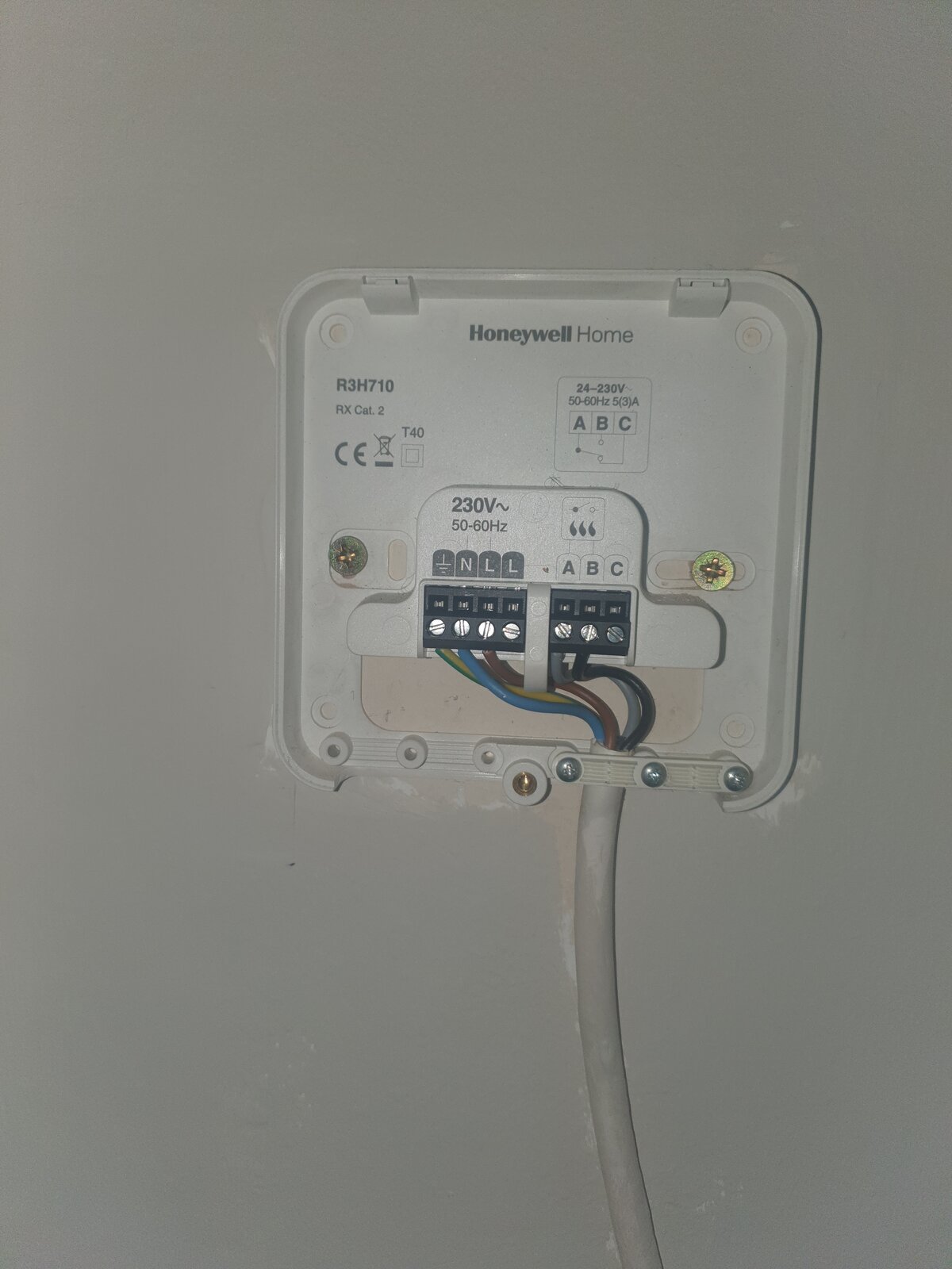

Hi all, could kindly do with some help. I am changing my honeywell thermostat to a hive one. I have attached a photo with the current wiring (honeywell) connected to my baxi combi boiler.
Am I right In thinking
N on honeywell goes to N on hive
L on honeywell goes to L on hive
Earth goes to earth on earth on hive
A on honeywell goes to 3 on hive
B on honeywell goes to 2 on hive
Any help would be appreciated
Kind regards Amir
