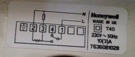

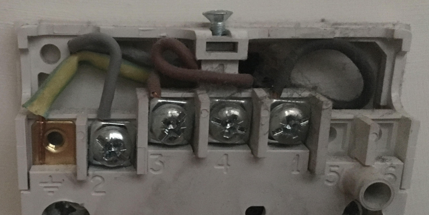

Hi, I have a Vaillant Ecomax boiler and Honeywell T40 Thermostat. I am hoping to wire the hive receiver using the existing wires from behind the thermostat. I've attached pictures of the existing wiring and would appreciate advice on how these wires should be connected to the Hive receiver, particularly the brown wire, which I believe is 'switch live'. This is what I've hopefully picked up from an internet search:
Yellow and Green -> Hive earth
Light Grey (Honeywell position 2) -> Hive N
Dark Grey (Honeywell position 1) -> Hive L
Brown (Honeywell position 3) -> Hive ?3
?also connect Hive 1 and L
I've tried calling Hive technical support, who transfer me to British Gas, who then send me back to Hive technical support so I'm unfortunately not making much process. I've attached pictures of the existing setup and wiring guides

Thank you. For the L to 1 connection, would this just be a jumper wire? Don't have much experience with this sorry (I paid for installation but my appointment has been scheduled multiple times by BG, now into Feb, and would like to get it going over winter)!
BW,
Niall
Do you have an existing time clock or programmer either separate or on board the boiler ?
That is a good point. Often a time clock will turn off supply to thermostat, and you don't want that to happen, it will likely mess up the Hive unit, it does mess up Nest as the battery in the unit goes flat and until charged again it will not work.
my point exactly @ericmark if the OP is using a switched live as a permanent live the hive will suffer unless existing is set to permanently on
