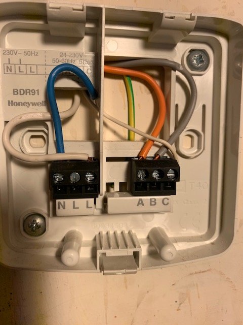

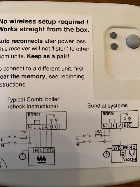

Hi,
I'm in the process of replacing my Honeywell wireless thermostat with a HIVE, however the existing receiver (Honeywell RM900) does not appear to be wired up according to the instructions leaving me a little confused. Could anyone confirm the wiring for the new HIVE receiver please? The receiver is connected to a Vaillant combi boiler.
RM900 Wiring Diagram
Existing Wiring
HIVE wiring diagram
My thoughts are:
Blue wire to N
Fat white wire to L (Permanent live)
A link wire from L to 1 (Common)
Orange to 2 (Heating off)
Grey to 3 (Heating On)
(The thin white wire isn't connected to anything and neither is the earth)
I'm just wanting to check that I'm correct before going ahead?
