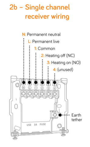

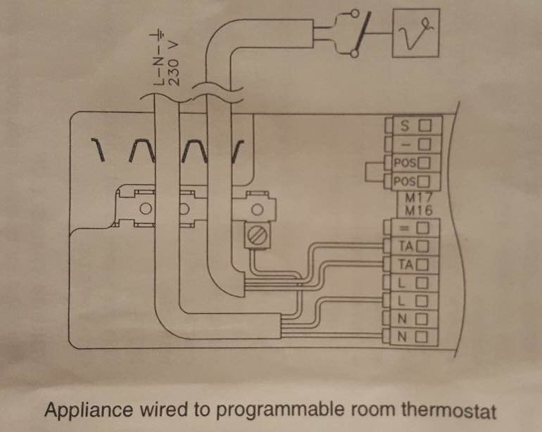

Hello
I have a vokèra syntesi e boiler picture attached and a hive receiver attached.
Which wires from the hive go to the receiver
I think its common and heating on and heating off from hive , to the 2 TP on boiler m16 panel?
and the live from hive to the boiler 3rd from botton L on the m16 panel?
and the n from hive to the bottom N on boiler m16 panel?
do i do connect earth if so where to on boiler m16 panel?
Regards Del

Use 5 core flex and connect as follows. Disconnect any existing thermostat or wire link from the 2 TA terminals.
The RC05 connects to the S and - terminals shown in the diagram, this is the remote modulating thermostat, the time clock connects to the TA terminals.
This report explains the modulation control and how standby losses reduce the efficiency of the boiler, with non modulating controls it is a trade off between reducing the hysteresis and suffering standby losses, by switching the boiler on/off with a slowly increasing off time as it reaches the set temperature the hysteresis is reduced, but the standby losses increase.
You can get wifi relays which can be used to switch the boiler on/off with a remote device like a phone, however you don't want to regulate the output by switching on/off, either use the RC05 if controlling whole house with single thermostat, or use the TRV, with the TRV you can get replacement heads which can be either local or remotely programmed and will by controlling the water flow control the modulated output of the boiler.
Of course the cheap Hive will work, but seems rather pointless fitting such a poor quality product, if doing the job would be better to do it proper to start with. The RC05 it seems costs around £90 so money wise is actually cheaper than Hive, but is actually designed for your boiler.
