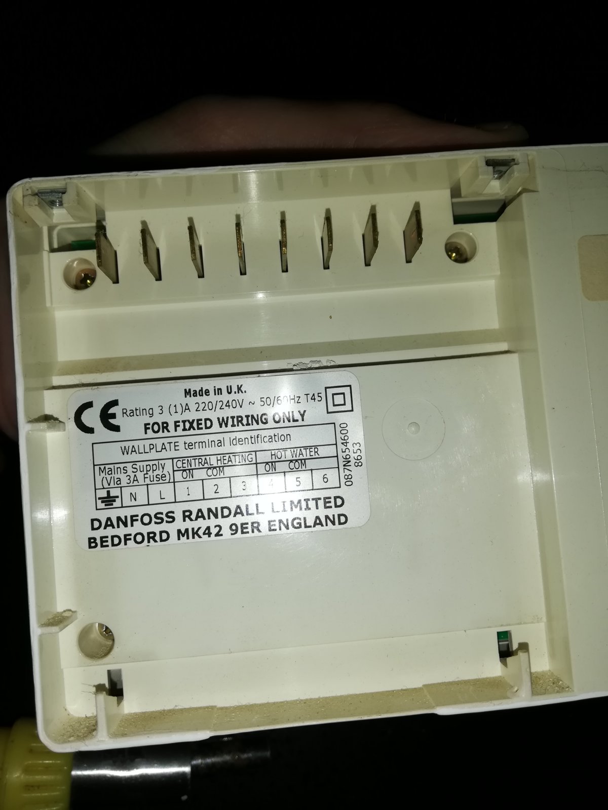

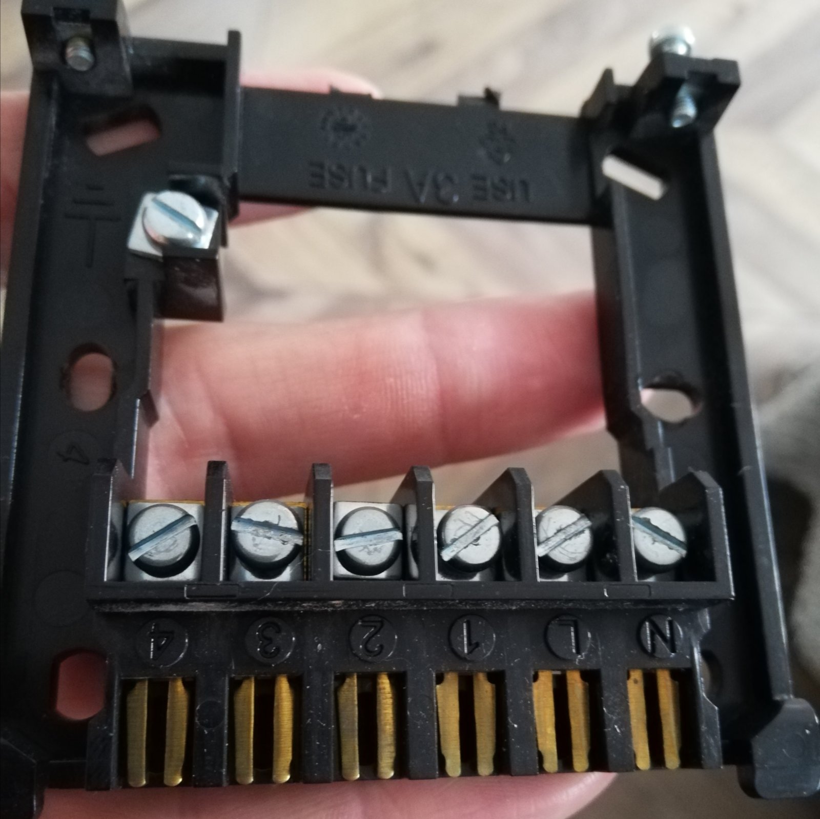

Hi,
I have moved to a house with a oil Combi boiler and a thermostat (Grant) which is on the wall in the kitchen.
Can I replace this with my hive receiver do you know? I'm a joiner to trade so very limited ability with things like this although I replaced my old one but it was like for like (a Drayton for the hive) and not an oil boiler I don't know if it's any different.
Is anyone able to help with the wiring. Obviously earth to earth, N to N, L to L but it's the other I am struggling with, what wire would got to what on the hive receiver (black plate in the pictures attached).
Thanks guys

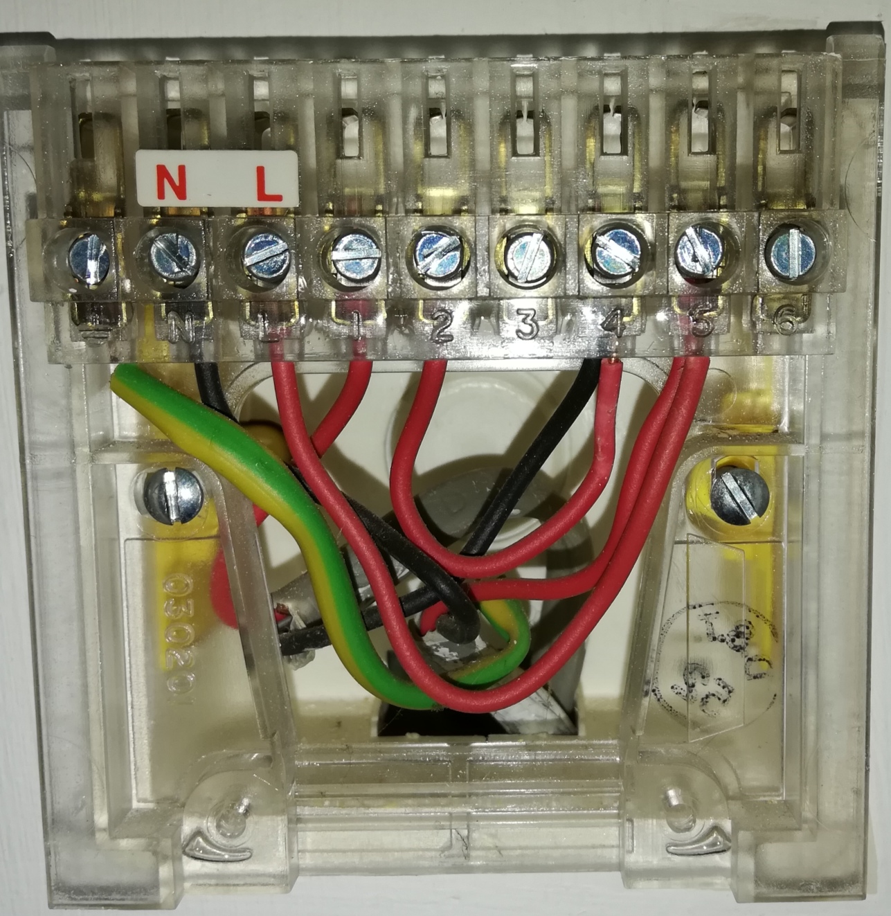

You say Grant thermostat and then show a picture of a Danfoss Randall unit, from pictures it seems the output from the Danfoss Randall unit is linked to Line so the Hive should replace it so going by picture centre picture diagram assuming it plugs into left picture socket, and right picture socket is Hive then.
Danfoss Randall 4 = Hive 3 hot water on.
But then it gets a bit odd, the original link 4 to 2 would mean you can only get central heating when the hot water is already on, so Danfoss Randall 1 could = Hive 4, heating on, but it may be wired that way because domestic hot water is thermo syphon and not sure how Hive will configure. It may be if Danfoss Randall 1 goes to Hive 4 the pump will run but the boiler will not.

First of all remove the links from the Danfoss (L&5) (2&4) Hive has all of the links made internally, so you can forget these.
You require the Dual Channel version of the Hive
You are then left with:
Black wire in Danfoss N = Hive N
Red wire in Danfoss 1 = Hive Heating on 4
Black wire in Danfoss 4 = Hive Hot Water on 3 (note: although this wire is black it is being used as a live)
Red wire in Danfoss 5 = Hive L
Your system is configured as one where the Heating can't be on without the hot water being on also, so you should set the Hive to Gravity Mode of operation.
I forgot to mention that because the Hive carries out the functions of a programmer and a room thermostat in one unit, the old wired (Grant) thermostat needs to be decommissioned to prevent it overriding the Hive. It can't simply be disconnected as this would leave the heating wiring 'open circuit' and it will not operate. To start with the system would work if the existing thermostat was left in place and set to its maximum setting, but ideally it should be decommissioned properly. If you need any help with this post a photo of the stat and its wiring.

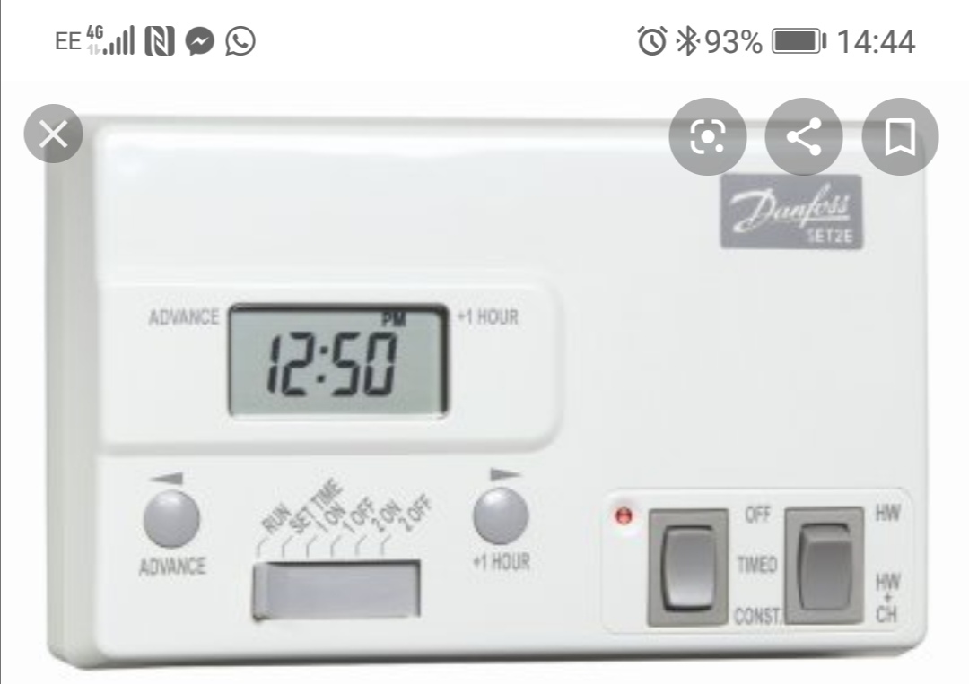

Thanks for all that information that's a massive help and yes you are not correct, the sticker on the front of my unit says grant however after checking online (see attached picture) that's the exact same unit as I have.
And yeah that's exactly right, the heating won't come on unless the hot water switch is on. I take it that means that it would need more work than simply wiring the faceplate up?

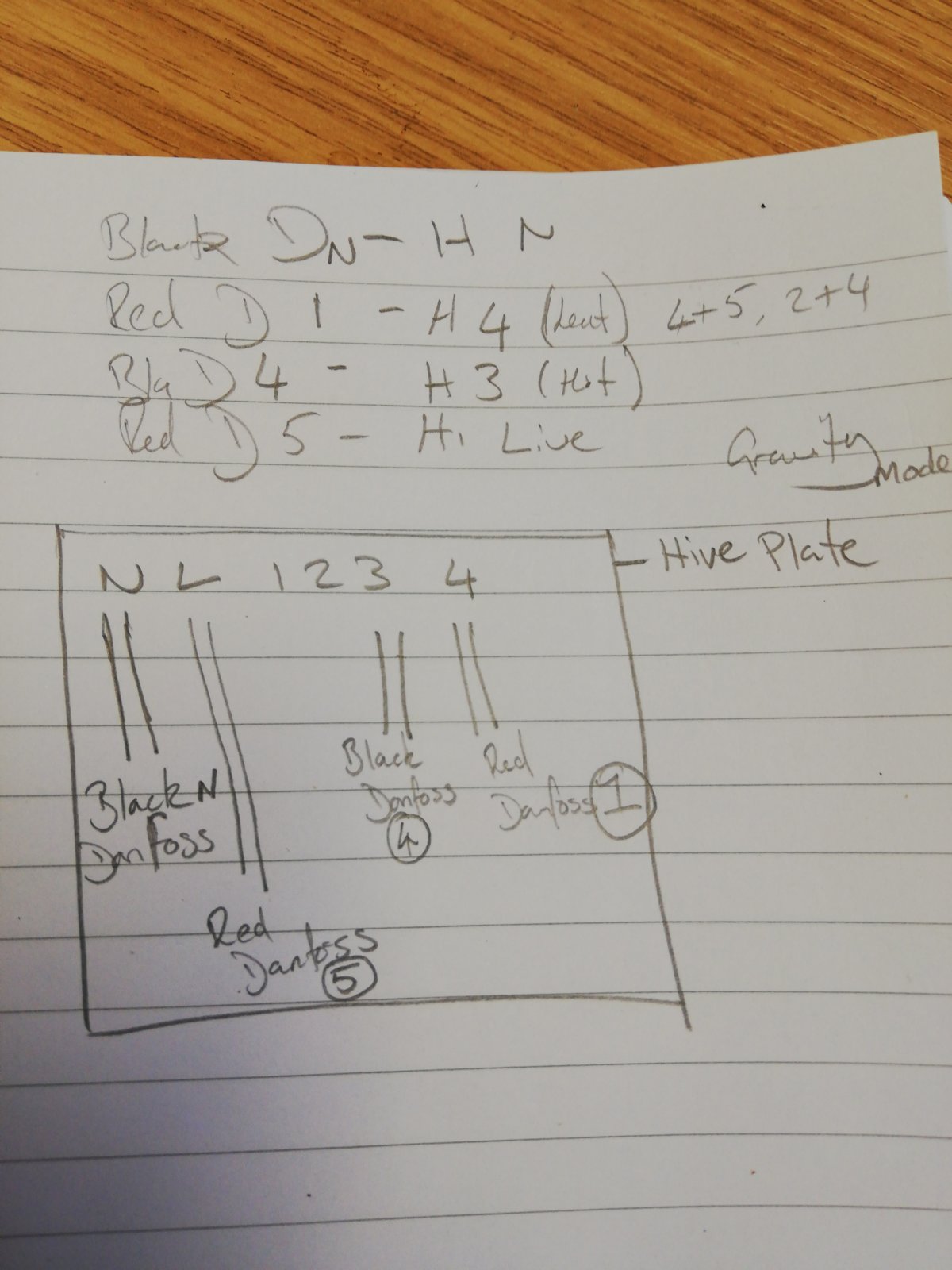

I have a very crude drawing attached I have done at work. Is decommissioning the old receiver a big job, in both of your professional opinions should I leave this one to someone who knows what they are doing?

Stem is far better at it than me, I am only an electrician, so take his advice over mine. Your drawing seems OK and from what Stem says you can configure Hive to work, so turn existing thermostat to max, and wire as you show, it should work.
However to remove old thermostat or alter how it works may need a lot more thought, I was advised not to fit motorised valves on the DHW and mine is reverse to yours, running CH will always heat hot water, but don't need to select hot water for central heating to run.

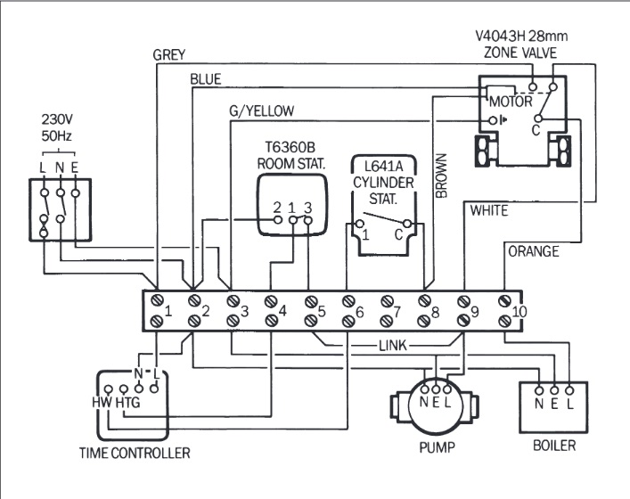

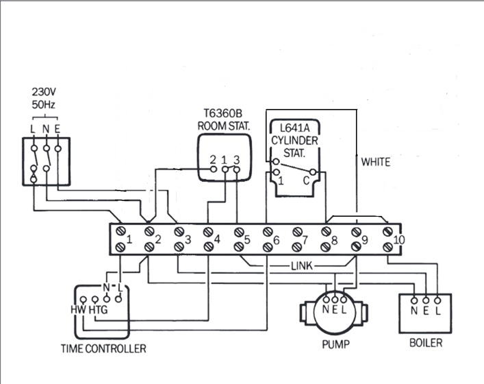

I have three C Plans one already shown, the next C-Plan_old.jpg uses the normally closed contact of the tank thermostat, and next C-Plan.jpg uses a motorised valve, not going to show how modified for my system, but just pointing out it changed through the years so depends on how old the installation is as to how wired, and that is if actually using a C plan.
So as Ryannf shows we are both saying it will work, assuming original thermostat turned to max. However to remove wiring to original thermostat we need to know more, are there motorised valves, or tank thermostats, and is there two or more pipes to motorised valve, pictures always good.
