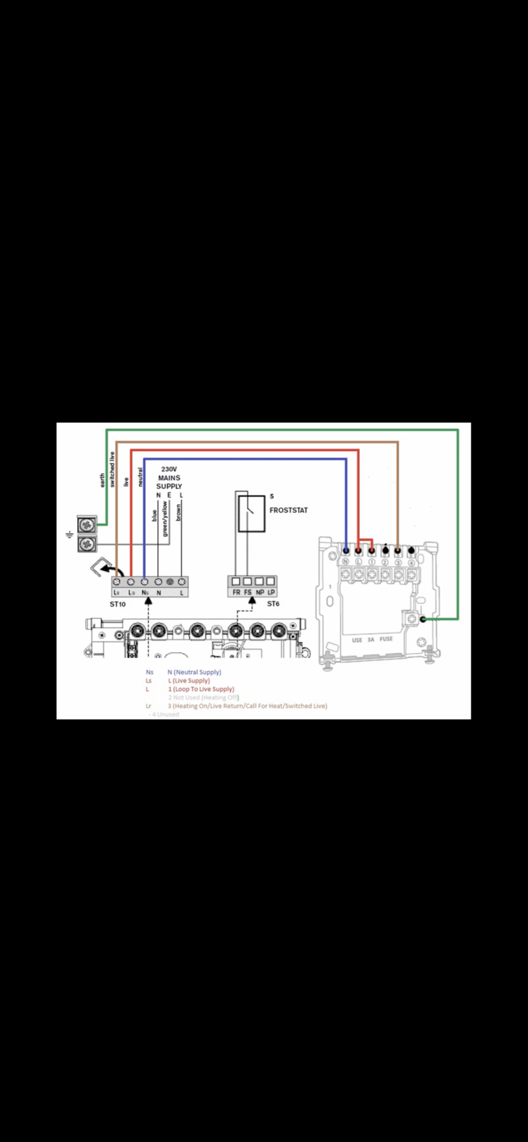

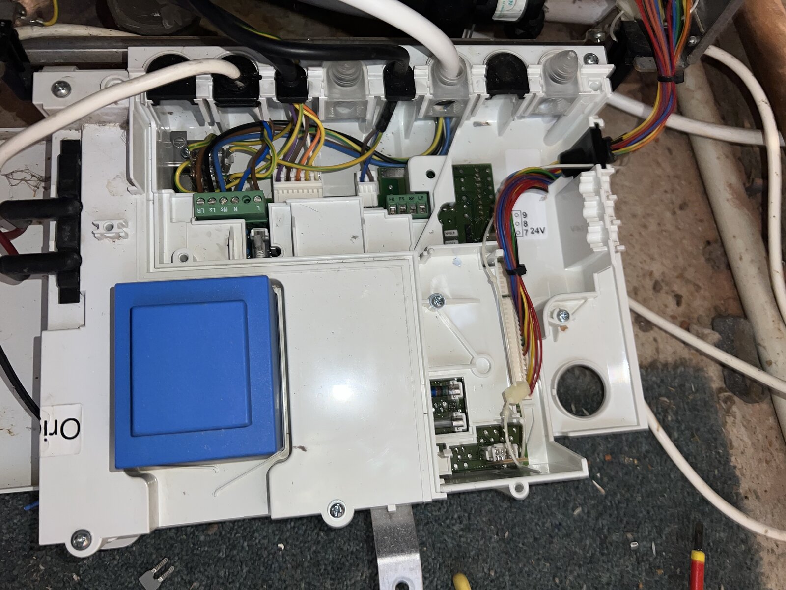

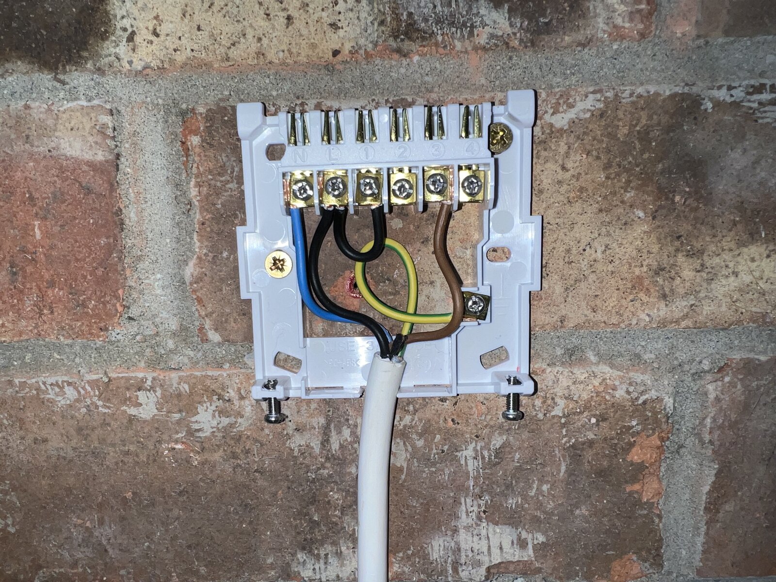

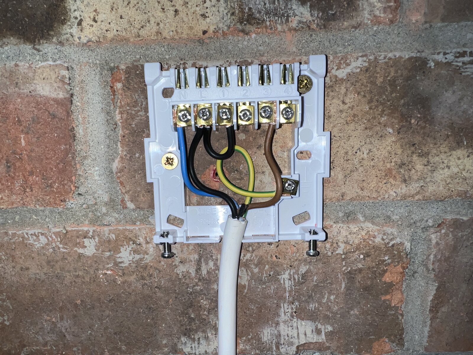

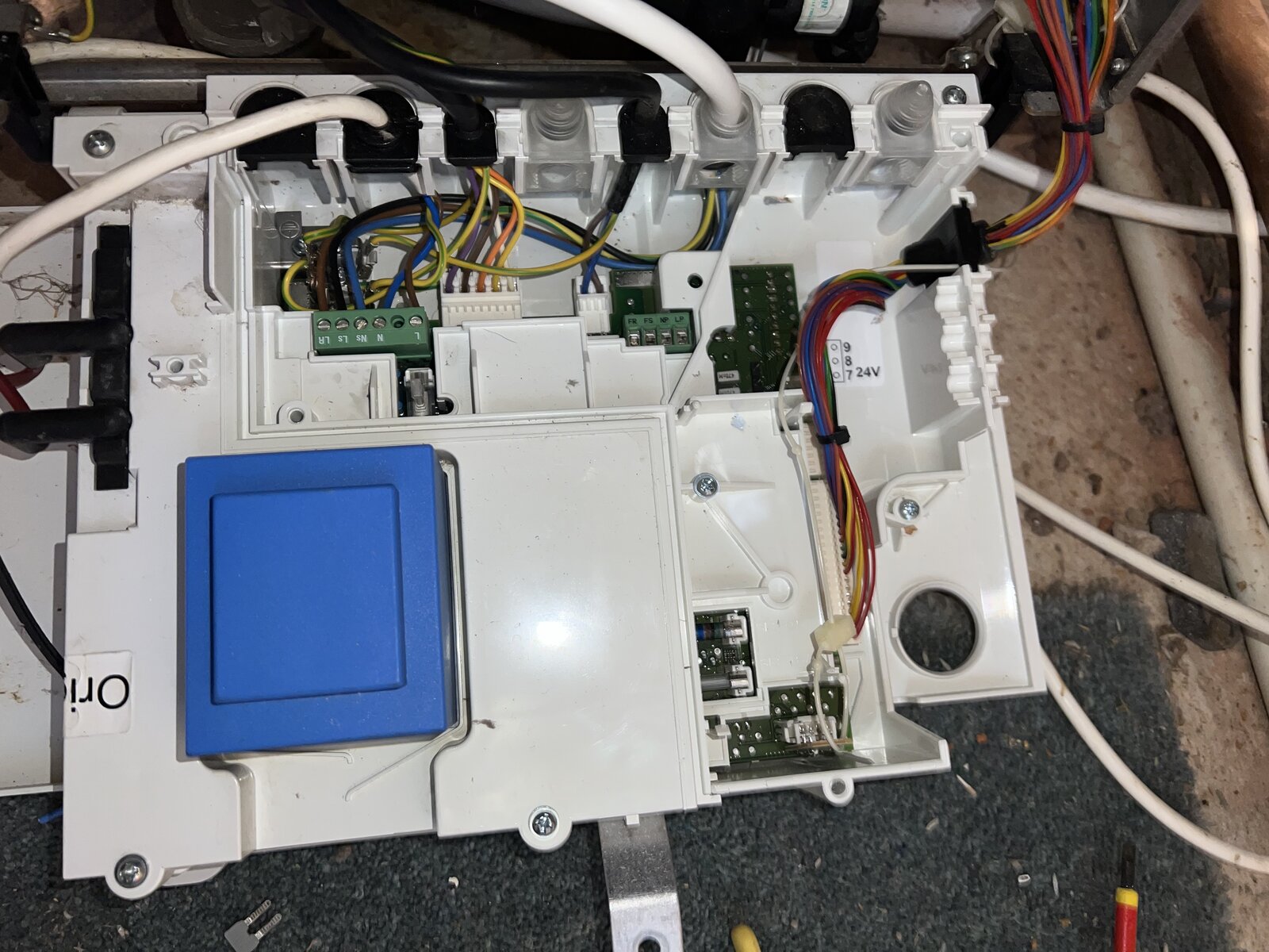

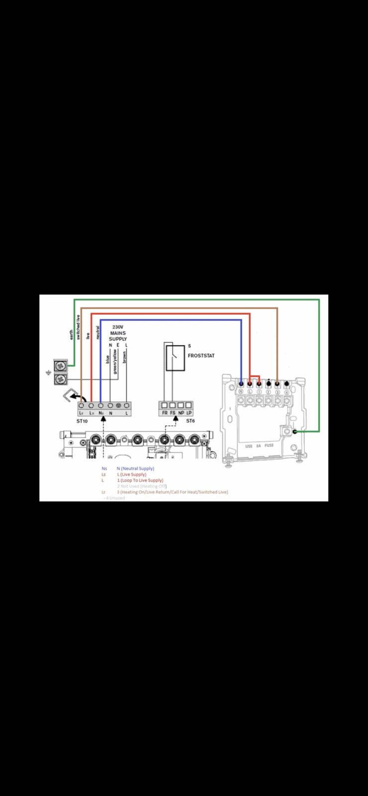

Good morning!
I have just installed my new Hive into my Worcester greenstar junior 28i boiler, I followed the attached diagram and attached is my wiring. Everything is green, connected and powered but when I press the heating button on the receiver it won’t fire the boiler? Won’t do it from the new hive thermostat either. Before this I had a Honeywell digistat so no hard wiring or receivers in the house I guess it communicated wireless to the boiler, do you think this could be affecting the hive?
Thanks in advance

I suspect it’s the digistat receiver, can you post a photo of the front of the boiler? Also make sure you get it checked for safety afterwards as the cover forms part of the combustion circuit.
That is not wired correctly you have wired the switched live from the boier into the permanent live on the hive , but as @CBW says post a pic of the boiler facia
