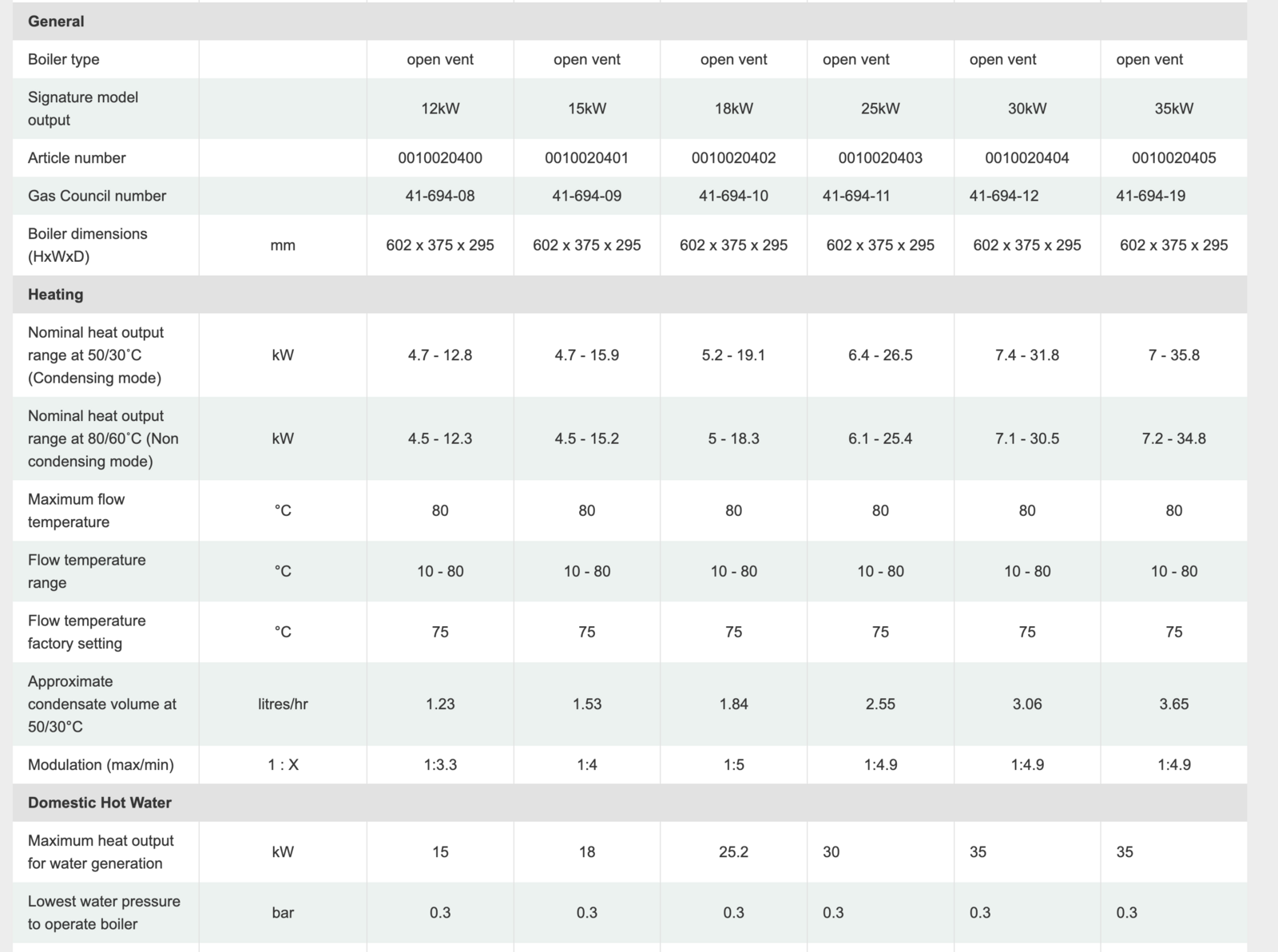

We are getting a Vaillant ecoFIT Pure 418 next week and hope that it will work with our existing Hive system. From their litterature the boiler will give a max 19kw of heating output and 25kw for domestic hot water. This confuses me as it's a heat-only boiler but if true it's perfect for us as our cylinder has a max input of 24kw thus boosting our recovery time by 7 mins.
However I am unsure how this works, I assume when you call for hot water it kicks in at a higher power; but will this work with Hive I wonder or will I need Vaillant's own smart hub?

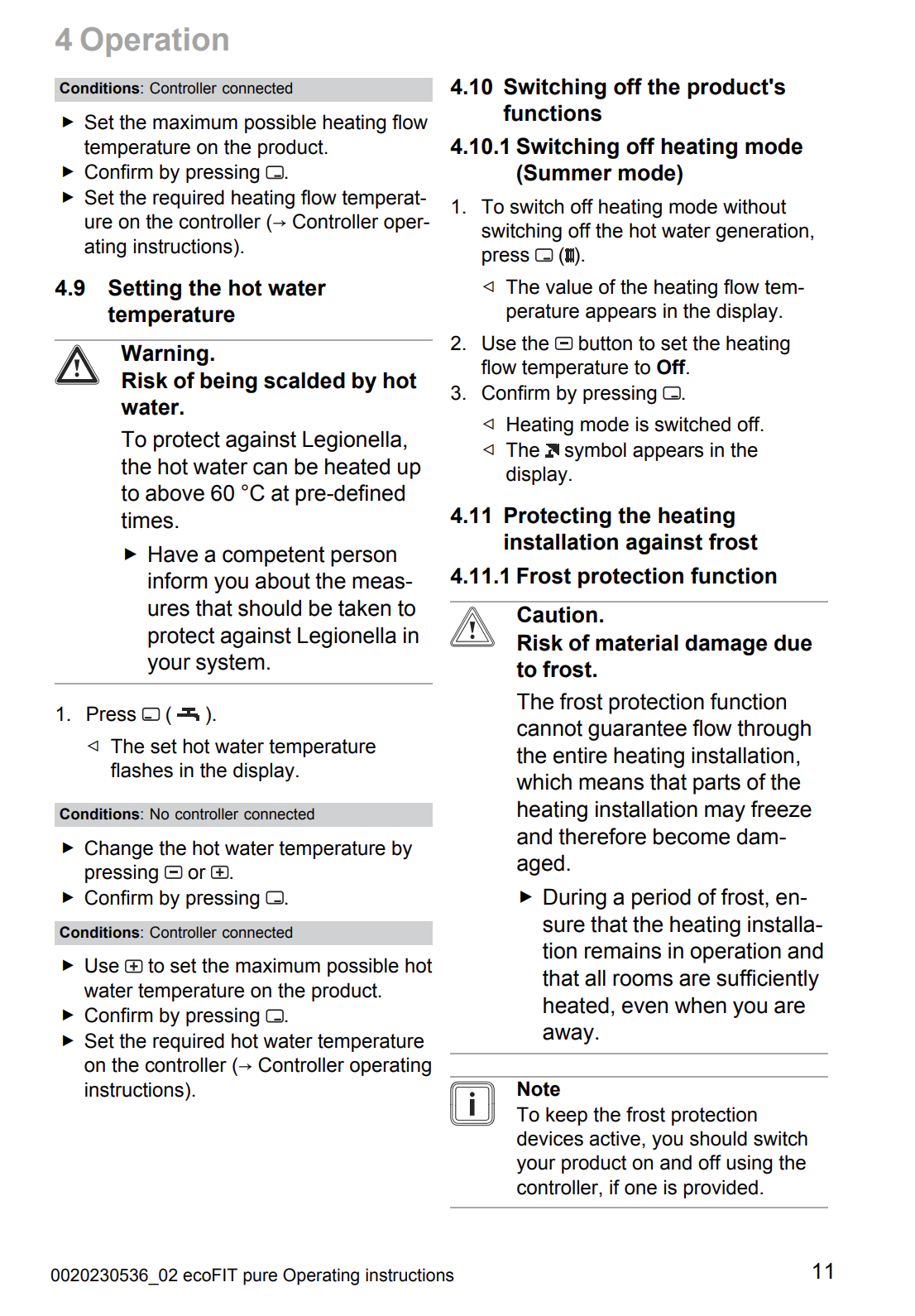

I don't have the boiler yet, but looking at the manuals it suggests you can seperate HW and CH temperatures. Frustratingly it makes no mention of needing their thermostat.
I’m not sure about the thermostat, but it’s their controller that’s needed. It mentions that in the very top left hand of the page you attached. That will surely interfere with the Hive controller. Also, the Hive (and most non-Vaillant controls) work on 240v. The Vaillant controllers work on 24v. It’s quite common for Vaillant installers to forget to remove the 24v link in the boiler when you are using non-Vaillant controls giving you all sorts of problems from day 1!

It still says condition: controller not connected and seems to allow separate water temp...hmmm. Confusing.

I just can’t see how an 18Kw boiler can put out 25Kw of heat! The other way round, no problem. As far as I know, it’s the water TEMPERATURE that is different on the boiler with Vaillant controls - you may want a low temperature for the heating efficiency and condensing but higher temperatures for hot water to combat legionella. I think @Harry Bloomfield might know as he has a Vaillant boiler with the Vaillant controls and is a lot more knowledgeable about it. I’ve mentioned him so he may be able to chip in.
Here's the spec sheet which mentions it.

Update from Vaillant on this:
Good Morning,
Thank you for your email.
The boiler will only be able to tell the difference between heating and hot water when installed with our controls.
Kind Regards
Technical Advisor
