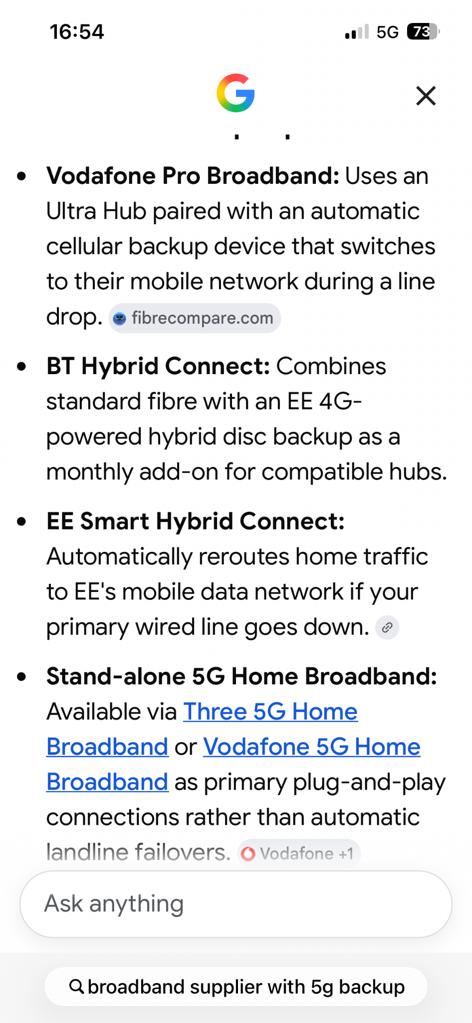

Galvanized conduit might help, but the appropriate tool could still get through that. And you'd have to make sure the box itself was covered. Read about cellular backup, which I presume would kick in instantly if the fibre cable got cut? Doesn't look like this is extensively available in the UK, and costs more...
Some cameras will of course continue recording to an internal HD unit, which you could hide and/or secure away in the home.
For now, I'm thinking 5G router for cameras.

many routers allow dual WAN, so the normal connection and a backup of 5G with a usb phone or dongle.
So you can get routers that automatically switch to 5G as back up if broadband goes down?
ie, fibre cable gets snipped 5G instantly kicks in?
certainly there are routers out there you can buy, that have the option to have the traditional connection to your ISP, then to use a mobile service as backup.
Dual WAN, usb plug in of a dongle or mobile phone. allows the dongle/ phone to provide a backup. you can use it payasyougo.
How you configure it is upto you and the limitations/ features of that router and your mobile device, and the mobile data of that provider.
5G will allow you usually to upload and download decent spec images, although you are more likely to use it for system notifications, stills and short clips.
I suppose the only thing to be wary of is how much data do you need to be transferred using the mobile service, but there is nothing to stop you using payasyougo, if you need more data you can change it relatively easily. remember its a backup and not your main use of data transfer, cctv can take up a lot of data.
The minimum you need as a backup is to view your live streams, as normal either reduced resolution or full resolution for how long?, so upload speed is your limitation, we can get ell over 100mpbs on 5G with the phones/dongles we have used, thats plenty to view an 8MP camera full resolution and frame rate for most cameras 30fps being the the best for most cameras used on domestics.
yes if its plugged into the router and the ISP fails you probably wouldn't notice the switch
