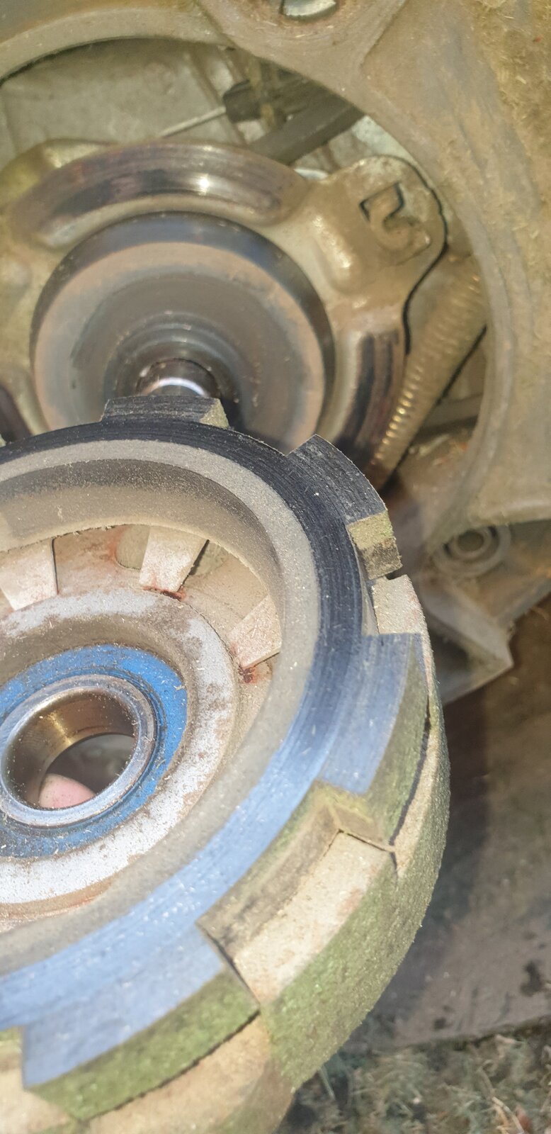

Started to pull the rotor clutch off expecting to find something obvious but to my untrained eye things look pretty standard. bearing feels reasonable and no parts fell out. I feel sure this is clutch related as the metal knocking sound only occurs when the rotor is in the process of being engaged - not at idle or fully engaged. Anything here not look right??
That looks pretty typically Honda perfect to me......I have replaced a few bearings though - the one with the blue seal.
Top pic......is that plate tight on the crankshaft?
Do check the idlers for wear though, much more common!

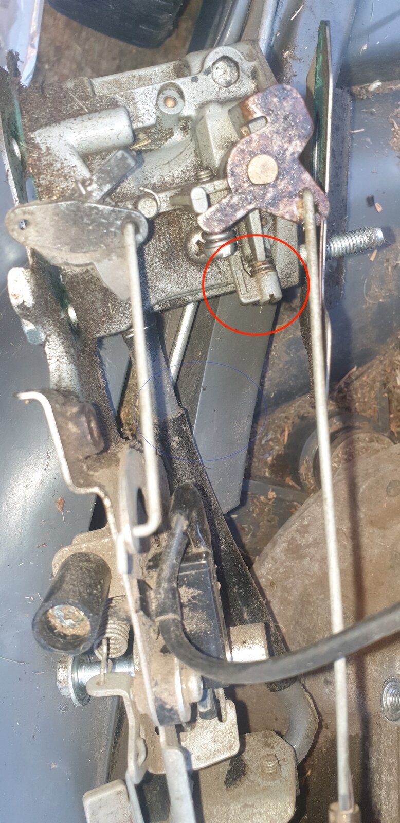

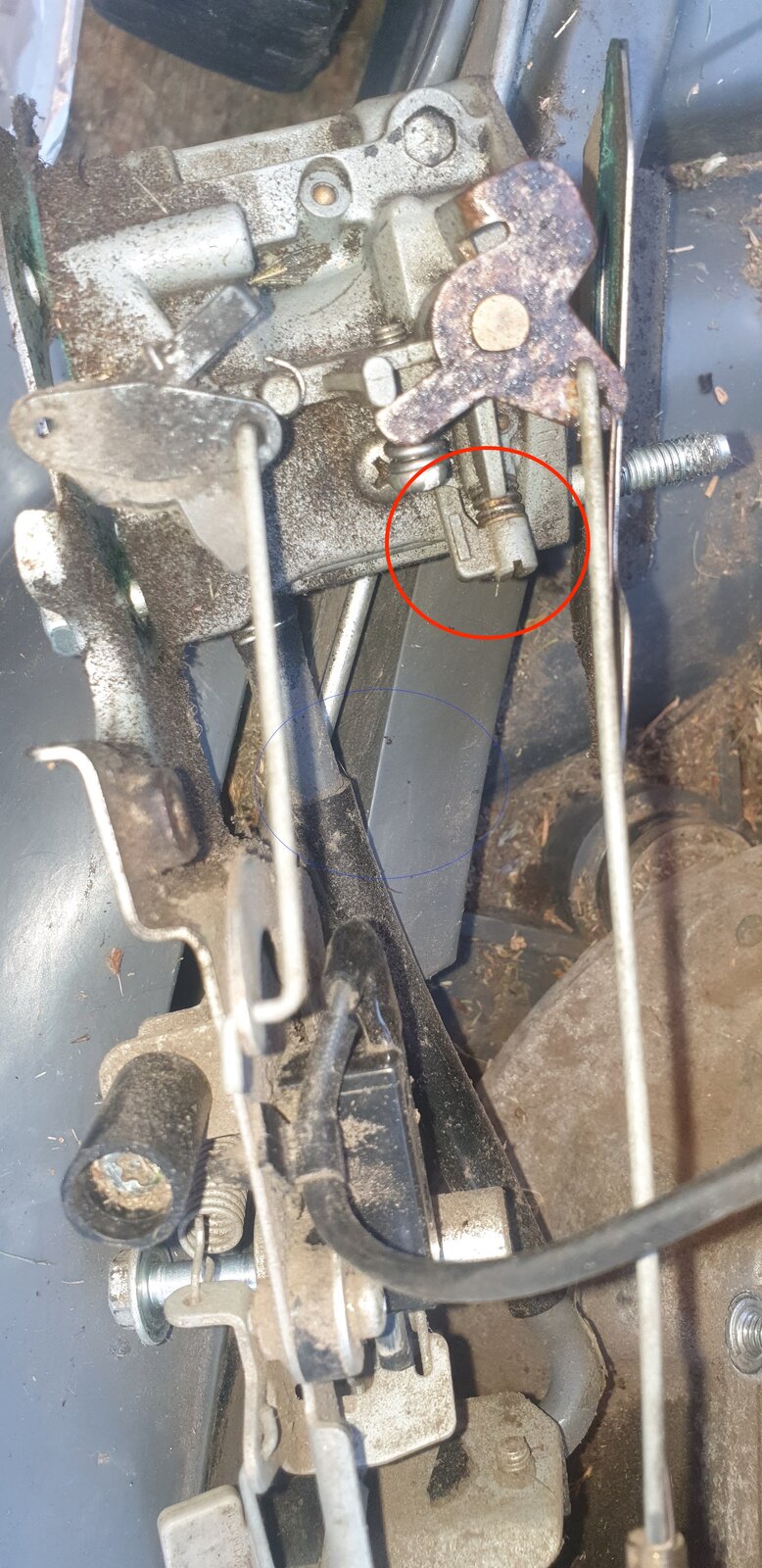

Hi John - thanks for your comments. I do think there maybe some cylinder wear as its a few years old but I am not overly concerned - generally it runs really well and I dont lose oil. Carb was completely stripped emulsion tubes etc etc twice except for the small captive quarter turn screw (I couldn't get that off and dont know what its for). I will check the oil but filter is new and plug got changed mid season last year.

That quarter turn screw is actually the pilot mixture adjustment.....Honda have made the adjustment minimal to minimise pollution!
If you have to remove the screw, the lead lug is cut off and the screw can be fully undone.....there's a plain brass head underneath the cap.
The pilot jet is actually hidden by that screw, under the Phillips screw that's just visible slightly to the left.
This one gets its air bleed from one of the small holes drilled to the side of the main choke - looking at the carb with the air cleaner box removed.
All the carburettor tiny orifices need to be flushed through with carb cleaner and preferably compressed air to guarantee full performance.
