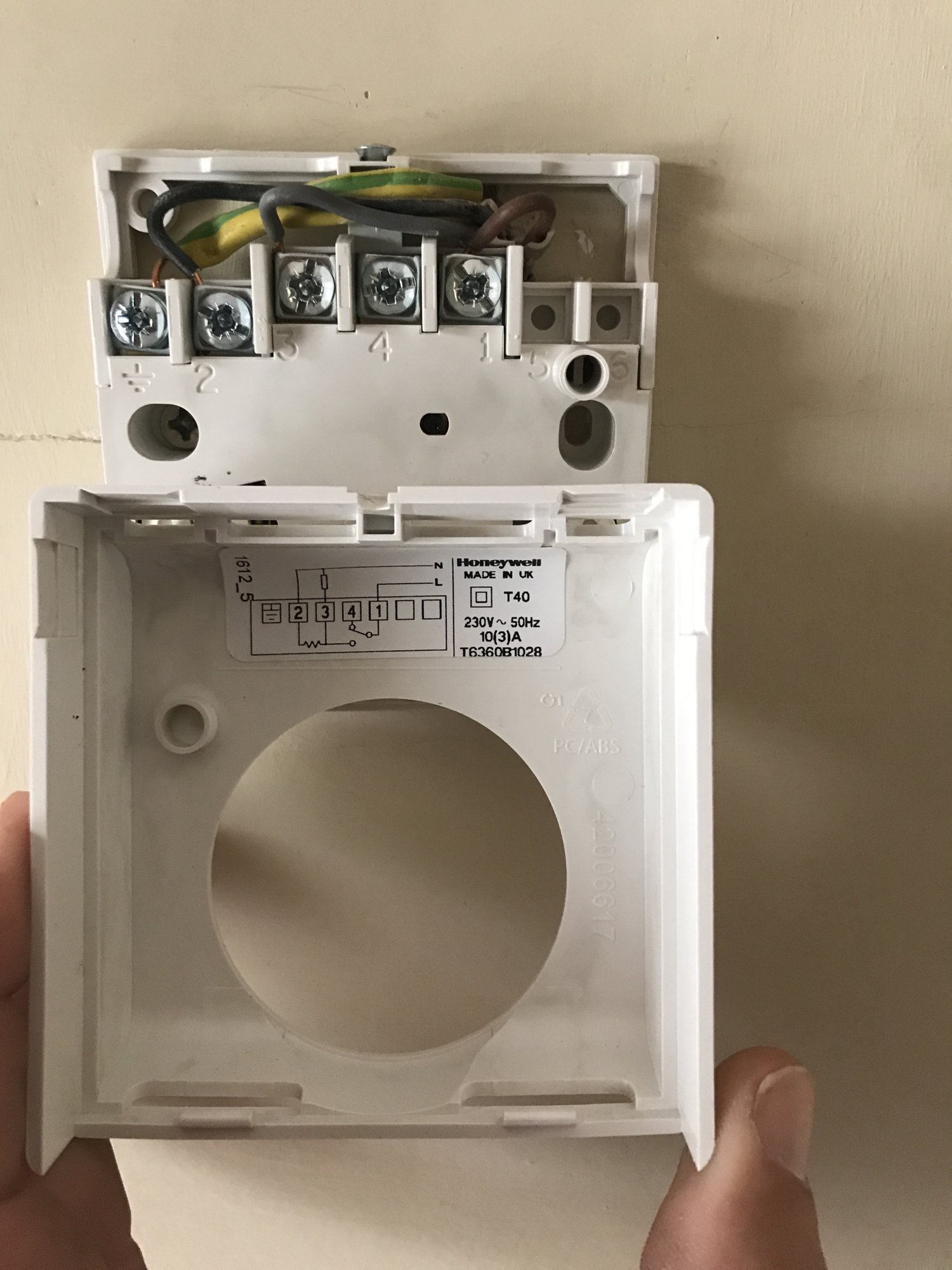

Currently have the Honeywell t40 installed and it’s not been working well. It’s analog one and the misses wanted a digital one.
I have for the Honeywell DT90E - The chap in screwfix said its a straight switch. But it’s clearly not ha ha.
Currently I have 5 wires and the new thermo needs 3 - I don’t want it to go bang but it can’t be that hard to do.
Any help would be great.
Thanks in advance.
I can only see 4 wires and the new one needs 2 - good start.
You do not need a Neutral in the new thermostat so terminate the black wire in a connector block and position safely so it doesn't touch anything else.
Do the same with the earth wire if there is not a terminal for it.
Brown to A
Grey to B.
Thank you for the help.
Correct 4 wires. I saw 5 terminals and made an assumption I had five wires.
