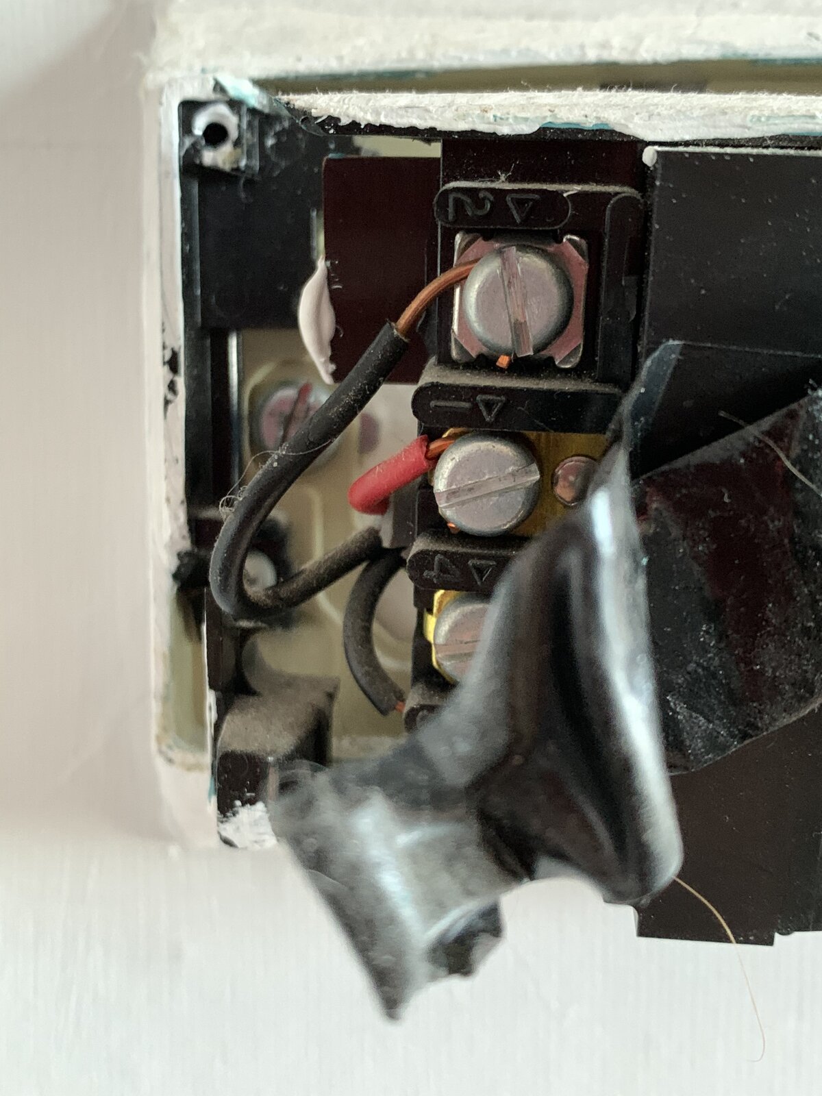

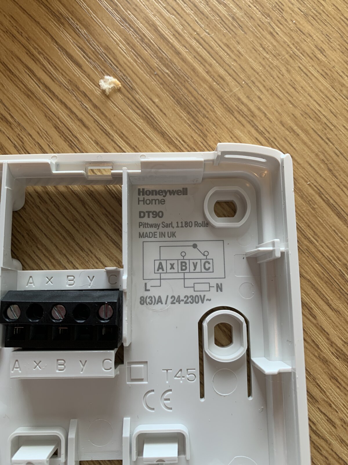

Hi I am wanting to replace my analog thermostat and have purchased the Honeywell DT90
anyone able to say on the old one that the wire in terminal 3(the bottom black wire) is some sort of earth and won’t be needed in my 2 wire digital thermostat
otherwords connect red in terminal 1 from old to new live and black in terminal 2 to new neutral?

You do not have a new neutral.
The rectangle on the diagram represents the appliance therefore the wire from thermostat to appliance is the switched live; only becoming neutral after the appliance.
Ok.
Mistake corrected
1 is L
2 is N and
3 is SL
So,
L to A and
SL to B
You do not need the wire in 2 any longer.
However, it would appear someone has used the bare earth wire (with black sleeve) for the SL - not really allowed.
Therefore it would be better if you swapped Black and earth wire at the other end of the cable and use the black for the SL.
Ok so can put
2 to A
3 to B
Discard 1
thanks very much. Great help

2 is NEUTRAL
1 is LIVE
3 is switched live
So 1 to A and 3 to B and make 2 safe
If you wire it as advised above you will blow the fuse and possibly damage your new thermostat and boiler.
Thank you John.
Of course I got 1 and 2 the wrong way round. I will edit my posts.
Yes, sorry John about my mistake.
The red live wire should be to A.
The advice about the black wire still stands.
