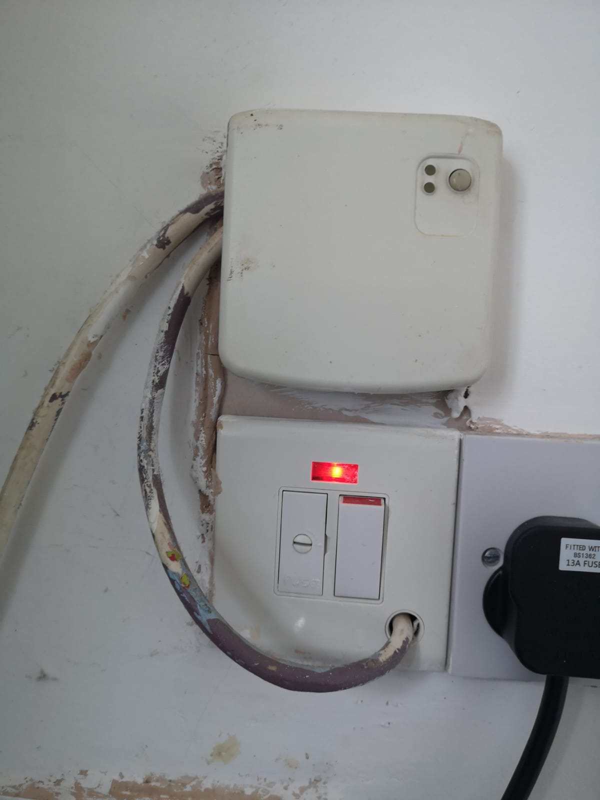

My first post in the forum in search of somehelp. I'm sure it's been discussed before but i could not find exact info.

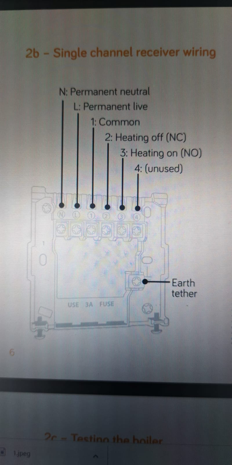

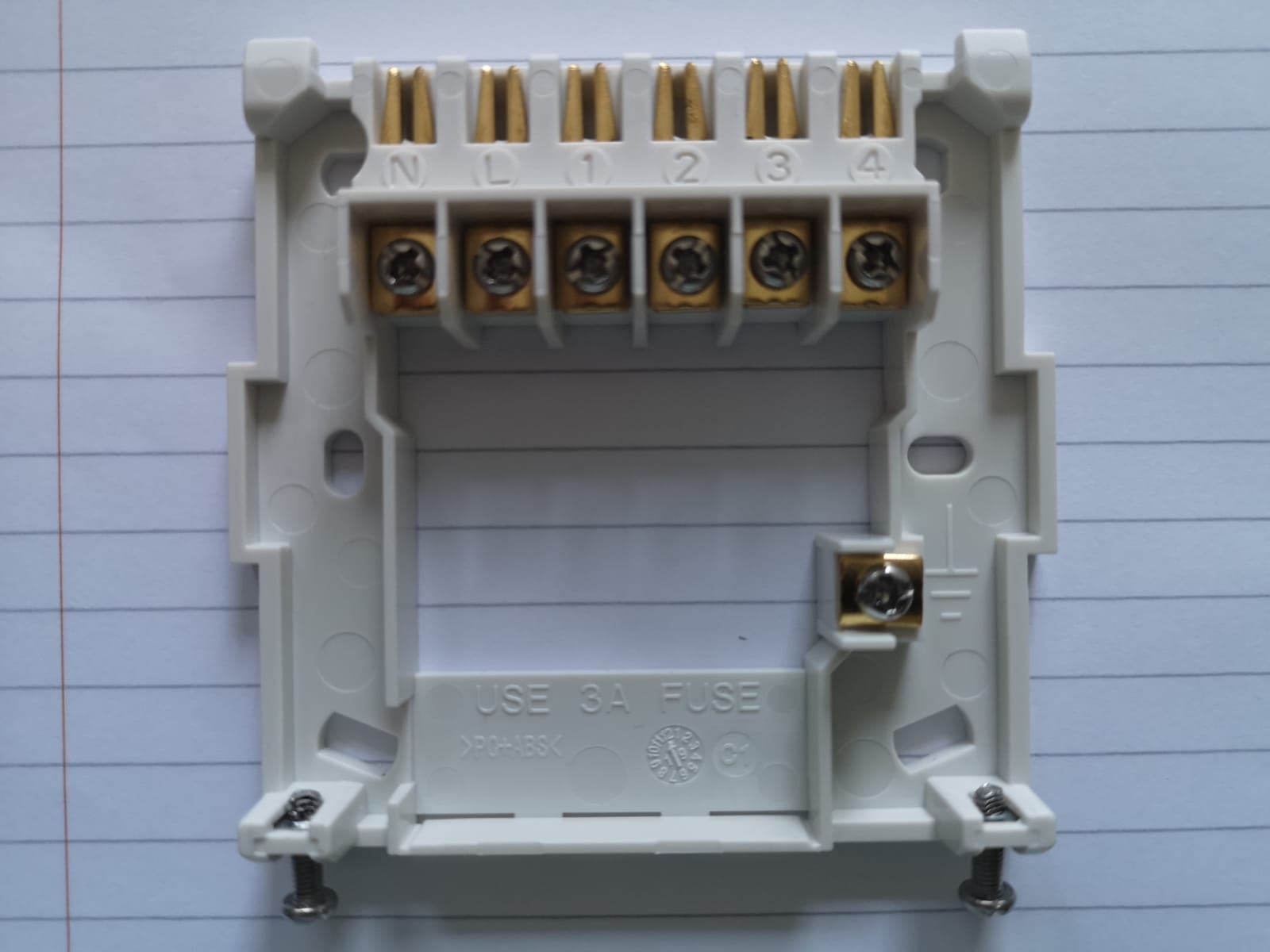

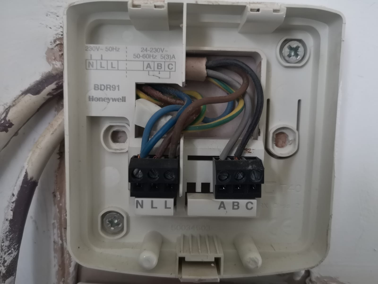

I'm trying to wire my new Hive active heating receiver but can't work it out.
Please see attached pics and let me know which wire goes into the new receiver.
Many thanks in advance.

L&N from BDR to L&N on hive
A&B from BDR to 1&3 on hive either way round doesnt matter
