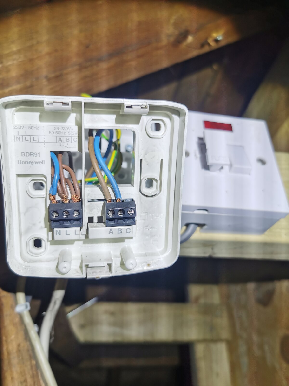

Hi all, my Honeywell CM927 RF system has blanked three years running I've done the fixes but now going to change over to a Drayton RF system.
The neutral live live wiring of the Honeywell system does not correspond to the new Drayton system,can you offer me a wiring solution please?

The RF902 is a dual channel programmer, controling heating and hot water - it provides mains voltage to its output terminals.
Your existing controller has a single channel for heating only.
It has 'volt free contacts', meaning it's compatible with the (extra) low voltage circuits in some boilers.
I believe the Drayton RF901 is the equivalent single channel controller, although it may still be possible to use the RF902, depending on your boiler.

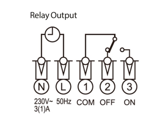

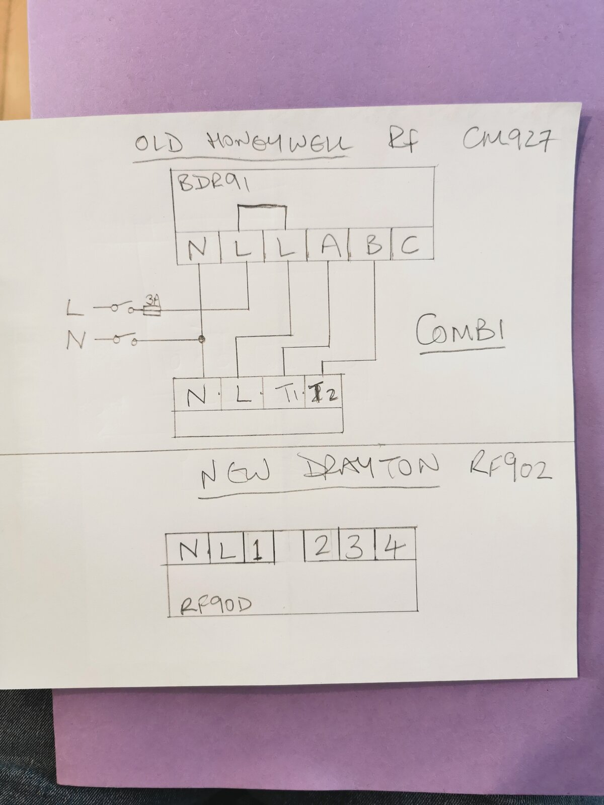

if I swapped it for an RF 901 what would the wiring layout look like compared to what I have then please
it's obvious you know just what you're talking about!
I wouldn't say that! ;)
The two Blue wires in N on CM927 to N on RF901
The two Brown wires in L to L - forget about the small link wire - that wasn't even needed on the CM927.
Brown wire in A to terminal 1
Blue wire in B to terminal 3
The Green/Yellow earth wires can be connected together in the RF901s earth terminal.
The L and N wires could also be tidied up a little, there's a few too many straggly ends of copper showing at the moment!

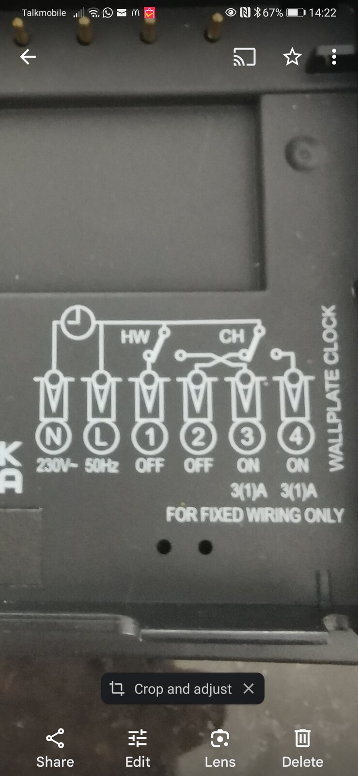

So I think this will be the last question if I just held on to the 902 could I do the 1 and 3 and leave the 2 and 4?
Chris.
No, as earlier, the 902 outputs mains voltage.
Without knowing your boiler, or how it's wired up, that may be a costly mistake - i.e. if you had a Vokera boiler, the control circuit is 24V DC, and you'd be paying for a new boiler PCB!
If your boiler was operating with a mains voltage control circuit, we would have to discover which wire (currently in A, or B) is the live return to the boiler.
It would be this wire that went into terminal 4 of the 902 - terminals 1,2 &3 would be unused.
You'd also have a hot water control showing, that had no function - just a little annoying!
