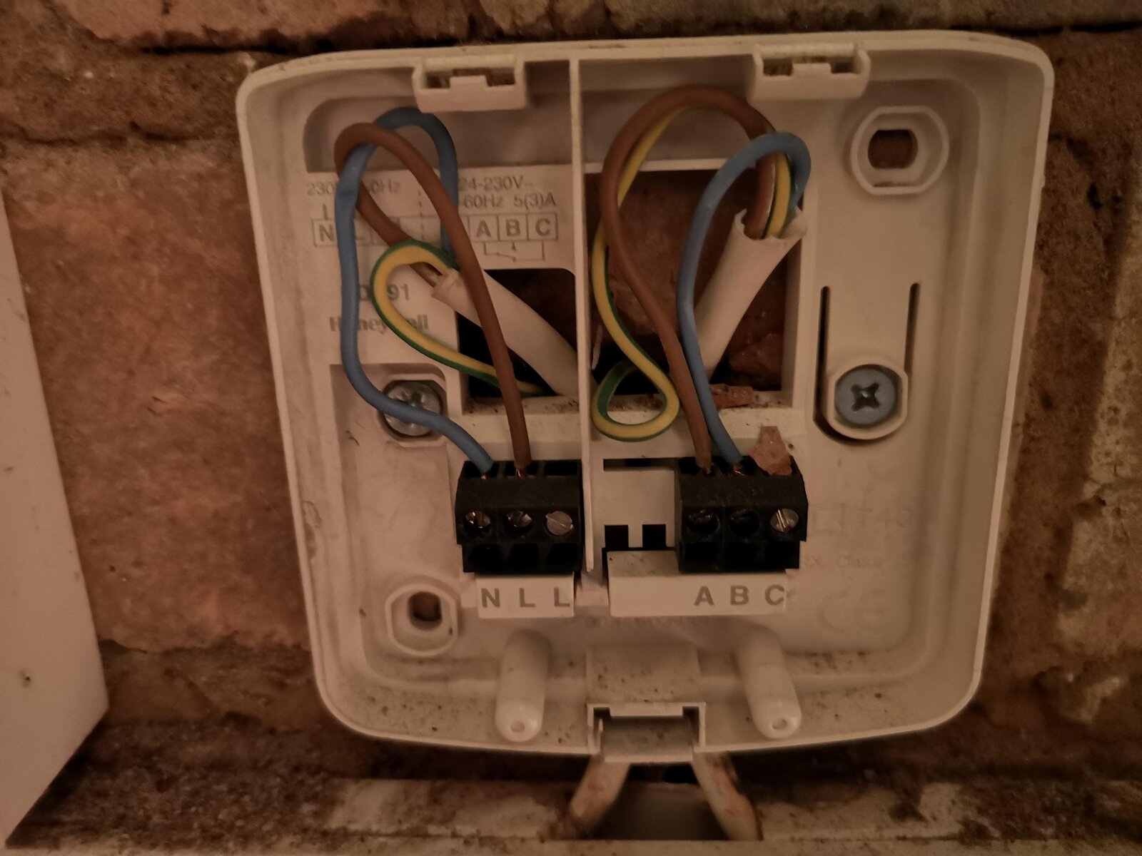

I get the feeling the thermostat is playing up so may consider changing it.. Anyway I've looked at the wiring and just wanted someone to roll their eyes over the pics and look at the way it's connected.
Seems there is a connection from the fused spur going to the honeywell receiver then another wire from the receiver to the boiler.. I thought it would be the other way round.. fuse to boiler and boiler to stat receiver..

The thermostat is simply an on/off switch. When heating is required terminals A and B are electrically connected and the heating comes on, when not required, they are disconnected and the heating goes off.
The switching on/off time period will change. This is because it is being controlled by the actual air temperature in the room where the thermostat is located, so it will be on longer when the weather is cooler and when the timer first switches the heating on in the morning, and less when the weather is warmer or the heating has been on for some time. The test of a thermostat is: Is it controlling the heating to the set temperature, such that the heating goes 'off' when the set temperature in the room the thermostat is located has been reached, and then cycles on and off to maintain it? If it's switching off when it shouldn't be, then it's possible that there is a fault, or a loose connection. [Some stats do turn off a degree earlier to prevent overshoot]
Regarding the supply from the fused spur: It matters not if it goes to the thermostat first and then the boiler or the other way around. it's simply providing a permanent 230V mains supply for both of them.

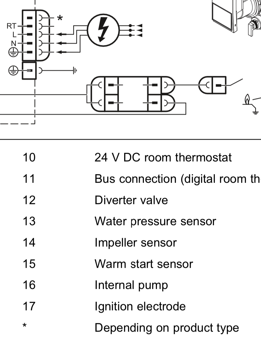

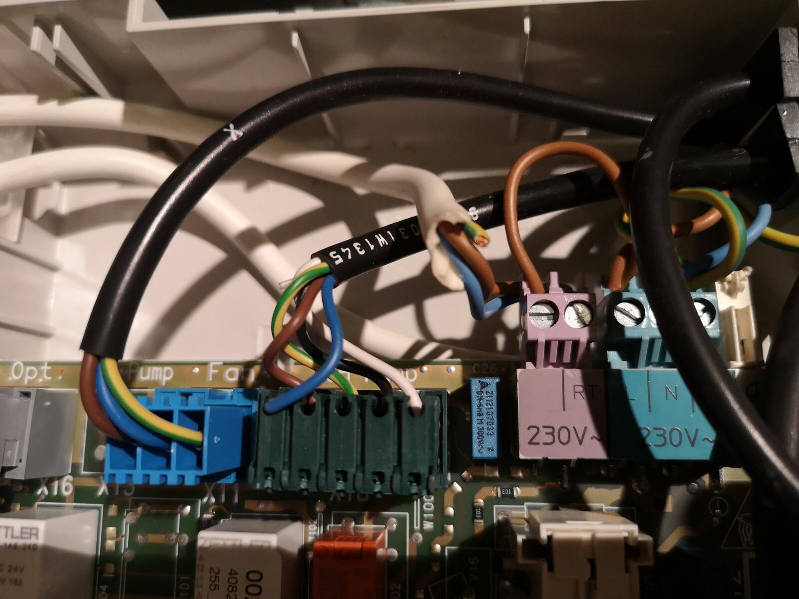

It’s difficult to tell, but there appears to be no wire in the RT side of the boiler? Just what appears to be a link from Live to the non functional Side.
@stem is correct, S.30 means that the room thermostat is blocking, basically meaning the thermostat isn’t requesting heat currently, it’s not an error code it’s a status code, hence the ‘S’.
Also opening that particular boiler forms part of the combustion circuit and should be tested by a competent person afterwards.

Im not a boiler engineer so I'm probably wrong - why is the input live bridged to RT?
Does RT not output a voltage to go through a volt free contact and back to switched live?
Afaik, that side doesn’t do anything, so I don’t know why it’s bridged, which is what I queried in post #8 and @ianmcd in post #12. Can you post a better photo as requested?
The connection from the fused spur is powering the receiver. The second connection from the receiver to the boiler is not providing power to the boiler, but making/breaking a connection that enables the boiler. Hence:
If you were to move the wire from thermostat B and put it in A with the wire already there, then the heating will be 'on' permanently.
There will be another cable (perhaps from the same fused spur) powering the boiler.
