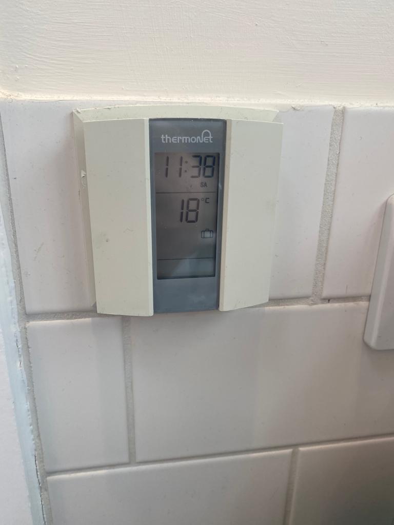

I've just moved into a property with a combi boiler and a 'Honeywell Home' unit attached to it:
From searching online, we should have another unit somewhere in the house with a digital display, e.g.:
However, we do not have such a unit.
The only thing resembling it that we do have is this:
But it isn't Honeywell branded and googling it suggests it is an underfloor heating thermostat...
Are we therefore missing a thermostat? Any help would be appreciated.
Yes, you should have a thermostat if the Honeywell is connected up. The thermonet appears to be in holiday mode, so could have been set like this to ensure the Honeywell takes over. On the Honeywell home unit, press the round button, this should confirm if there’s power and if it’s working. Is the property your own or a rental?

i've played around with the Thermonet unit. it controls the underfloor heating in kitchen and bathroom--nothing to do with the central heating.

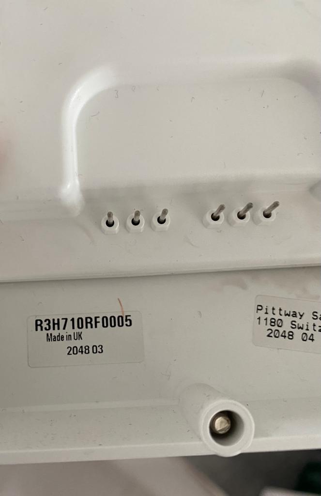

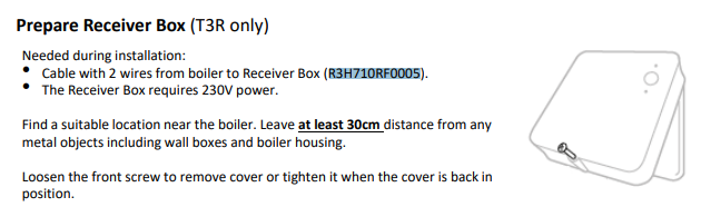

edit: having done some googling, it looks like the thing in the boiler cupboard attached to it (an "r3h710rf0005") is a 'boiler relay' which is designed to work with the T3, T3M and T3R thermostats. so i'm hoping i can order one of those and pair it?
If that information is correct, it’ll be the T3R and yes you can pair/bind it to the receiver, I’ve done a few, it’s quite easy. https://ensupport.getconnected.hone...thermostat-to-the-receiver-box?language=en_US
thanks for your help.
i'm 99% certain it's the right info. this is written on the faceplate of the 'boiler relay':
and this doc suggests it works with the T3R:
our preference would be for the previous owner to send it to us, but if not we'll buy one and set it up using the guide you posted--thank you :)
