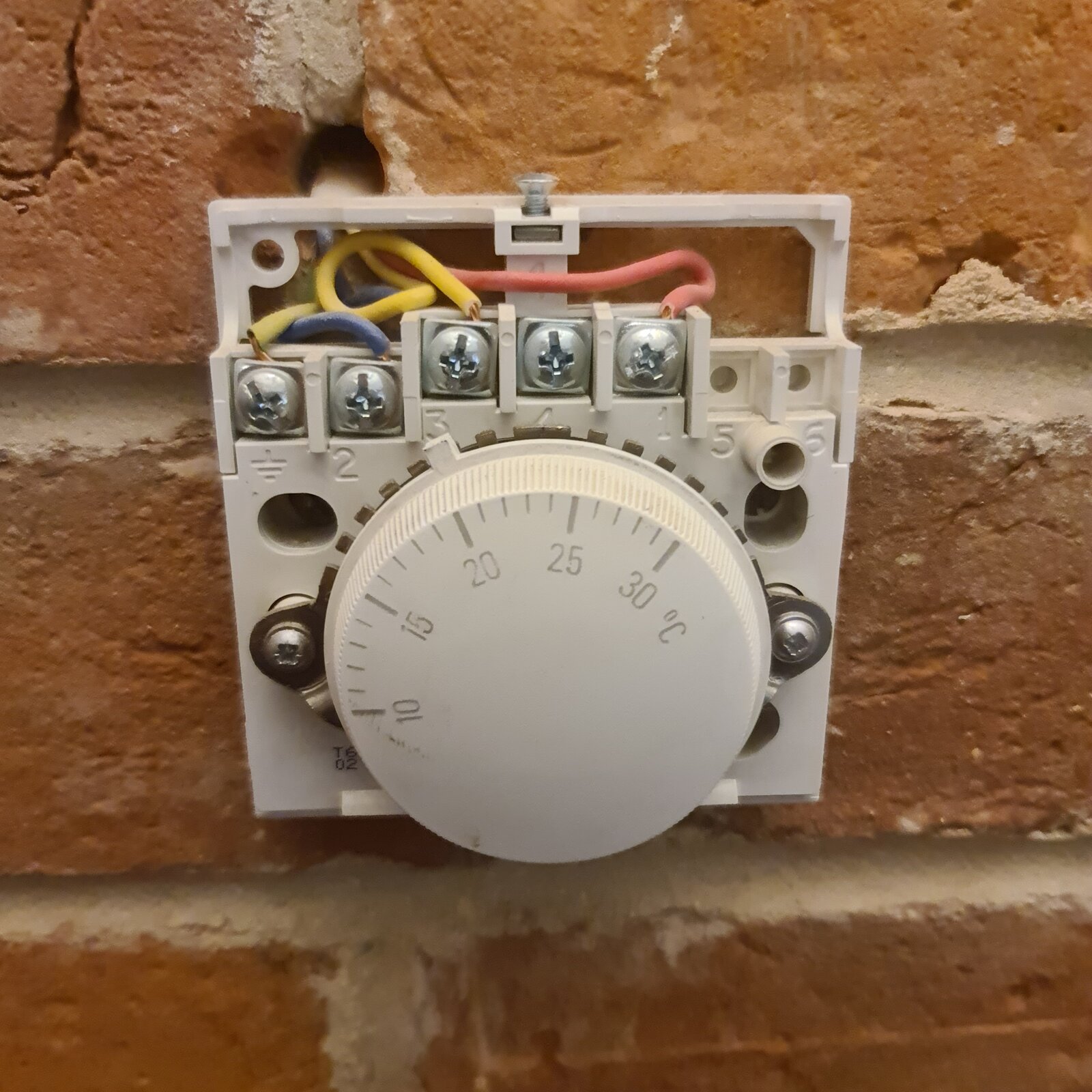

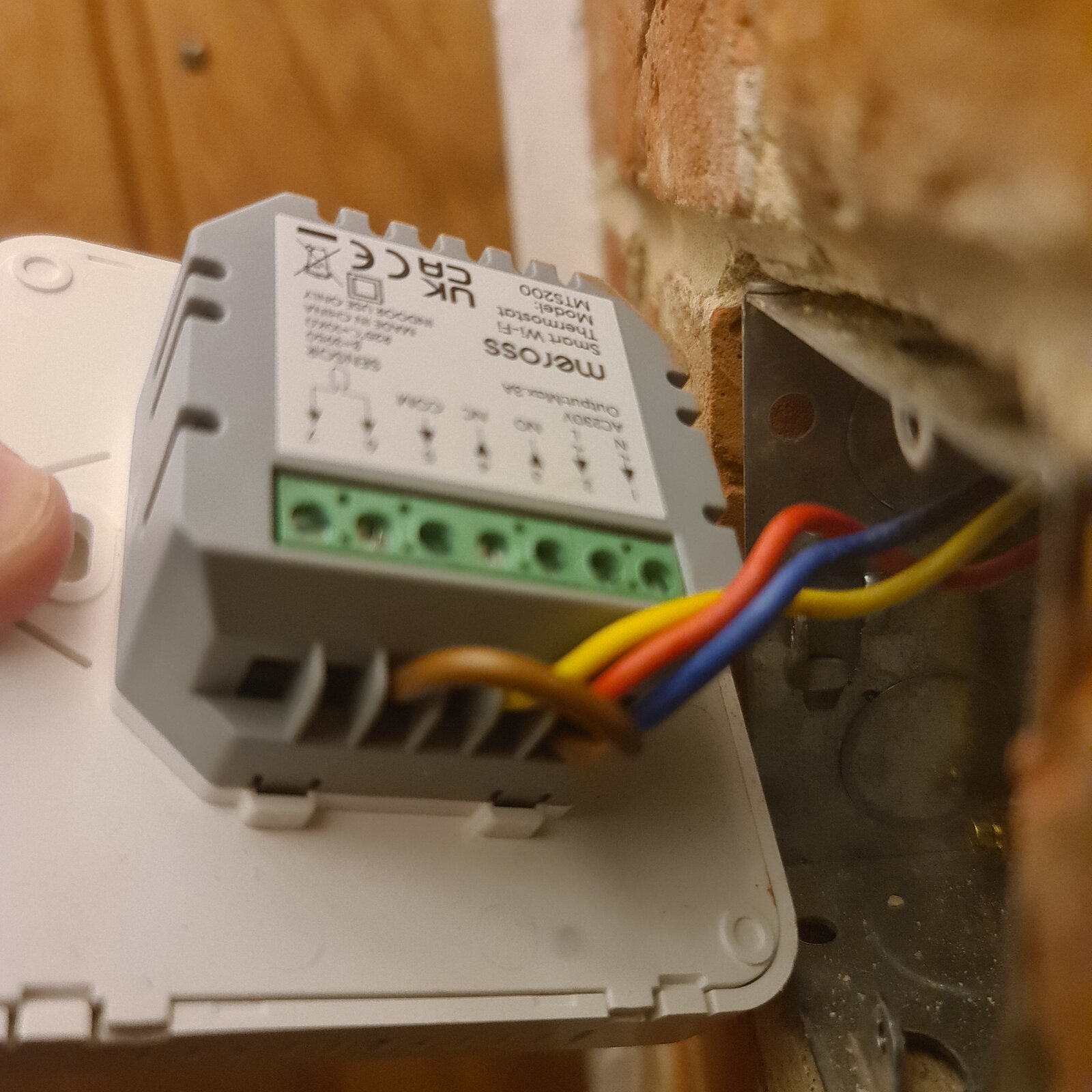

Hi - I have inherited an old ST6400C when we moved in 7 years ago. I'd guess its 15 years old looking at the agr of the boiler etc. Generally been working OK but I recently replaced the mechanical dial wired thermostat ( see pic ) with a meross mts200b ( see pic ).
Since then ( it may only be a coincident ), fairly regularly, but not all the time, the programmable timer (ST6400C) will just reboot ( continuously) when CH+HW go live.
I believe the mts200b wiring is correct - the switched live goes live when the thermostat drops below temperature.
Have a just got a dodgy ST6400C or is my wiring of the thermostat causing it?

If it’s worked before you changed the wiring, then it’s suggests this could be the fault. Have you tried putting the Honeywell T6360 back in to confirm? I think your Meross needs a permanent live and permanent neutral. Your dial stat (T6360) could have been wired incorrectly/back to front too.
Ah good points Stuckinarut,
Unfortunately the T6360 was thrown away. The meross unit does require a permanent live but I've turned the CH on permanently so I'm assuming that effectively the same thing. The wires may be connected wrongky but I ran a multimeter over N,L and S/L and all behaved as I expected.
I was wondering if I could take the meross unit out of the equation and replacing it with a wiring block I could discount the meross unit ?
Your wiring to the Meross appears to be correct.

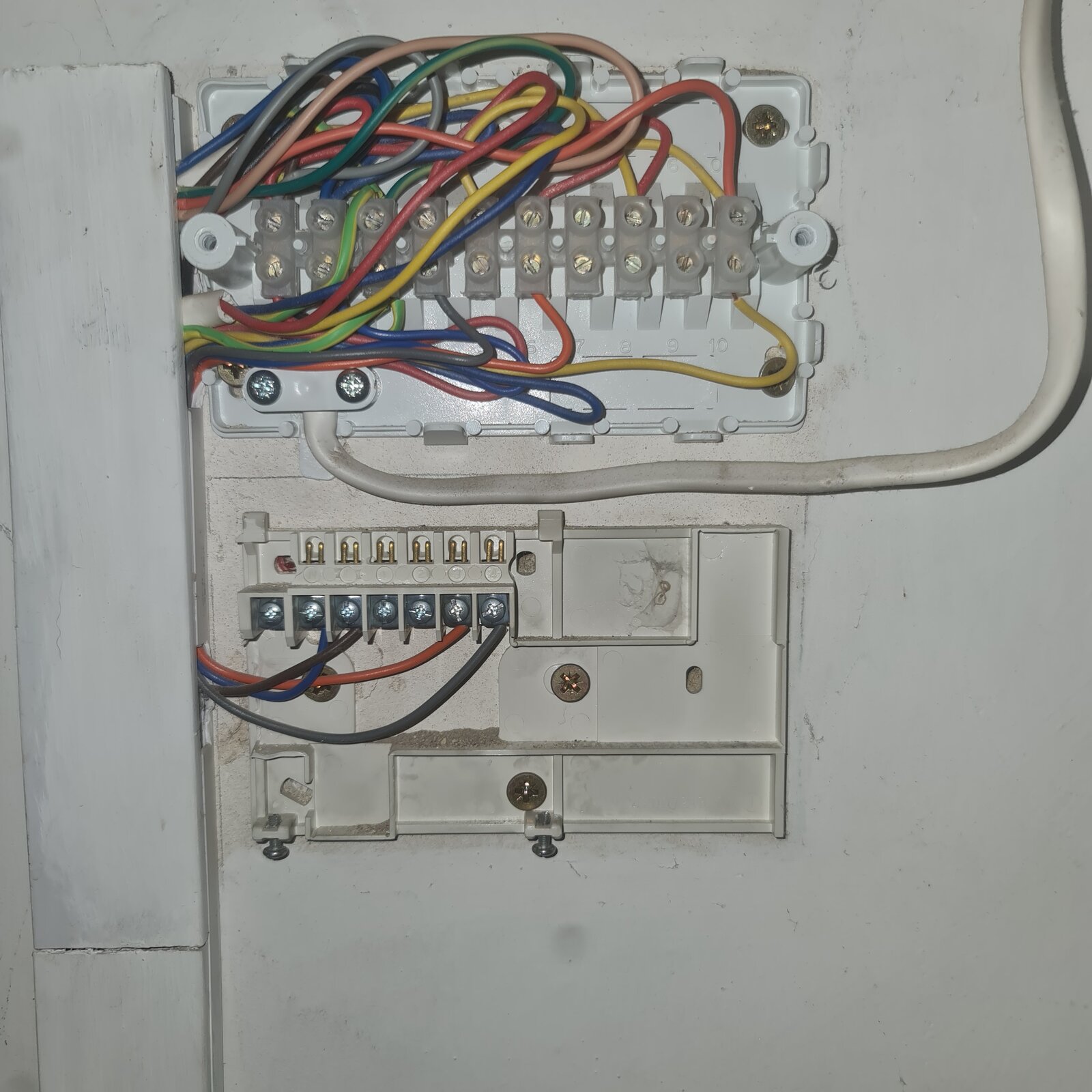

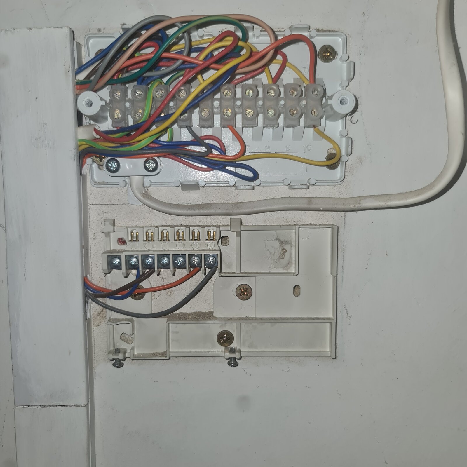

If you can show us the wiring behind the ST6400C, we can advise you how to bridge it out.
Thanks Stuckinarut, I think I've isolated the problem to the ST6400C. Whilst this was continuously rebooting I disconnected all the wiring of the meross - S/L is no longer live. The rebooting continued. I then turned off the HW on the ST6400C and it stopped rebooting - leaving the CH circuit still on but not drawing any heat from the boiler as I had disconnected the meross. I then connected the L and S/L that had previously been connected to the meross and the boiler started to draw heat.
In my mind this proves there's a fault with the ST6400C.
Is this sound logic?
Thanks - yes - planning to keep th HW.
With the power safely isolated; either move the red wire in terminal 4 of the wiring centre to join all the other wires in terminal 1.
Or (probably a little simpler), move the grey wire from terminal 4 on the ST6400C backplate to join with the Brown wire in the L terminal.
