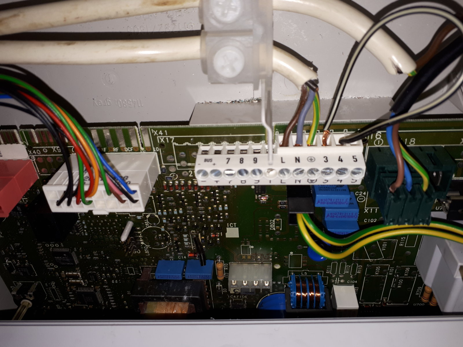

Terminal 4 of the programmer is a light grey. The flex in the boiler to connect has 4 cores; black, brown, dark grey/blue and the earth. Would I connect the black or grey/blue core, please?
OK, so there is some existing wiring in place that may need further investigation. The advice I gave in my first post was based on starting from scratch.
There are several ways to wire up these things, so I will need to know where all of the existing wires in the photo go, particularly the brown wire from the room thermostat terminal 3.

Also the specific model number of your boiler. I can tell it's a Vaillant, but there are sometimes slight differences as the product evolves and between variants.
I have had a bit more time to study your photographs now and have worked out the following diagram which I think represents how your system is wired. Please check that the wires are as I have sketched and go where shown.
I also believe that you have an ecoTECH Combi boiler as the terminals shown in the Vaillant manual below matches your photo. If you have a different boiler please advise.
At the boiler end you will still need to remove the loop between terminals 3 & 4, but wiring it as I have shown in my sketch means that you will not need any connection to the boiler terminal 3.
The brown wire in my sketch from the thermostat terminal 3 which should go to the boiler terminal 4 will have been disconnected, when the loop between 3 & 4 was added
If anything is different to what I have shown or said above, or you are unsure about anything check first.
Using terminal 3 will ensure all voltage to boiler is interrupted via boiler spur.
Thank you. I've followed your advice; however, the boiler still fails to operate the central heating with a new programmer added. Could it be the thermostat?
First of all check the wiring connections carefully. Especially the brown wire going to the boiler. It should be in terminal 4 as per my drawing, and not in terminal 3.
Secondly, if the brown wire was in terminal 4 already, does the Honeywell ST9100C power up OK?
If it does power up OK, does the green indicator lamp between the 'extra hour' and 'override' buttons illuminate when the heating is switched on?
If it the green light does come on, the next test would involve inserting a loop wire (you can use the black / white one you have just removed from the boiler) and join the programmer terminals 1 and 4 together. Leave the other wires in place. Don't replace the programmer on the backplate and try it now. If the boiler operates now, the programmer is faulty.
Thanks.
I checked and the wire is correctly in terminal 4 of the boiler. However, on testing it with a Fluke VoltAlert, it indicated no current.
The new programmer powers up, clicks and lights up as it should and as the previous one did. However, the central heating still doesn't switch on.
I have linked terminals 1 and 4 of the programmer backplate but still the central heating fails to operate.
