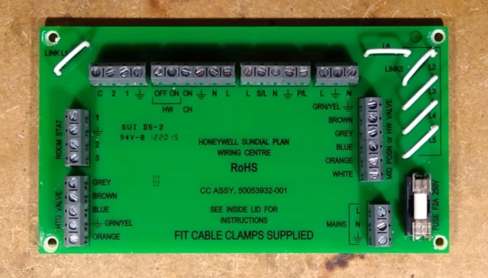

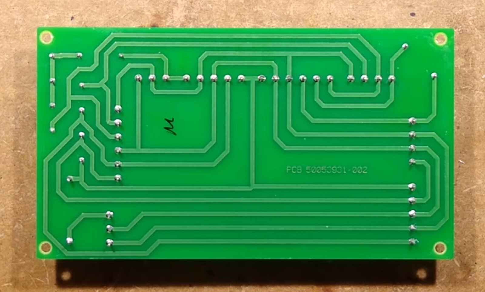

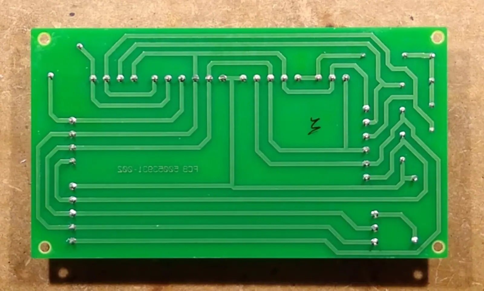

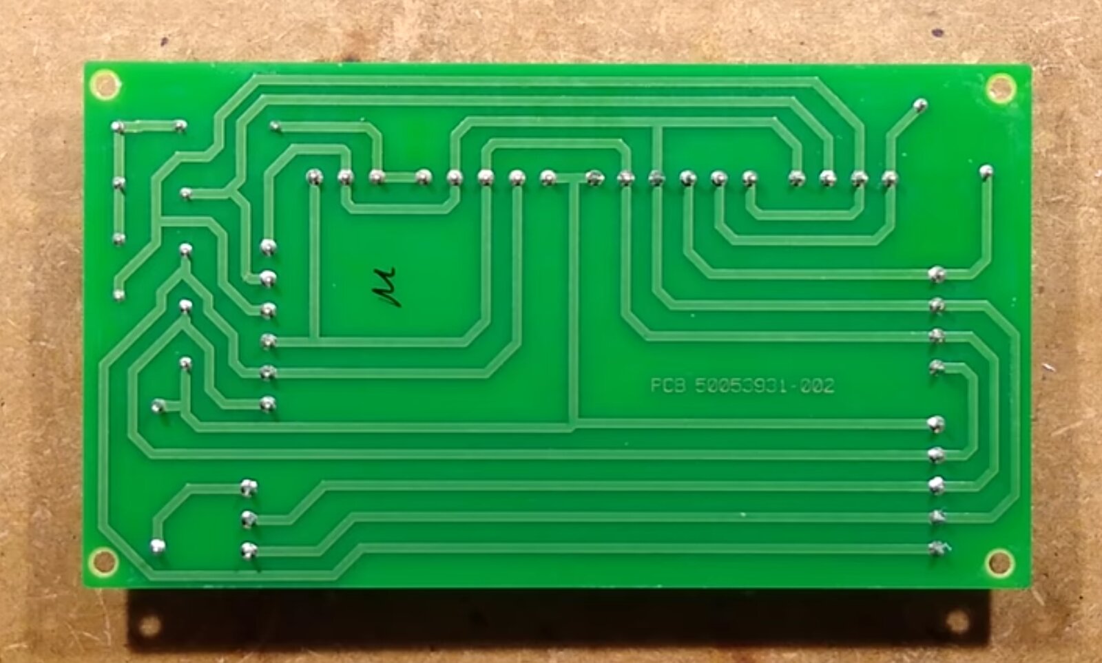

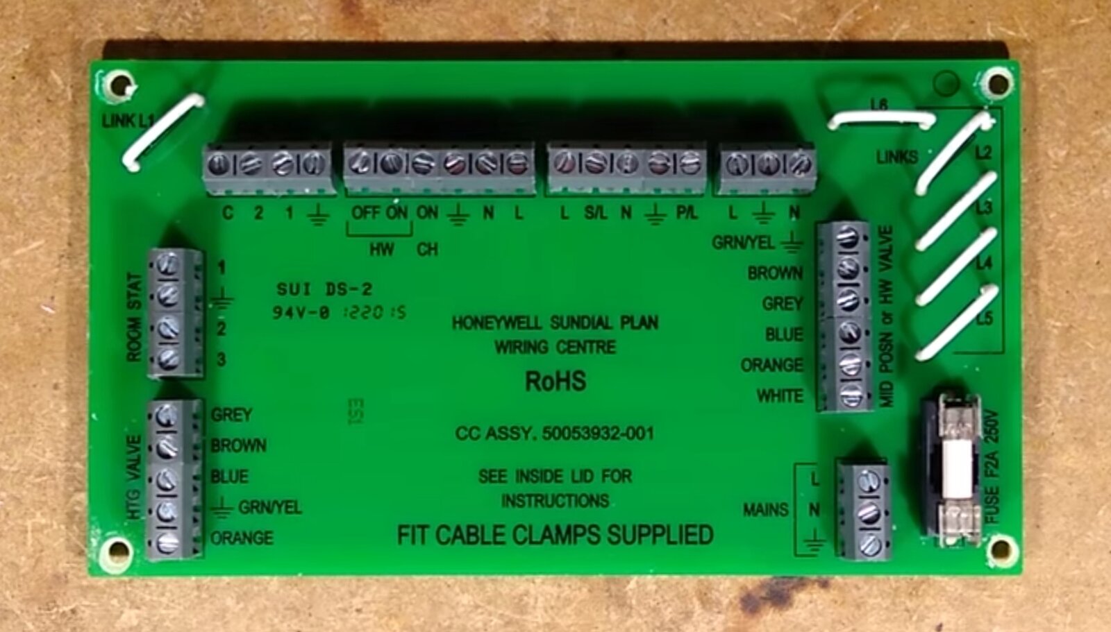

In case anyone else needs them, here are snapshots of the front terminals and the PCB rear wiring of the Honeywell Sundial wiring centre 42005748-001. I've flipped the wiring so that it can be overlaid on the terminals picture to show the connections more easily.
