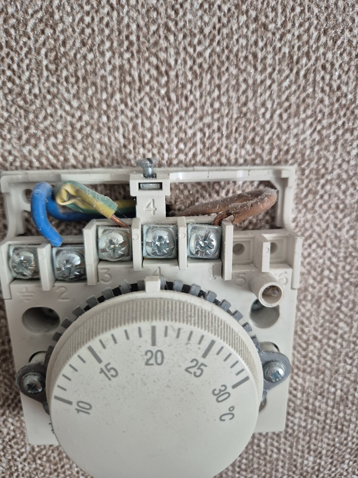

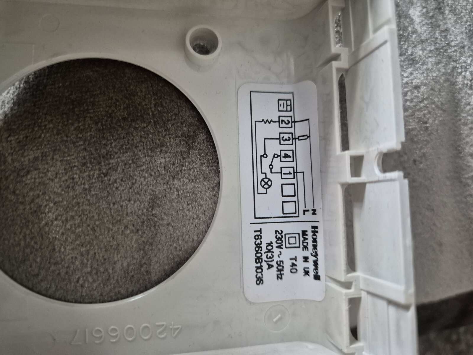

Hi, I have had a T40 stat for many years and now want to change it for a digital stat, but not sure which stat to buy.
I only want it to turn on and off the heating, nothing else ( like wireless, timer, app controlled etc), just a plain temperature controller.
Also would like an easy to replace stat, only have 3 wires connected to the T40 now.
1 - Brown
2 - Blue
3 - yellow/green
Any advice or suggestions as to best replacement would be appreciated, thanks

That is naughtly using a bare cpc for a live conductor. They could of at least used neutral!

Brown (Live) to T1
Blue (Neutral) to T2
Green/Yellow marked wire -> not the earth (cpc) terminal but -> T3 = Switched Live (call for heat to boiler)
So that needs re-sleeving as brown (or red) to indicate it is a switched Live wire!!

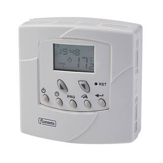

ae235.jpgThese are two wire programmable thermostats which will replace the existing, although the one shown I had the instruction book tucked under a corner as could never remember how to set it. The Nest e
also two wire, and more user-friendly but a lot more expensive.

No, it needs to not be used for anything but an earth.
A circuit protective conductor shall be run to and terminated at each point in wiring and at each accessory except a
lampholder having no exposed-conductive-parts and suspended from such a point.
There is no get out. As is, it breaks the rules.
OK so the OP had best re-wire his boiler control system at both ends of that cable to have Line, switched Line and CPC. Reducing choice of thermostat.
Or run a replacement 3-core+cpc between the two locations if a neutral is needed for the chosen wired thermostat.
Or go wireless thermostat, disconnecting that cable entirely.

The system was installed when I moved in, was not aware the bare CPC was being used for the live, thanks for the info. Will have to rewire the unit and boiler for new stat.
Want a new stat as I know it does not always switch on when it gets cold, until its really cold even if I turn it up a bit, so new one needed and I read that a digital stat is more accurate and efficient than this T40

Thanks for info, was not aware of the T3 terminal connection being switched live, will need to rewire.

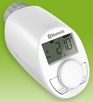

Slewing temperature difference is the difference between switching on and off. But setting the TRV and wall thermostat to work together is not easy, and is not helped by marking the TRV head *123456. Although the electronic head is better, 61dmtMm13BL.jpg with degrees C marked, and open window detection so after opening the hall door it waits a set time before opening and re-heating the room, it is maybe too accurate. A mechanical head, set at around 2¼ will likely start to close at 17°C but not fully close until 20°C so a wall thermostat will switch the boiler off set at 19°C on warm days.
But in the rest of the house, the electronic TRV can work far better, I have 5 of the ones shown, cost me £15 each in 2019 before Brexit, but now have gone up in price. The blue tooth only seems to work with one device, so either my wife or me has control not both, but the main reason for blue tooth is where two are in the same room, you can pair them together.

If not the cheeky plumbers or gas safe engineers did it, then probably bizarrely slow the thermostat was acting, just how they do when no neutral is there for the inbuilt heater, so maybe someone noticing came over and shifted the earth wire to where the switched live was, and the blue, which was switched line, went to neutral instead, same thing done at the boiler’s end.
