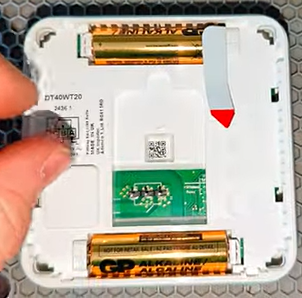

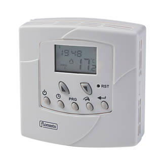

It’s not working as per the design of the thermostat. The green/yellow which should only really be used for cpc/earth isn’t insulated all the way through the cable so could be/cause a problem.Want a new stat as I know it does not always switch on when it gets cold, until its really cold even if I turn it up a bit, so new one needed and I read that a digital stat is more accurate and efficient than this T40
You could go for a 2 wire mechanical thermostat, a 2 wire battery operated thermostat, both of which would be better using the brown and blue wires as live and switched live and alter the other end. Your other option is to go for a wireless thermostat, but would recommend decommissioning the existing one.
Failing that you could run a new cable with enough cores to the existing thermostat or any other suitable thermostat
