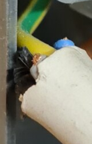

However, ..I suppose first to ask, is the earth being exposed a risk (as shown)? I imagine if it's earthing then it's safe anyway, but still seems dodge.
Either way, it would leave me with an earth, supposed switched live in 3 (or N), and a live in 1. Nothing for terminal 2.
It is wrong, but would normally be 'relatively' safe, however...
Whoever parked that grey wire in the 'stat at the other end is a plonker!
Currently, whenever the boiler isn't calling for heat, the end of that grey wire is live, with the posibility of shorting to the case, or the exposed earth:
As I said earlier, if the neutral is available near to this connection block, the grey could be reutilized as the neutral needed for the Hive.

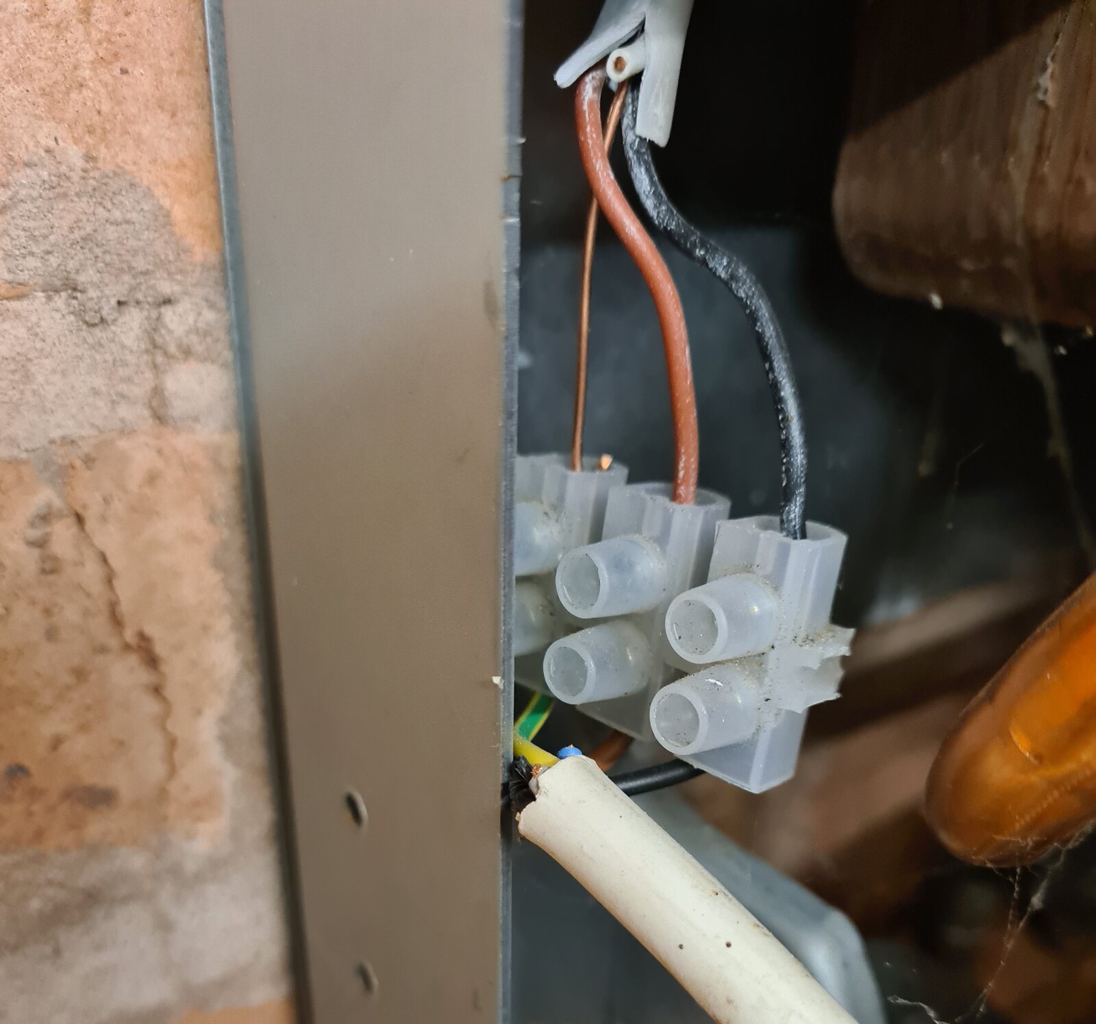

However, given the wiring we have seen so far, and these cut off cables:
I would say it's worth checking the connections in the service panel.
Although your boiler will need checking for safety by an RGI.
