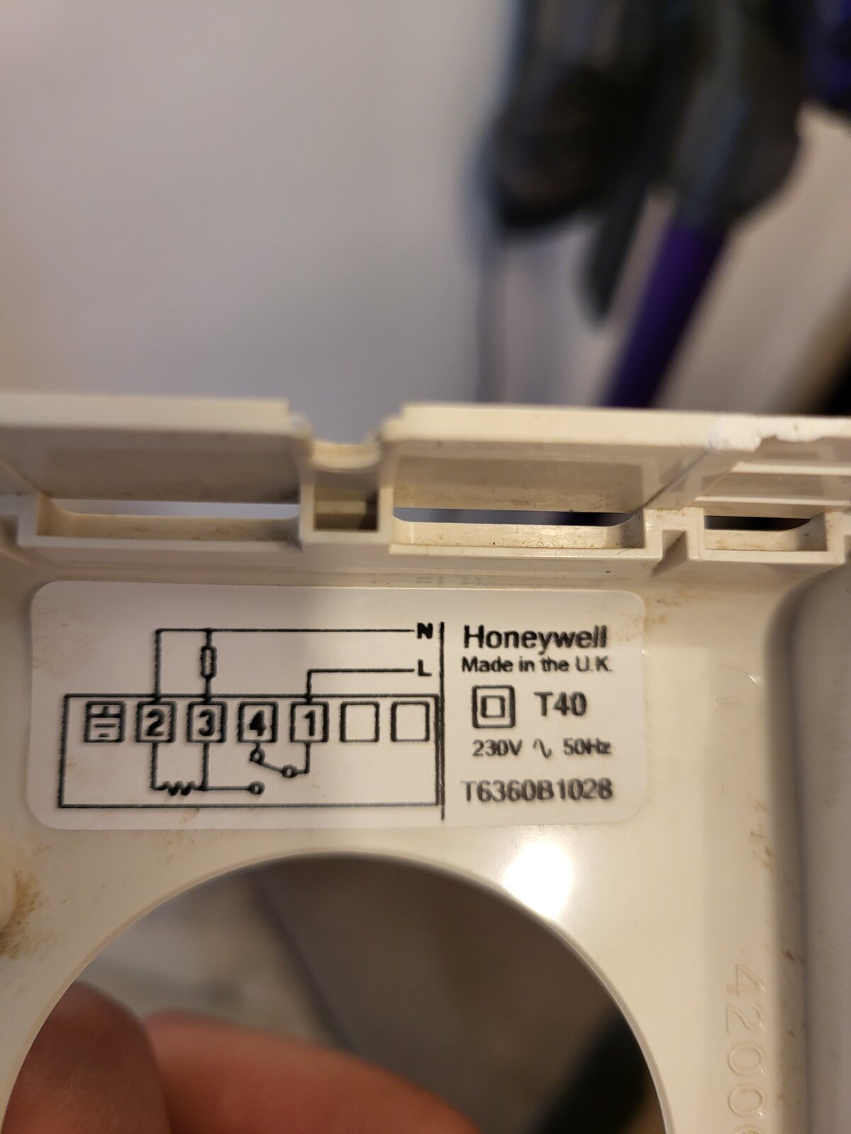

Hi all - I replaced my Honeywell T40 thermostat with my Nest thermostat when I moved. It. My boiler is upstairs and my Honeywell thermostat was in a closet downstairs.
I am thinking of removing the Honeywell thermostat as it is no longer needed. Question I have is, would the thermostat be wired directly into the boiler or would the thermostat be ‘wireless’ and draw its power from somewhere else?

The Honeywell is not wireless.
It might be wired direct to the boiler or to a valve.

If you said what type of boiler/system we can advise better.
With a combi likely direct to boiler, with a system likely to the motorised valve, but as @EFLImpudence says, why is it still there and in a cupboard, is it some frost protection or similar?
Note no connection to terminal 2, this means the switch on and off temperature have a huge difference, this can with some systems help, in the main room temperature is controlled by the TRV,s, however they have a problem, unless the water is circulating, they can't tell the boiler what to do, so we need a wall thermostat to turn off the boiler in the summer. And a large differential helps with that.
