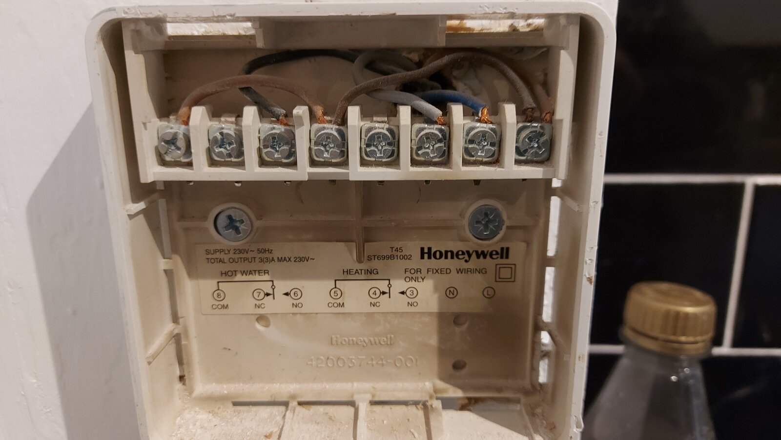

Hello,
My Honeywell T45 has stopped working and so I thought I'd replace it with a smart device. I have bought a Drayton Wiser unit and need to wire it in. Can anyone advise on how the wiring should go please?!
Additional info: I have a conventional Baxi boiler with a pressurised water tank. 2 valve (HW and CH) and there is a pump (which i replaced recently when the previous one died)
The house doesn't have a thermostat and I won't want to add one other than the TRV units.
I am happy to rewire the unit and install the new one, but just can't make head nor tail of the diagrams I have seen.
Which Wiser did you buy- the WT724R?
One irritant with the Wiser is that the common contact on both HW and CH is tied to 240v rather than being volt free. Do you have a multimeter- if so, check on your existing backplate that there is 240v between pin 8 and N and also between pin 5 and N.
Provided there is, it's a simple swap.
L goes to L on the Wiser.
N goes to N.
8 and 5 are redundant. Mark and make safe (terminal block) or remove if they're links to L.
6 (Honeywell) goes to 3 (wiser)
3 (Honeywell) goes to 4 (wiser)
You'll need to bridge out and remove any existing room thermostat (presumably you're using the room stat that comes with the hub) or just set the old one to 30 degrees.
Cylinder stat will still function.
Done.

So I've finally built up courage to have a go at this after much procrastination...
My multi meter shows 8 and N as being 240v but 5 and N being zero.
I knew it wouldn't be straightforward!
Did the heating work? If so, then could just be wired differently?
Yes. To clarify I've only checked the volts as suggested - on the basis if that info was correct for mine then I'd have a go. It wasn't so the old unit is still in place and I'm back to pondering...

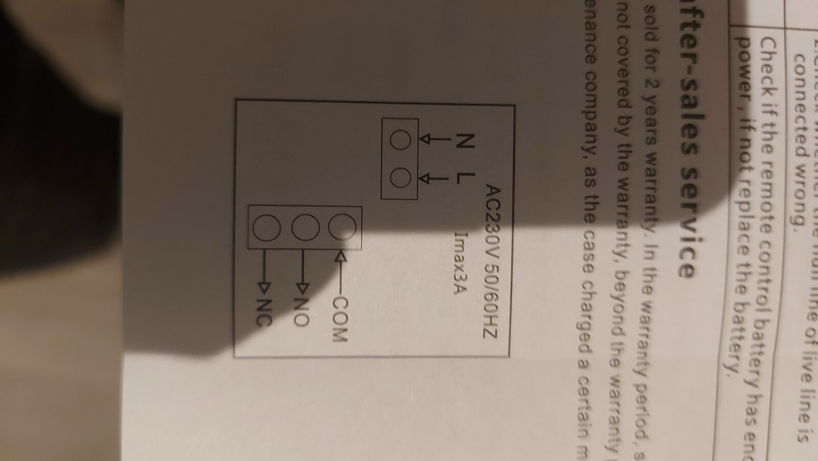

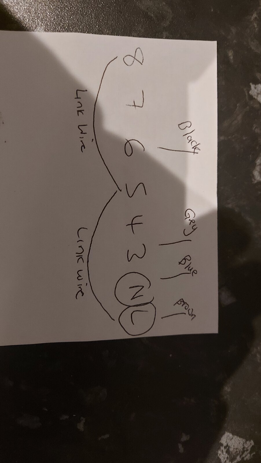

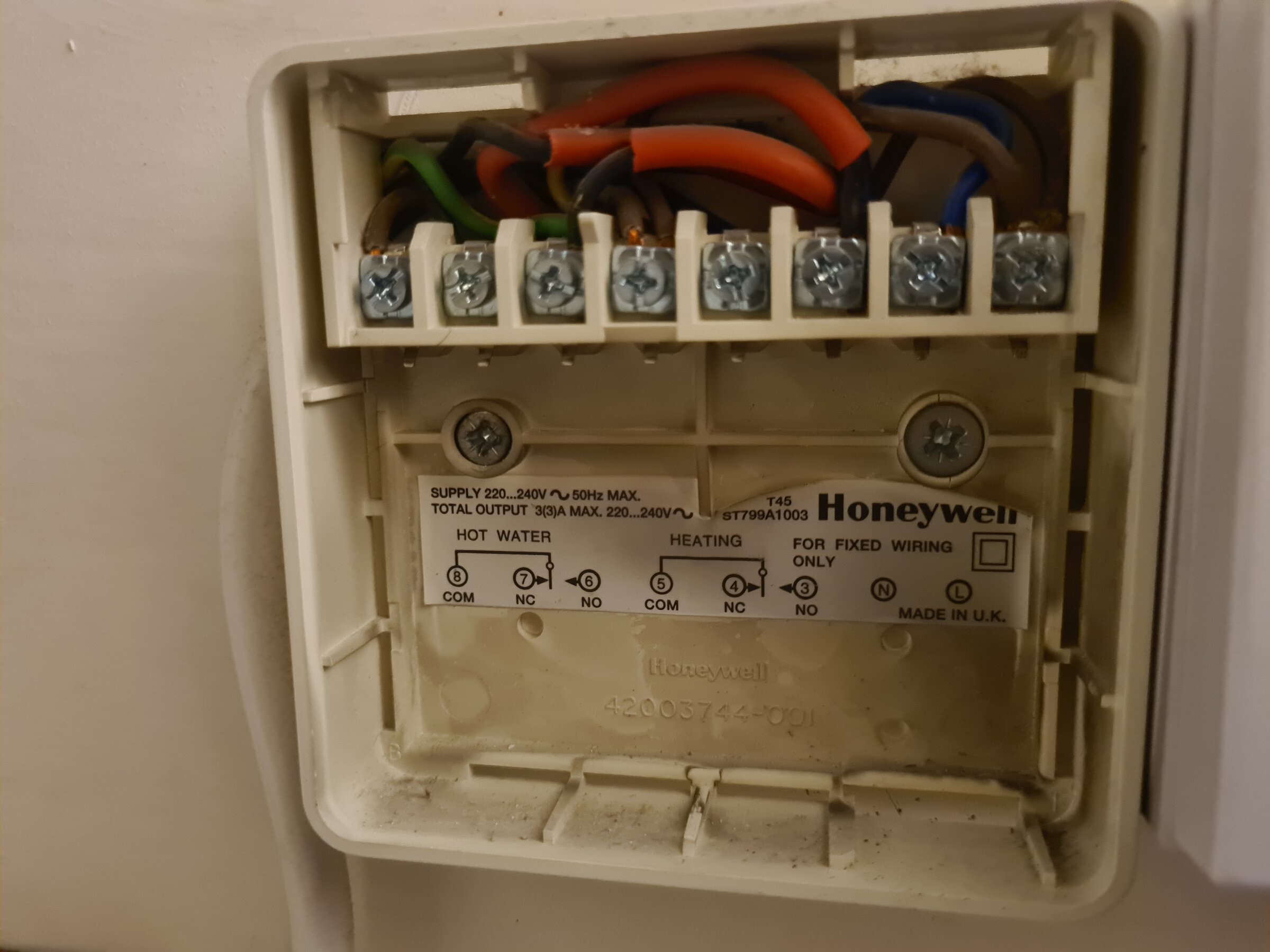

Sorry to resurrect an old thread, but I'm in this position, exact wiring but a different replacement thermostat and controller.
Wired up new controller as
Live to live
Neutral to neutral
Both black and grey to the NO connector
Removed the link wires as not needed.
Controller shows boiler should come on for heating but doesn't, I have a room thermostat set to lowest, would that be a possible cause (Didn't think to try when I wired in the new controller)
I've put it all back to how it was now.

Right, so wired wrong, and hijacked a thread that’s different thermostat. You don’t appear to have a common and if you’re leaving in the previously used thermostat- this needs to be set to max.
