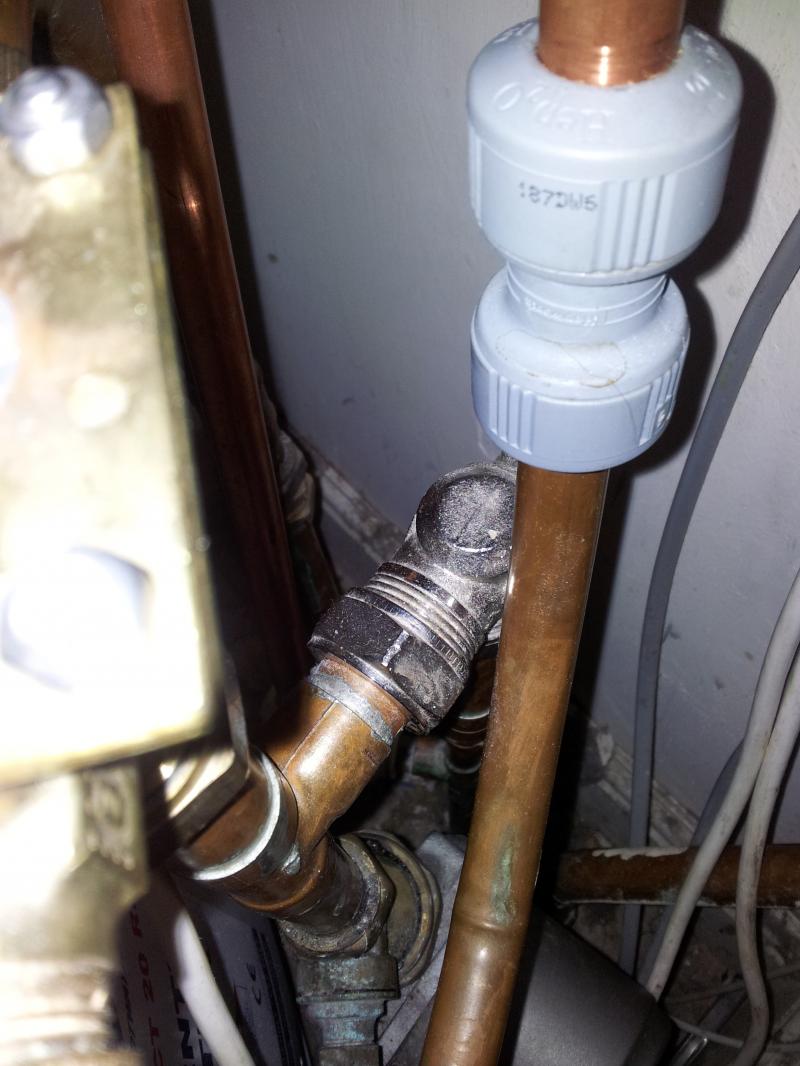

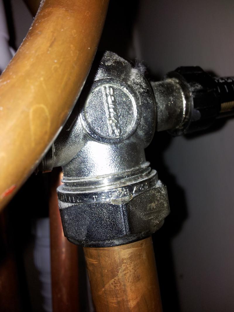

Honeywell V4073A Valve and 3 way port
Click on the image - it will enlarge in a new window[/quote]
Or do you want to see something other than the two pictures I've posted?
Yes i've done that but want to see more of the pipework around the valve area.

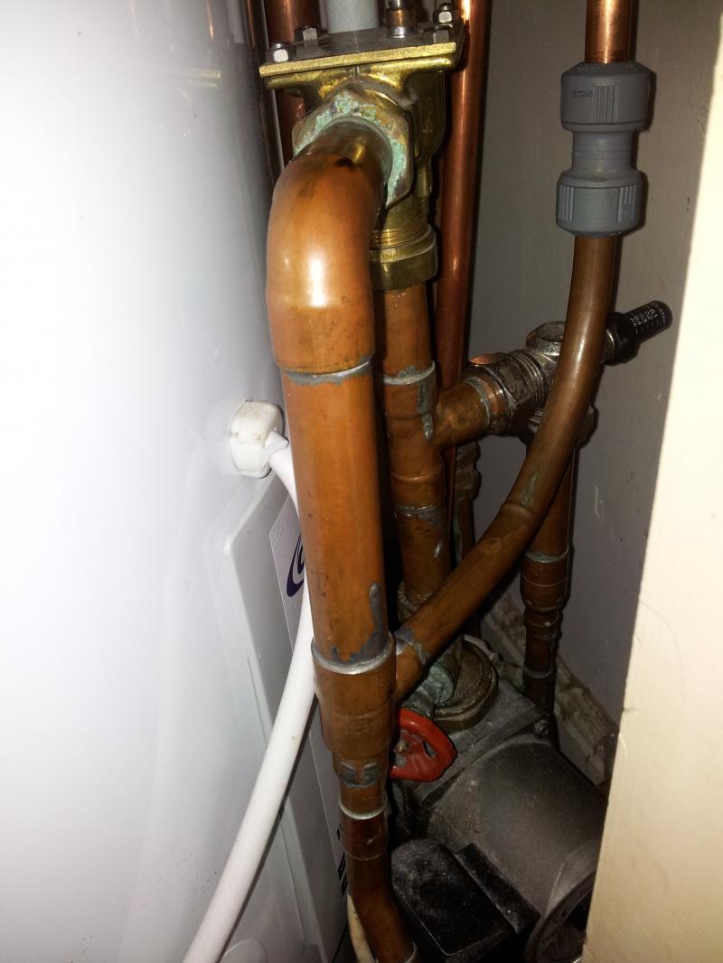

I can see the rad side go's down, thats it.
I still think you have an airlock around the valve. :idea:
I'd be inclined to slacken a valve nut to release any air if any.

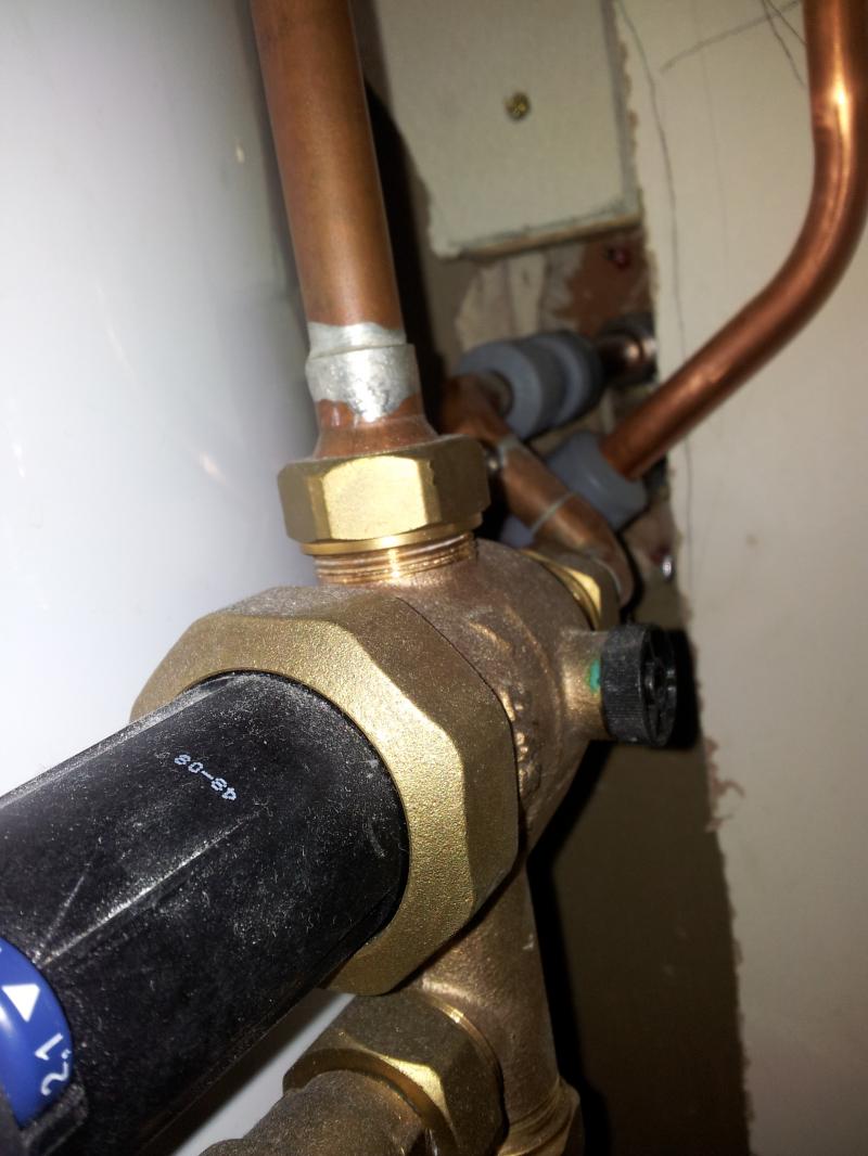

Sorry, I was taking these and uploading while you replied.
Hang on- I'll go and take some more
Looking at the valve both pipes to cyl/rads come out and go downwards.
you have no where for air to escape.

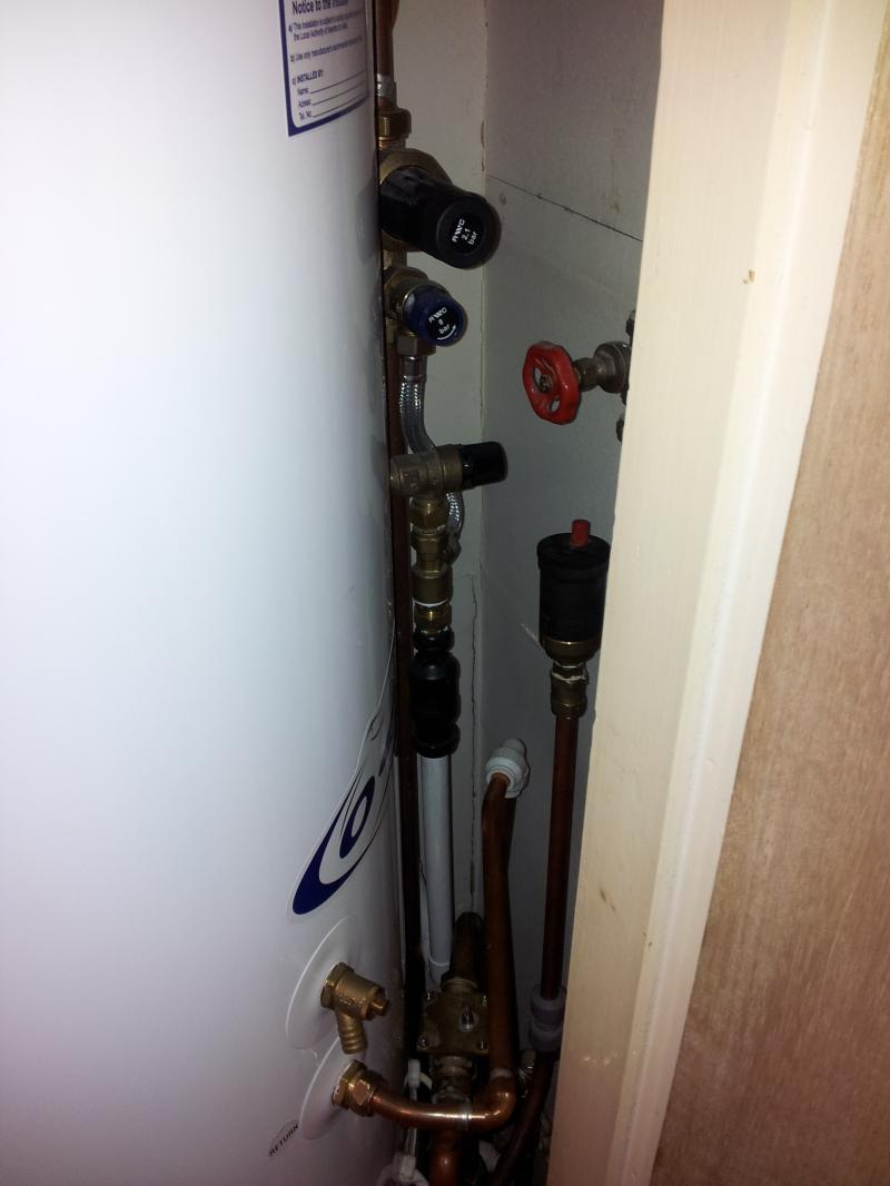

you could have a blocked cold feed, (not enough water in the system), do you have any manual vents in the airing cupboard (thumb vents)??
Not sure about the thumb vents. How would I tell?
Thumbscrew vent.
hate them things,always blockup,leak,thumb screw more like stillsons
Sorry about the pump :oops:
Not sure whether there's a 2 port valve - things are pretty tight in there!
I have, as suggested, loosened the nuts around the T valve and some air did escape. I now have very hot water flowing from both sides of the valve although, as yet, I have no warmth in any of the rads - suggest that's a daytime job along with balancing the system and bleeding the rads.
Thanks for all your help and suggestions so far today
Andy
"how are you sure it is working?"
When I put my hand around it I can feel the blades whirring around inside and can hear the water being pushed along the pipes.
The water is also now flowing reasonably well
