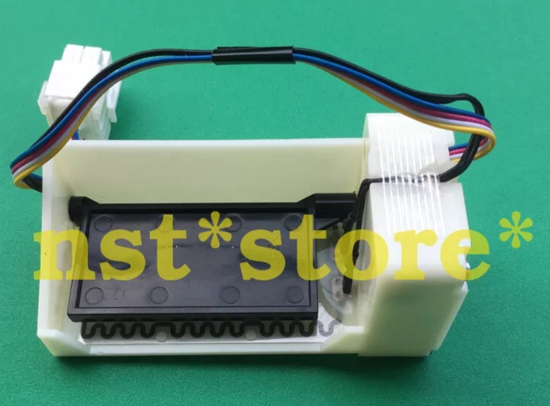

I have taken a picture from online to show what the damper motor looks like. It's like a door opens and closes. I noticed there are black wires running around it I'm assuming they get hot or warm so ice doesn't build up???
I plugged mine in and touched the wires they were not getting hot is this the reason why ice is
building up, should these wires be getting hot?
