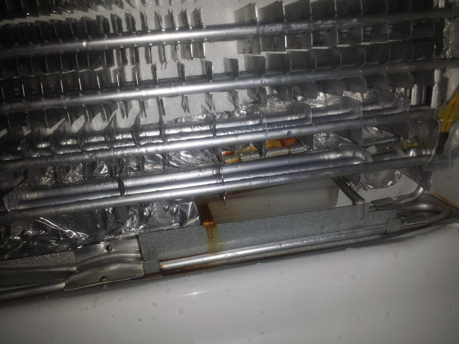

Ok, my trust Samsung fridge/freezer is having a fridge temp issue,
It is a Samsung RL39WB. Here is the service manual.
Now, the fridge has run perfectly for years. But, last week I left the freezer door open for a few hours by accident.
After closing it, I noticed the fridge was no longer cooling.
Having repaired the fan before, I suspected the exchanger was all iced up at the back and I assumed to be impacting airflow.
And it was fairly compacted with ice, nothing extreme, but I defrosted it and put it back together but....no go. Still a warm fridge and a cold freezer.
I have since checked the fan, damper operation and fridge thermostat. All of which seem to be operating normally.
I get a multimeter resistance reading on the thermostat (6.5kohms?) which rises when I introduce something cold to the end.
I can see the damper spinning and being static when trying to regulate the two.
Fan spins normally and I can feel good airflow out of the vents in the freezer.
What I can't feel however is airflow into the fridge vents. Nothing at all. Even when the damper is open/spinning it seems.
So.....what am I left to consider?
Ice blockage in the fridge ducting?
(Would that not have eventually melted once back to normal operation with the door closed?).
Fan motor spinning....but not fast enough?

Did you notice any clicking when opening door ? When door is open the fan cuts out and if obstructed by ice can make a noise as it stops.
I can hear relays clicking when I open the door. The fan runs fine, no catching on ice. I can feel airflow in the freezer section. I can also see the damper rotating or staying in close and/or open position.
Freezer is staying perfectly cold. No over-icing/build-up.
It's looking like a slow defrost is needed to perhaps exclude the ducts to the fridge.

Finally had a chance to do a full 24hr defrost and trace all the vent paths using strimmer wire and a hair dryer to do a vent test.
I traced the problem to the return vent from the fridge to the freezer. The strimmer wire was getting stuck on something cold.
Turns out it was compacted with ice. The outlet was only visible after a full defrost. Even after 24 hrs was ice compacted in it. I mist have missed it on the first defrost.
That tiny plastic slot.
Teaches me for leaving the door open by accident.
Hopefully now I will get the proper flow of air between the two compartments.
