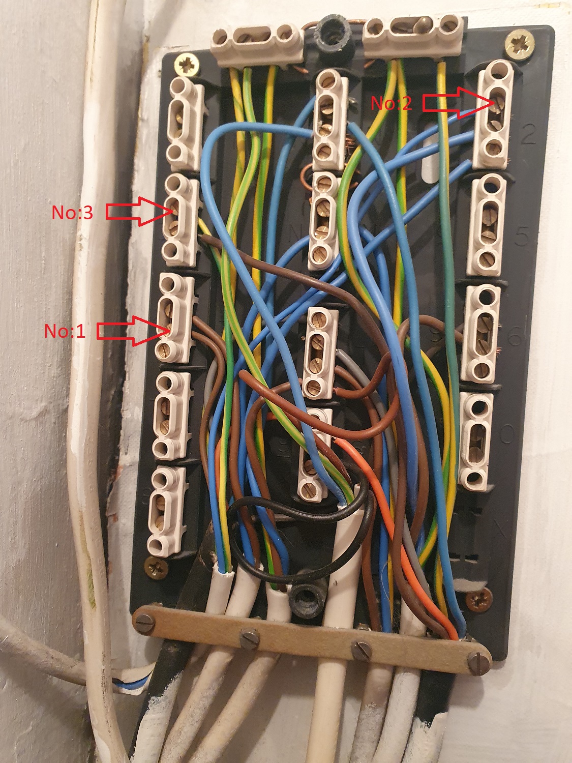

I'm trying to replace my old Horstmann HRT2 with HRT3, the wiring out of the wall is brown to no1, blue to no2 ,earth to no3 nothing in no4. I'm hoping someone can tell me how to wire the new one up I have no diagrams.
You need to check the wiring. The existing stat appears to be connected incorrectly, and or is using the earth wire as a switched live which is not permitted, the manual also says not to use terminal 2. If you only have 2 wires and earth, the HRT2 and HRT3 models are not suitable as they require a neutral to work properly.

OK so I finally got to the main box its a Wirerite wiring unit. I have attached a photo of the inside and marked the wires from the room stat This was done some thirty years ago and I cant find a wiring diagram for this unit. And it looks like the earth is used for something else.
Probably been used as a switched live which is frowned upon, and against regulations, but unfortunately common place these days.
