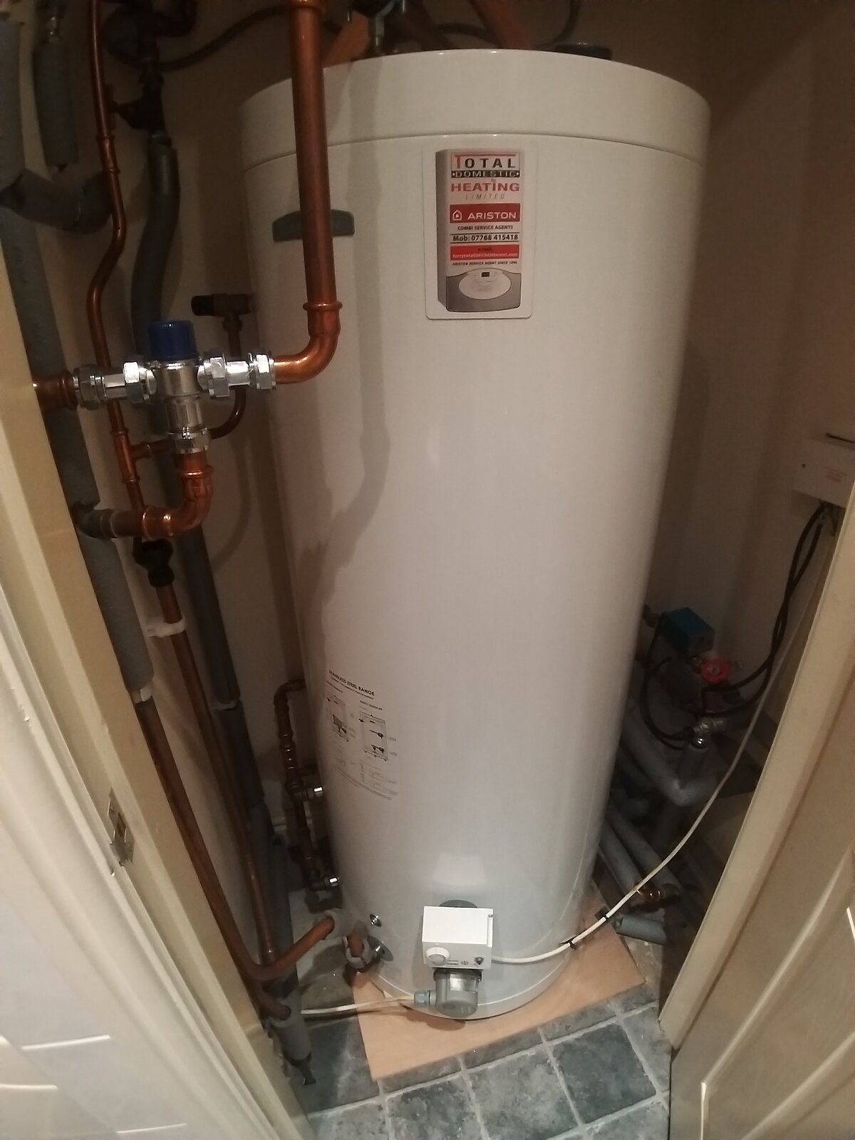

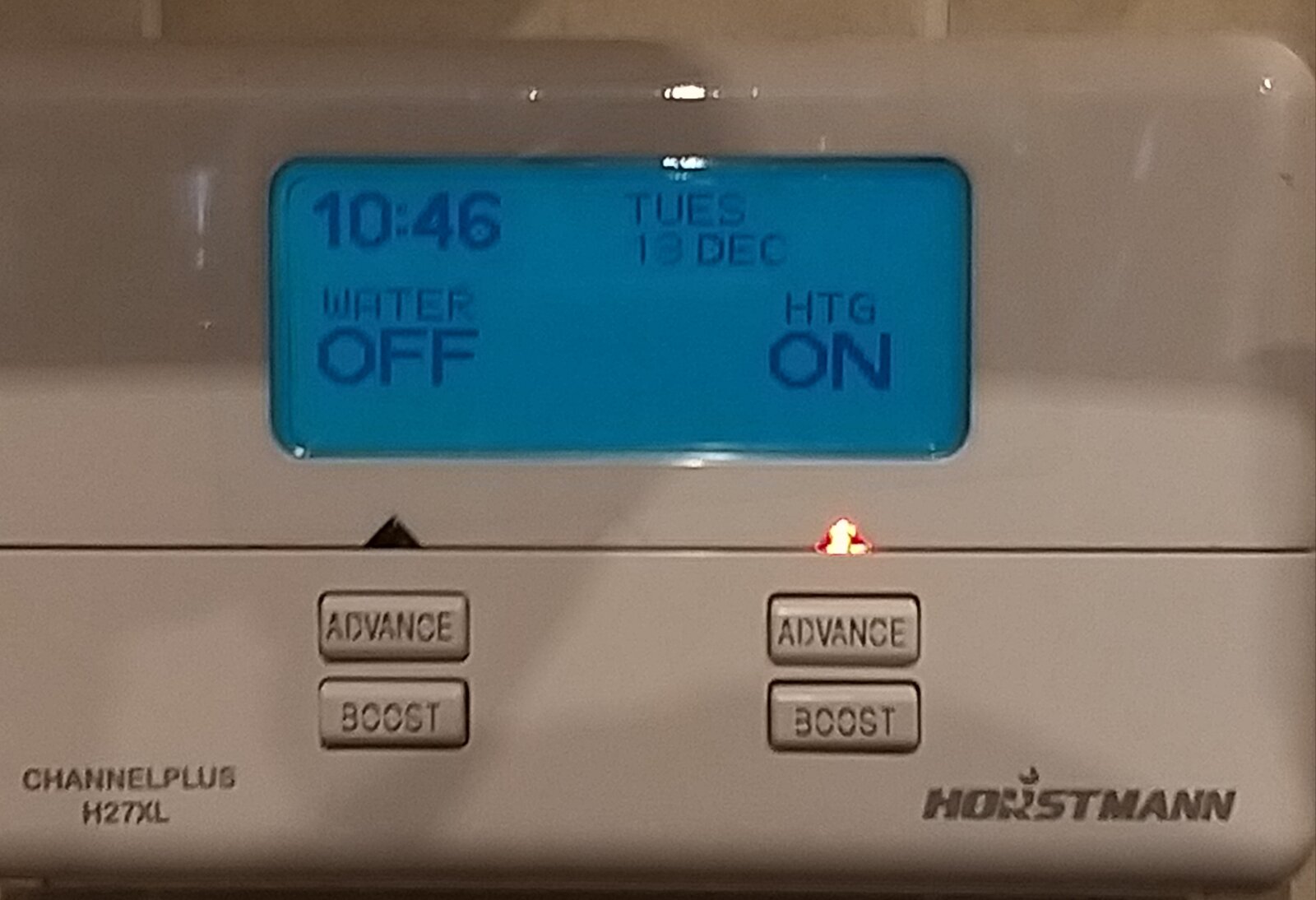

Hot water and central heating only work together, on full blast, or not at all
Controller

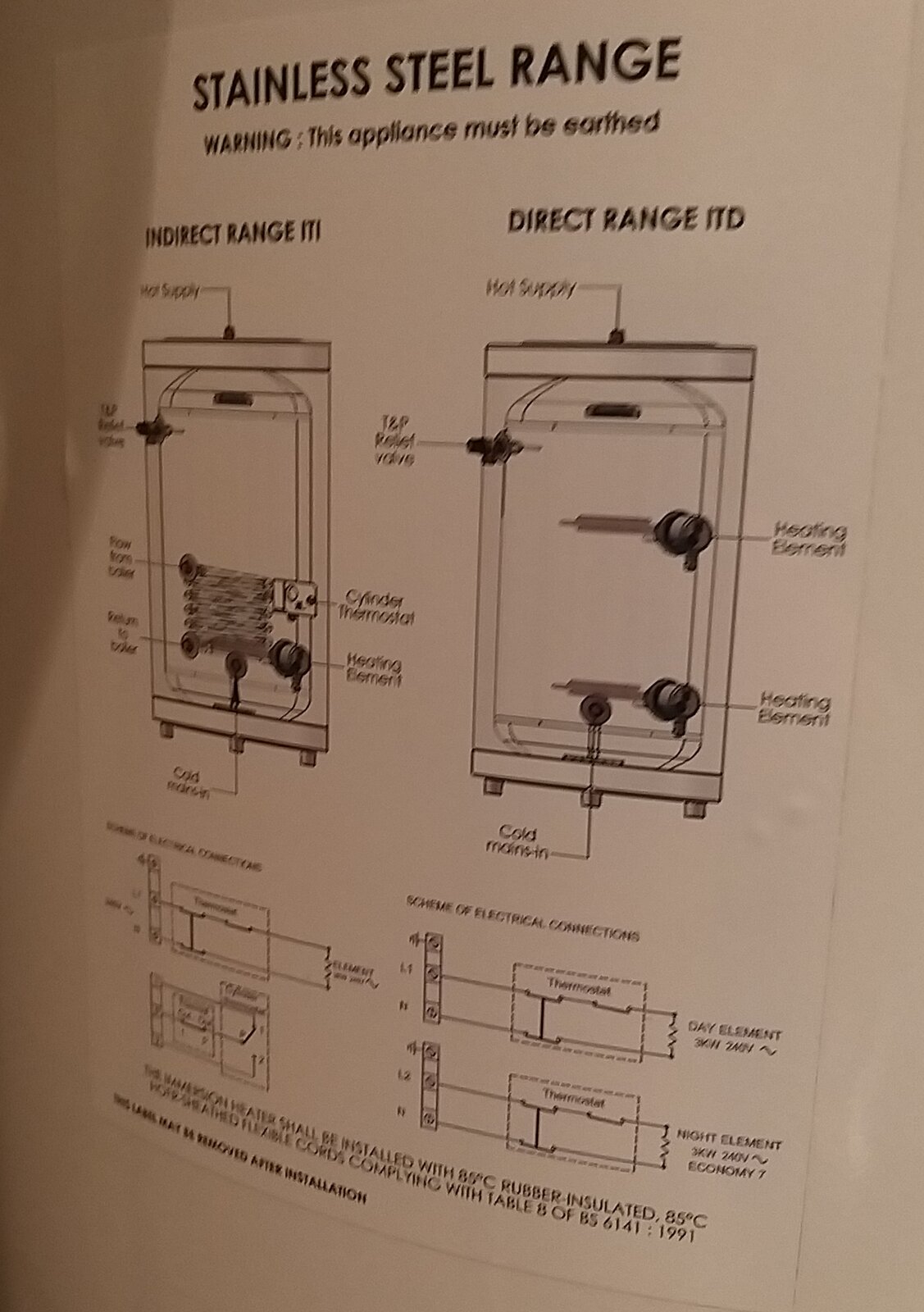

Diagram of tank. Mine is the one on the left.

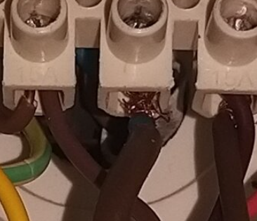

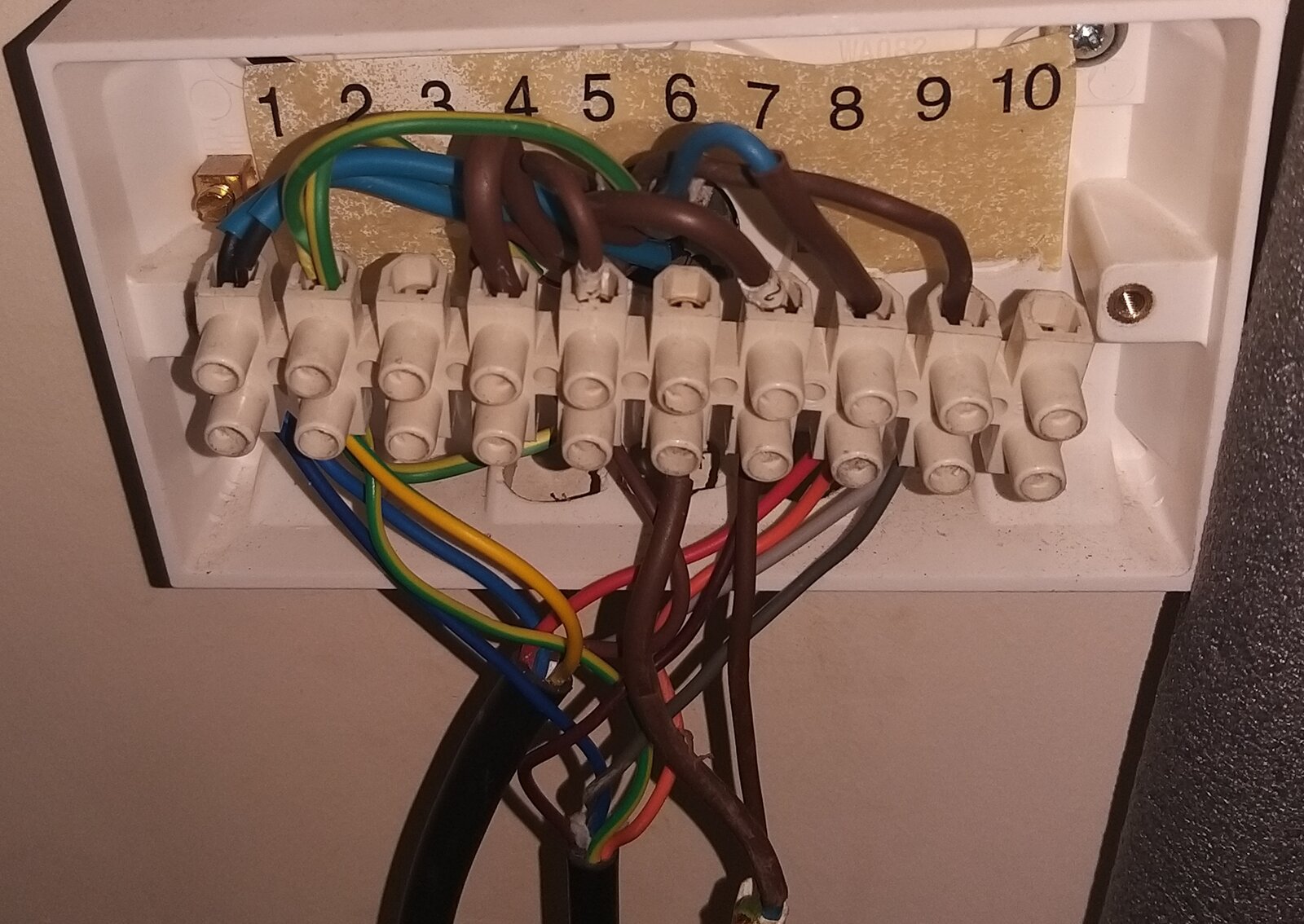

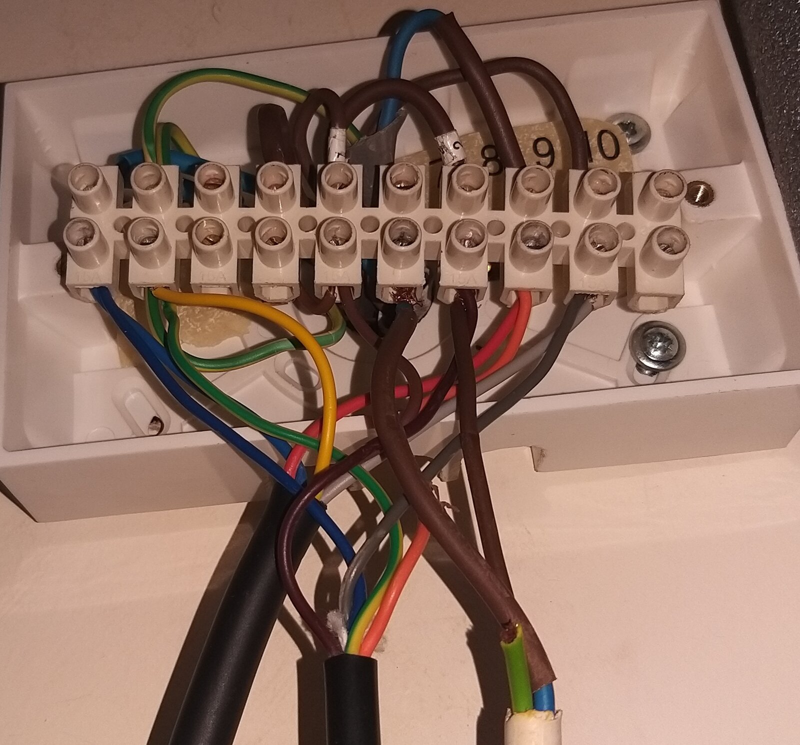

This is extremely poor electrical workmanship (but typical of a plumber lol) and liable to failure or worse.
It would be best to power down and redo this connection.

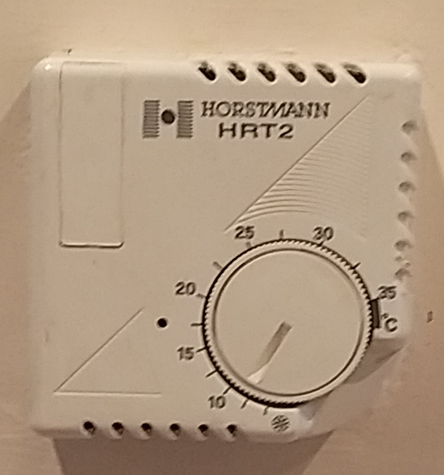

Well pointed out thank you! That might be the issue for the stat
I think this issue has been/will be resolved.

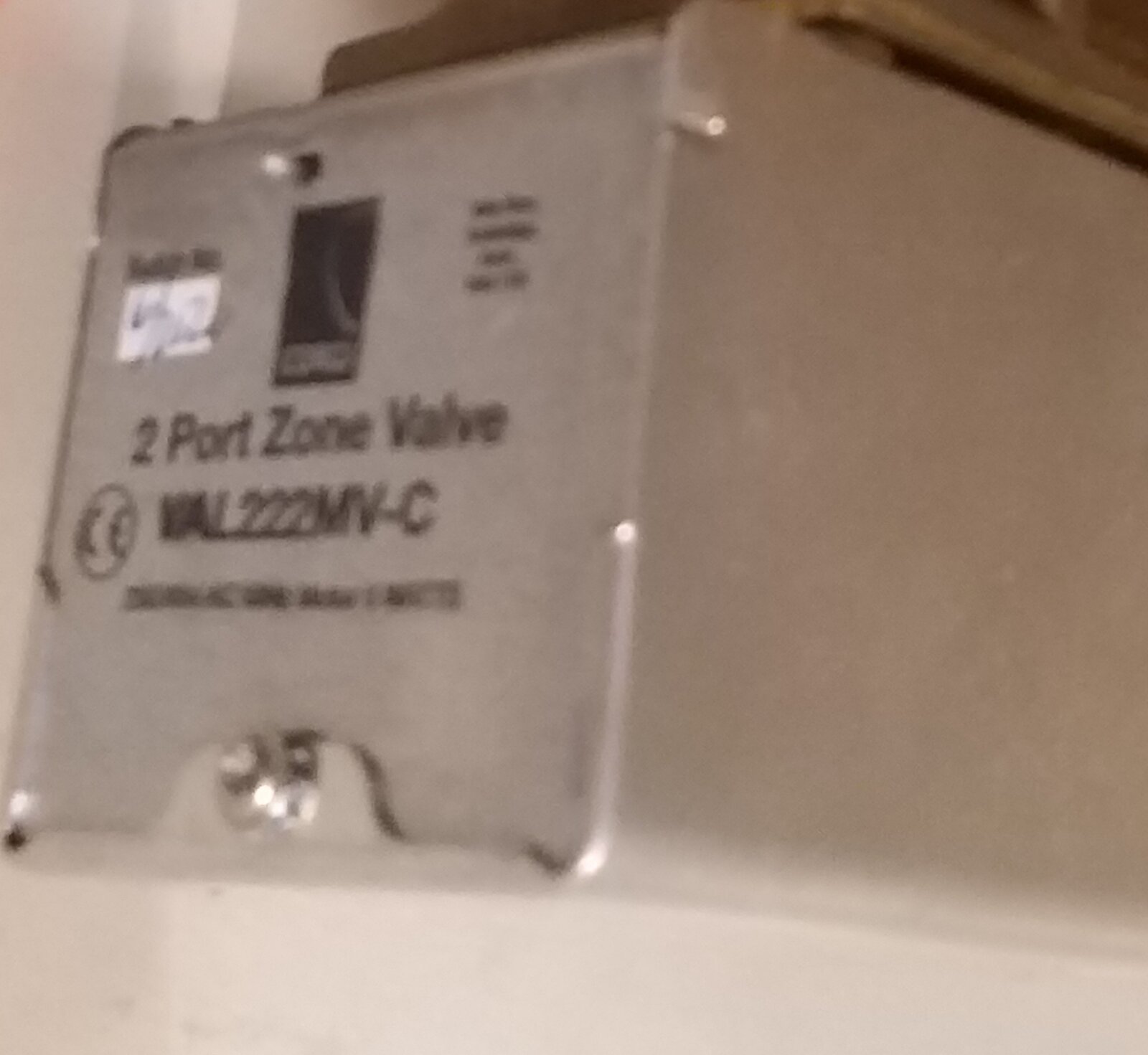

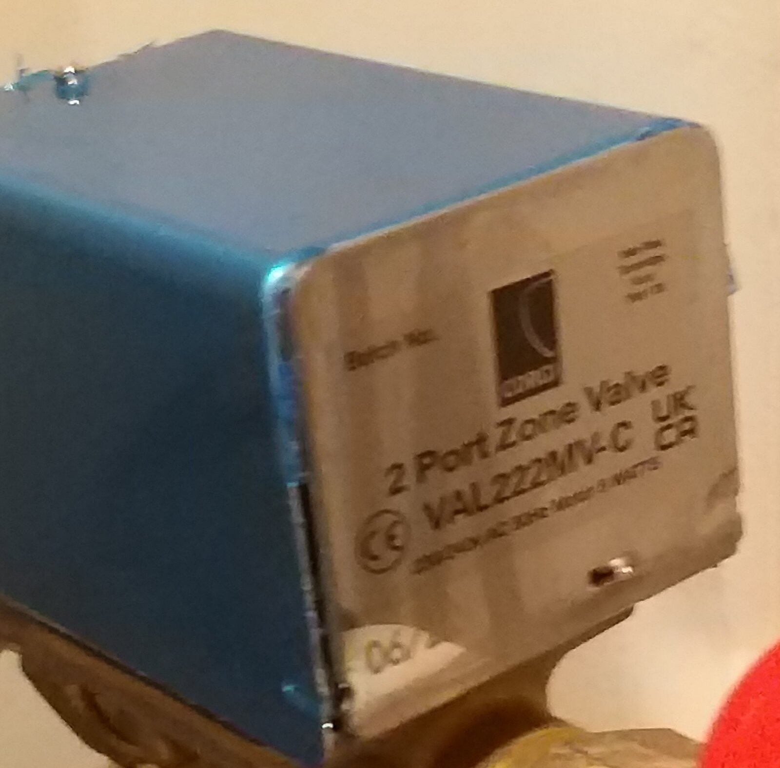

He's going to come round and replace the other valve tomorrow, and I'm going to get a sparky in to fit a a smart stat. All should be working perfectly after that.

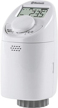

Lock Shield valve adjusts the speed at which the radiator heats up, too fast and there is not enough time for the TRV to close, so it over shoots, and you get a hysteresis. In the start we set lock shield so there is around 15°C drop across the radiator, and with mechanical TRV's marked *123456 the 20°C point is normally between 2 and 3. Easier with digital types, EQ-3 Bluetooth Smart Radiator Thermostat.jpgset this type to 20°C and you then only worry about the lock shield valve setting, and also you can program them to change temperature throughout the week.

I open google home with my phone, and there are 5 thermostats shown, the Nest Gen 3 wall thermostats and 4 Energenie room TRV's but I have 9 programmable TRV's the other 5 are bluetooth, (eQ-3) and can only connect to one phone, but only cost me £15 in 2019, rather than £35 for the energenie.
