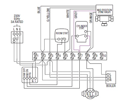

Having a hot water issue.
Y plan boiler system. Hot water cylinder stat does not seem to work corrrectly.
It does click when adjusted with but seems to be extremely hot for 60 degrees.
The main issue im having though is it doesnt seem to turn the boiler off when temp is reached. I pressume it should turn it off regardless of timer setting?
Recently changed timer comtrols to a Nest however i do not think this is related as i dont think it ever worked as intended.
Any help appreciated.
