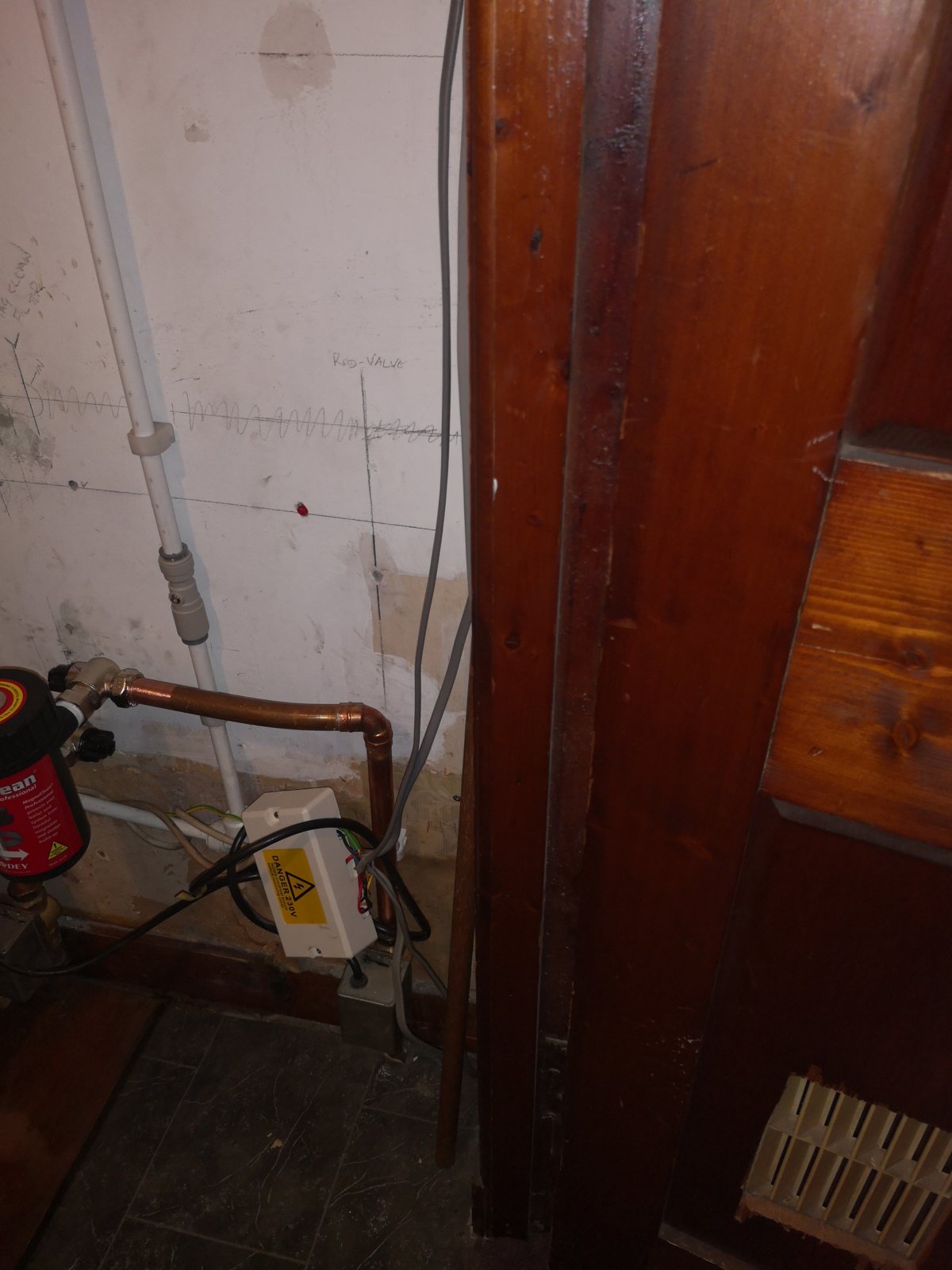

I have a gravity feed system, have just fitted a adey Magna clean in-between my zone valve as no access to return pipe to boiler.

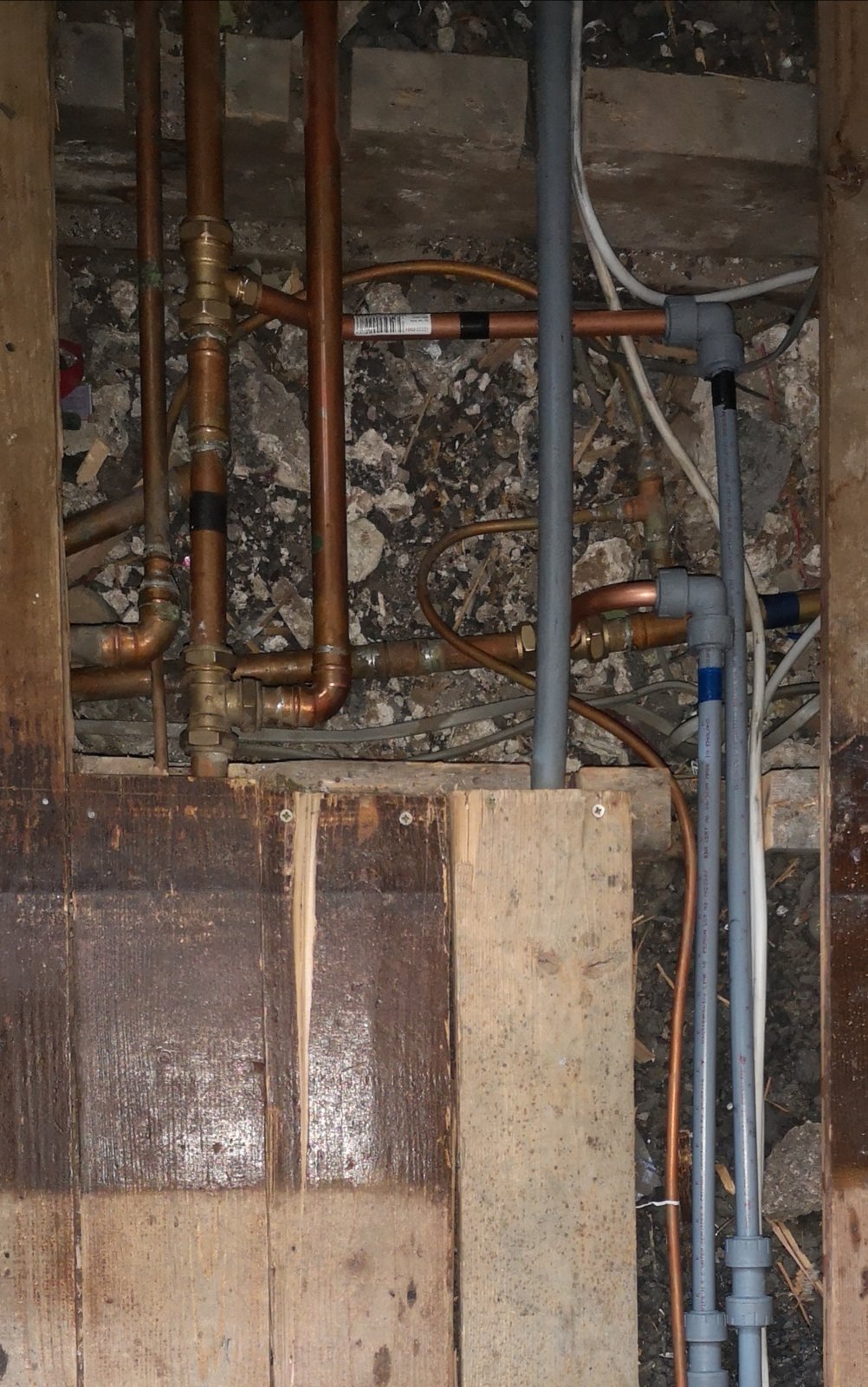

When heating is on could water be flowing into the hot water side and increasing the water temp even though there is no demand on hot water.
Or could this radiator possibly cause an issue. Traced pipes taped flow with blue tape and return with black tape.

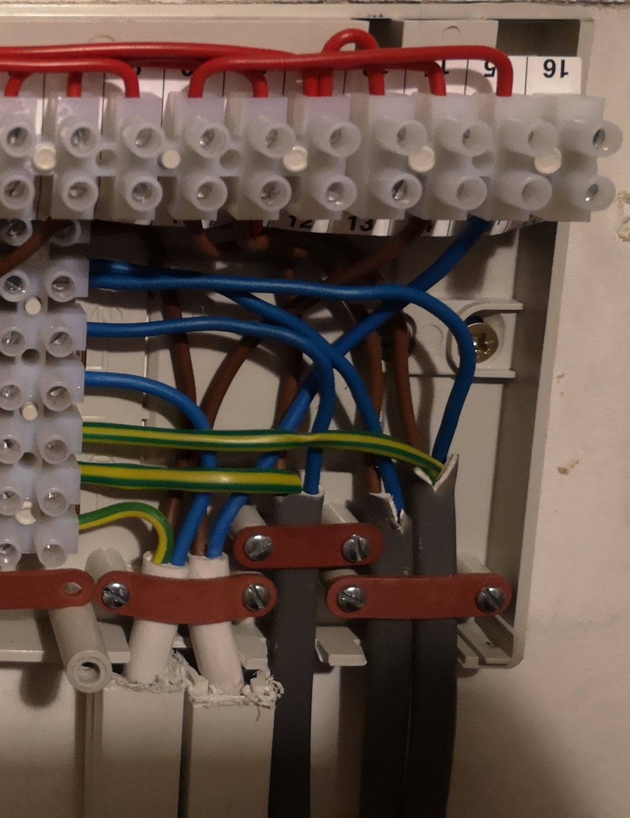

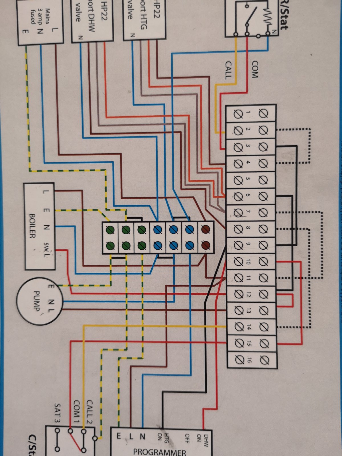

Have you perhaps wired the stat using the wrong terminals on the stat? So instead of switching the demand off, its switching demand on as the temperature in the tank increases..
Cylinder stat is a honeywell has positions.
C - which I have a brown wire attached to and goes to terminal 14
Com - which I have a blue wire attached to terminal 15 as per schematic picture
The 2 white flex is the connection for cyl stat.

Post a photo of cylinder stat attached to cylinder.
It will show us where on the cylinder it’s located and if it’s installed as it should be, eg touching the cylinder and not the insulation, but you can just check this if you wish.
Ah, ok.
I thought you meant both went to the cylinder stat,
and on closer look I have mistaken which brown is which. Sorry.
