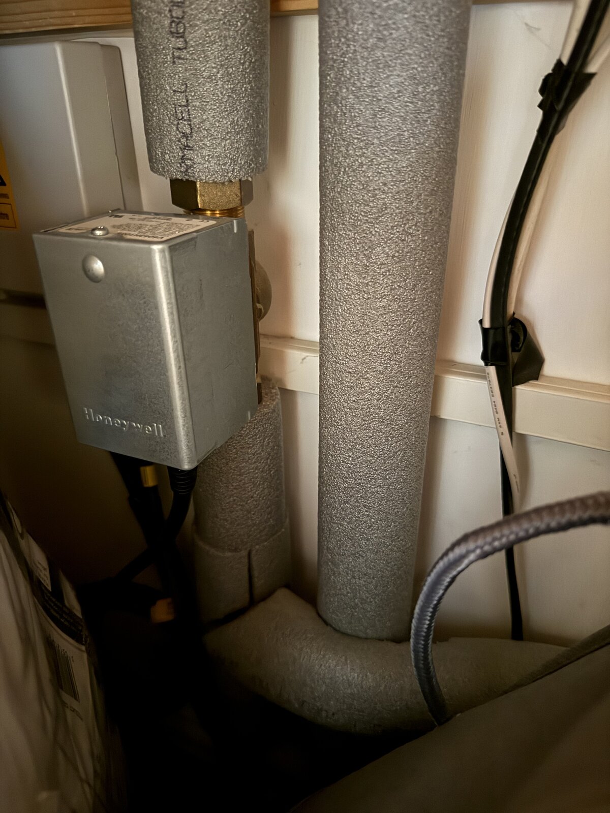

I can’t seem to get to the bottom of an ongoing issue in our house and was hoping for some help.

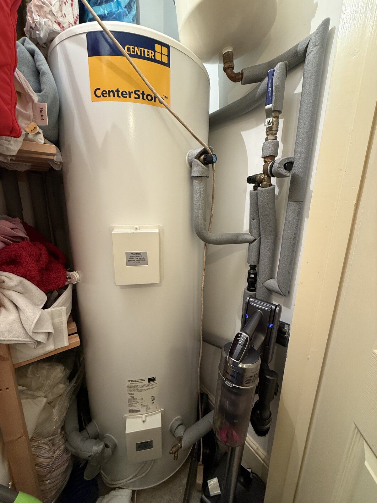

I have a 4 bed, built in 2013. We have a gas boiler and an indirect 250L water cylinder in an airing cupboard, controlled by Tado and gas central heating. Both recently serviced and seem fine. (Photos below)
We have always had the hot water on for 90 mins in the morning, kicking in 530am 30 mins before we shower and again in the evening at 5pm. Over the last 6 weeks or so I’ve noticed a lack of hot water during the day; so if I go to wash some stuff up at 3pm there’s often tepid or cold water. Equally the other morning I was up at 5am and the water was freezing cold. The night before the had barely been any hot water used (in fact the kids didn’t even shower that night) so I find it crazy that there was no hot water. Another example is today it came on for 90 mins this morning, we had two short showers , I've just gone to wash something up at 2pm and there's no hot water left.
The only thing running overnight is a new dishwasher, but surely that just uses cold water?
Some might say that we are possibly using more water than we realise, but we are in the same routine, if anything using slightly less since our kids now shower rather than bath.
To offset it I’ve been having the hot water come on for an hour during the afternoon, but this seems like a waste of money since it heats it at an expense but then seems like it does stay around.
To make matters more confusing, we appear to be using around double the gas for the same time last year. As an example in Sept 24 we used 159kw gas, Sept 25 it is 573kw. I think the months were comparable, we didn’t have the heating on so it’s crazy for it to be so much more.

When the hot water is on, it is hot as expected. Not sure if this makes a difference but we have noticed the cold tap takes longer to give cold drinking water.

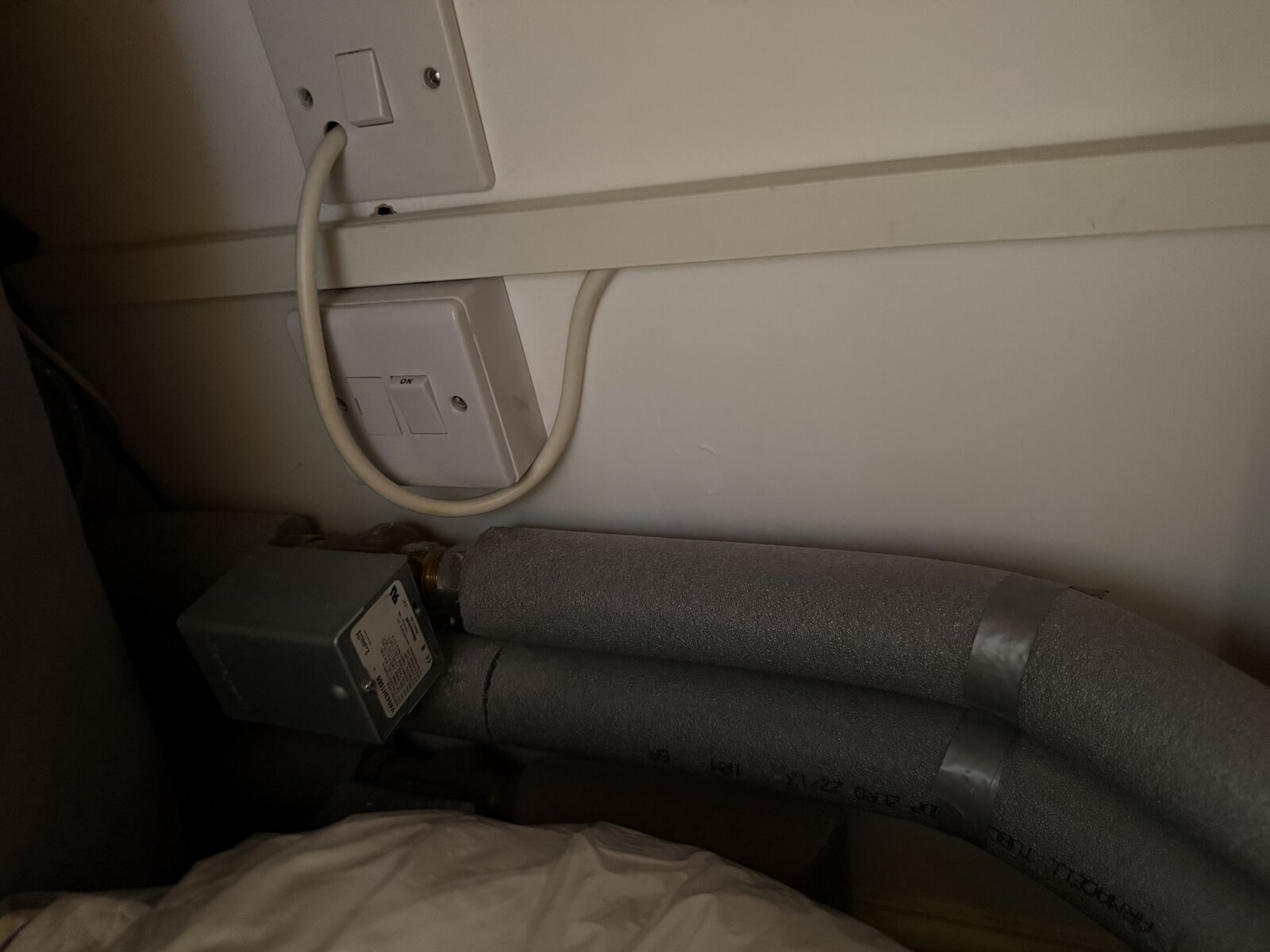

I can’t fathom what’s going on. My only assumption is maybe the water cylinder isn’t keeping the water hot, hence the big usage when the hot water kicks in. But the plumber said everything looked and seemed fine. Perhaps it's something to do with the two electrical switches on the wall?
Would love any advice, things to try, etc. I’d really not be having to pay for so much more gas, when we aren’t using anymore hot water than last year.
Thank you.

You have a well insulated, large cylinder. If it is going cold in less than a day, the hot water must be being used or leaking. Feel the pipes coming out of it. When you run a hot tap, the pipe feeding it will get hot. When you turn the tap off it will go cold. When you have not used any hot water for half an hour, and the boiler is not running, all the pipes should be at room temperature. Including the ones to the boiler and the radiators. Are they?
Do you by any chance have two bathrooms, or a bathroom a long way from the cylinder?
Feel the pump. Is it running?

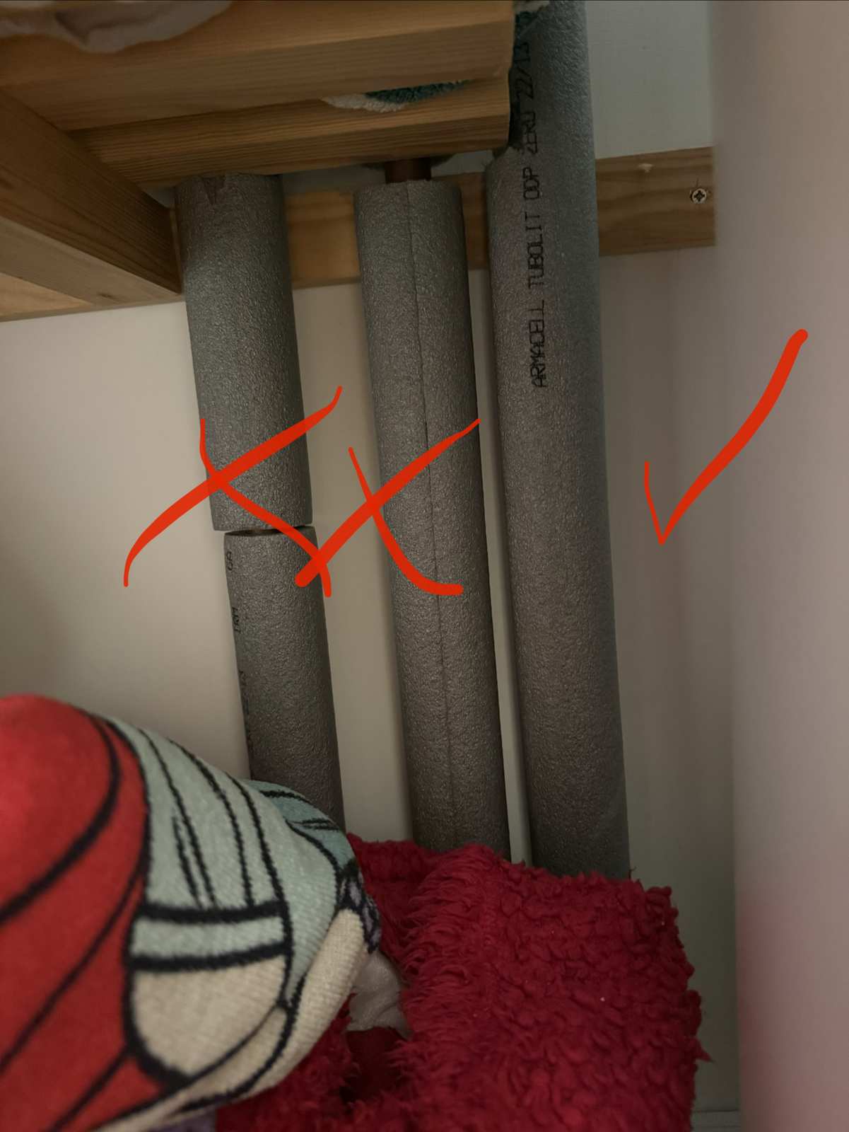

Thank you, yes it's going cold in a matter of hours, which isn't a good sign. There's no obvious leaks that I can spot, but there's a concern there might be something underneath us.

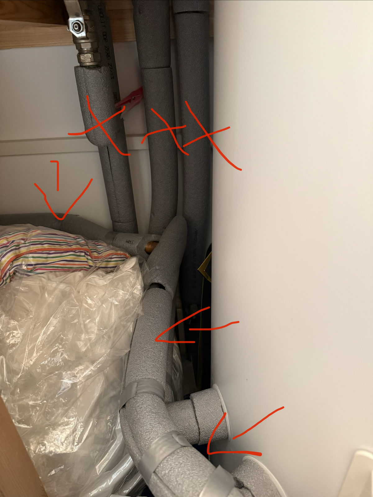

Everything is off at the moment, the cold water pipes feel very cold, the other pipes all feel room temp. I've just put the hot water on, and the bottom two pipes are warm (ones with the red arrows). After ten mins I still don't have hot water in my taps, will wait another 10 mins and let you know.
We have two bathrooms, both upstairs, on almost directly above the cylinder, one a little further away, but the second one is not used that often.

Have had the hot water running for 30 mins now and it's warmer coming out the tap (not as hot as it normally is but getting there), the bottom two pipes are still hot and the pipe out the top feels hot when running the hot water tap.

Another further update - the right hand side pipe is now hot

I take it thats a unvented cylinder, if so, post the expansion vessel capacity, once this is known we can calculate the vol of (hot) water that should flow from any HW tap, shut the cold mains to the UVC, then open a hot tap and measure this vol of water, again open the cold mains for a few minutes, then shut it, ensure no one draws off any water, hot or cold, for 30 minutes or so then open a hot tap and measure this volume again, this will give some indication of any leaks etc.
