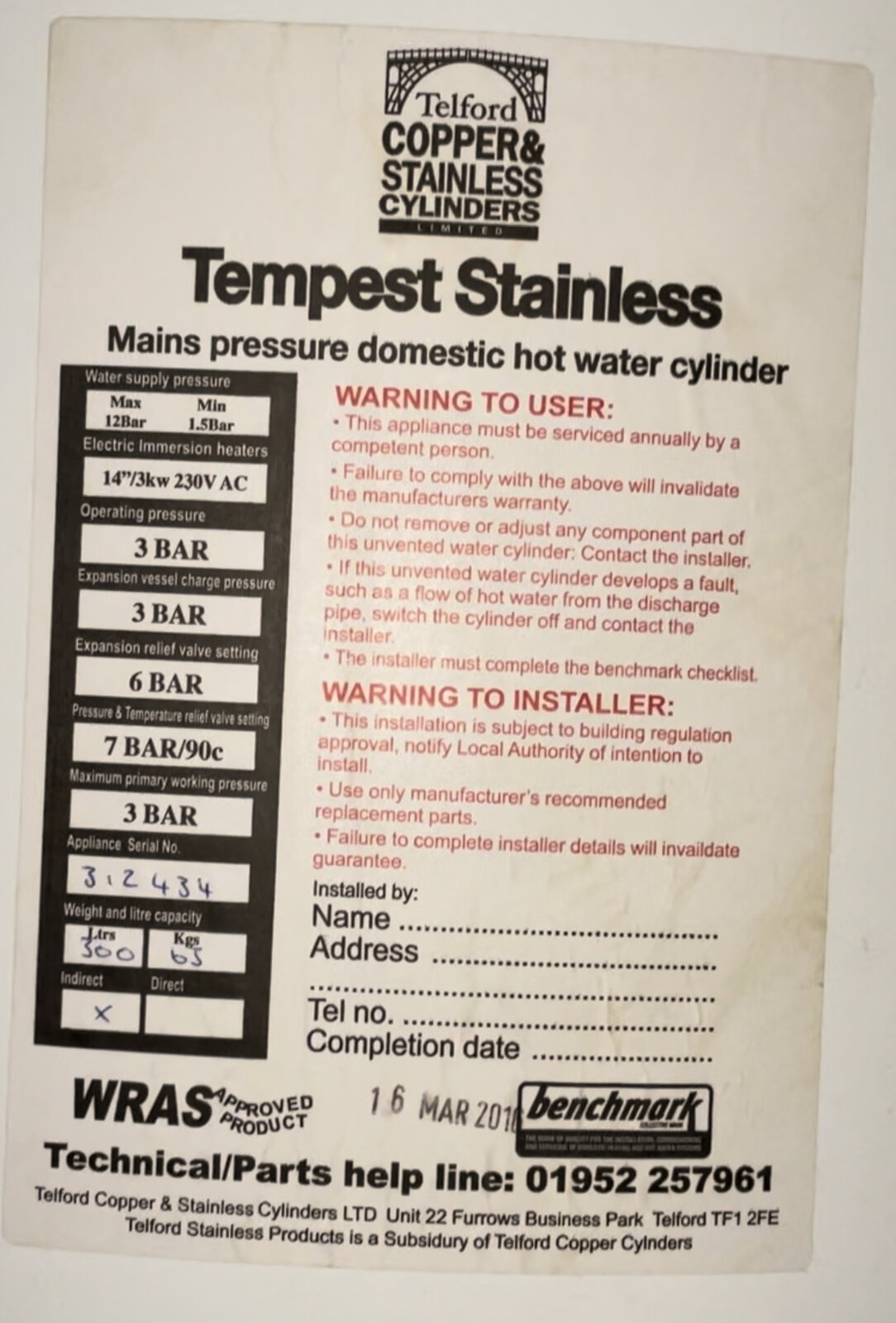

I've an ASHP that heats my DHW and the setup hs been the same for many years now. The tank typically runs to cooo before being heated
A recent observation I've made, that I have no recollection of occurring in the past, is that when the DHW has been on for a while if I open the kitchen hot tap, it seems the hot water is under slightly higher pressure - the "hiss" from the aerator spout is slightly louder and the water stream slightly wider. It settles down to what I recognise as "normal" (roughly equivalent to the hiss from the cold flow) after a few seconds
I ask in case there is some pressure relief or expansion vessel type affair associated with the potable side that may have a problem, and warming the water generates excess pressure that has nowhere to go. The CH side has an external EV but I don't recall seeing anything similar for the HW potable side (before the whole affair was buried behind a refrigerator)
