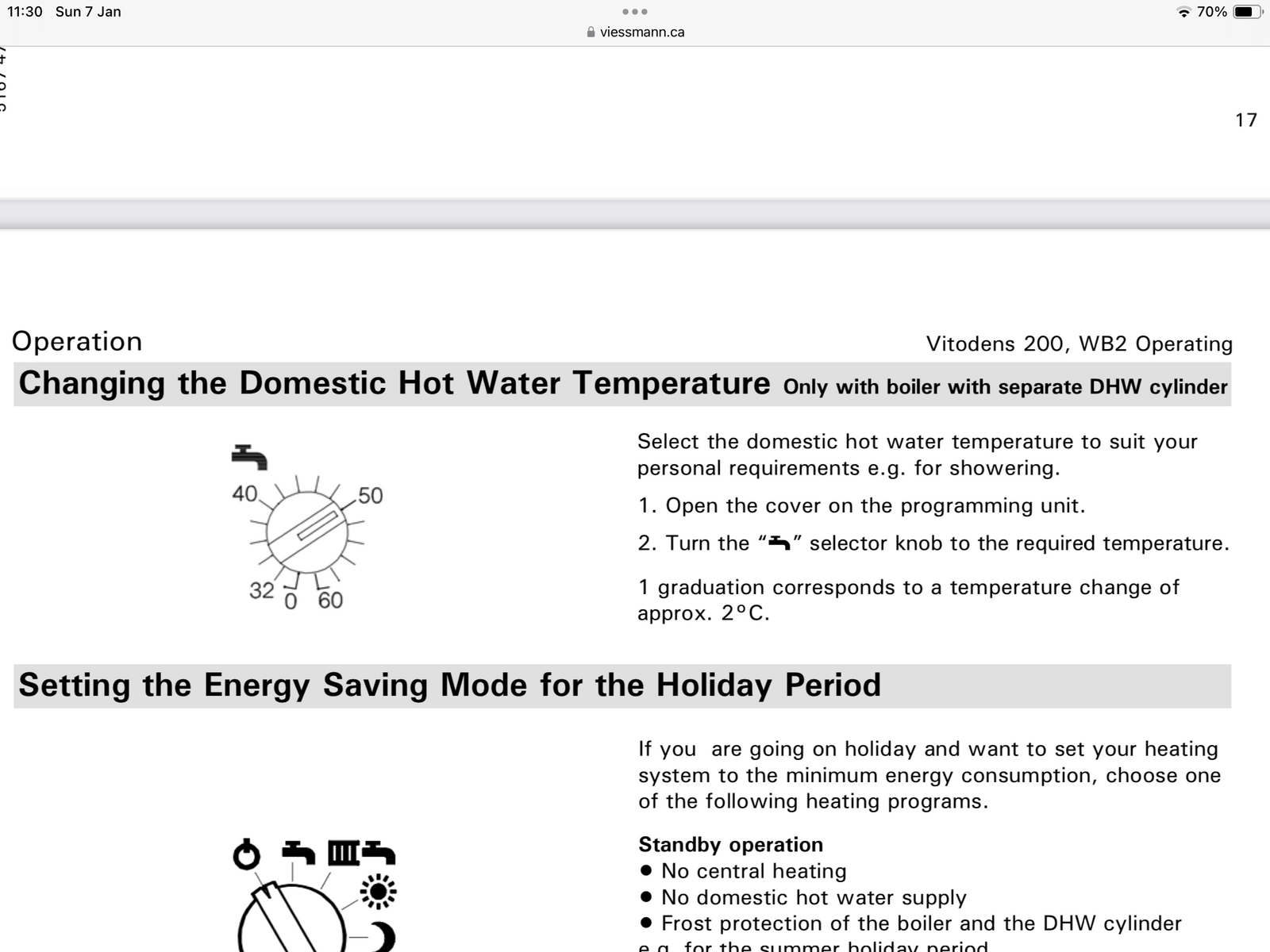

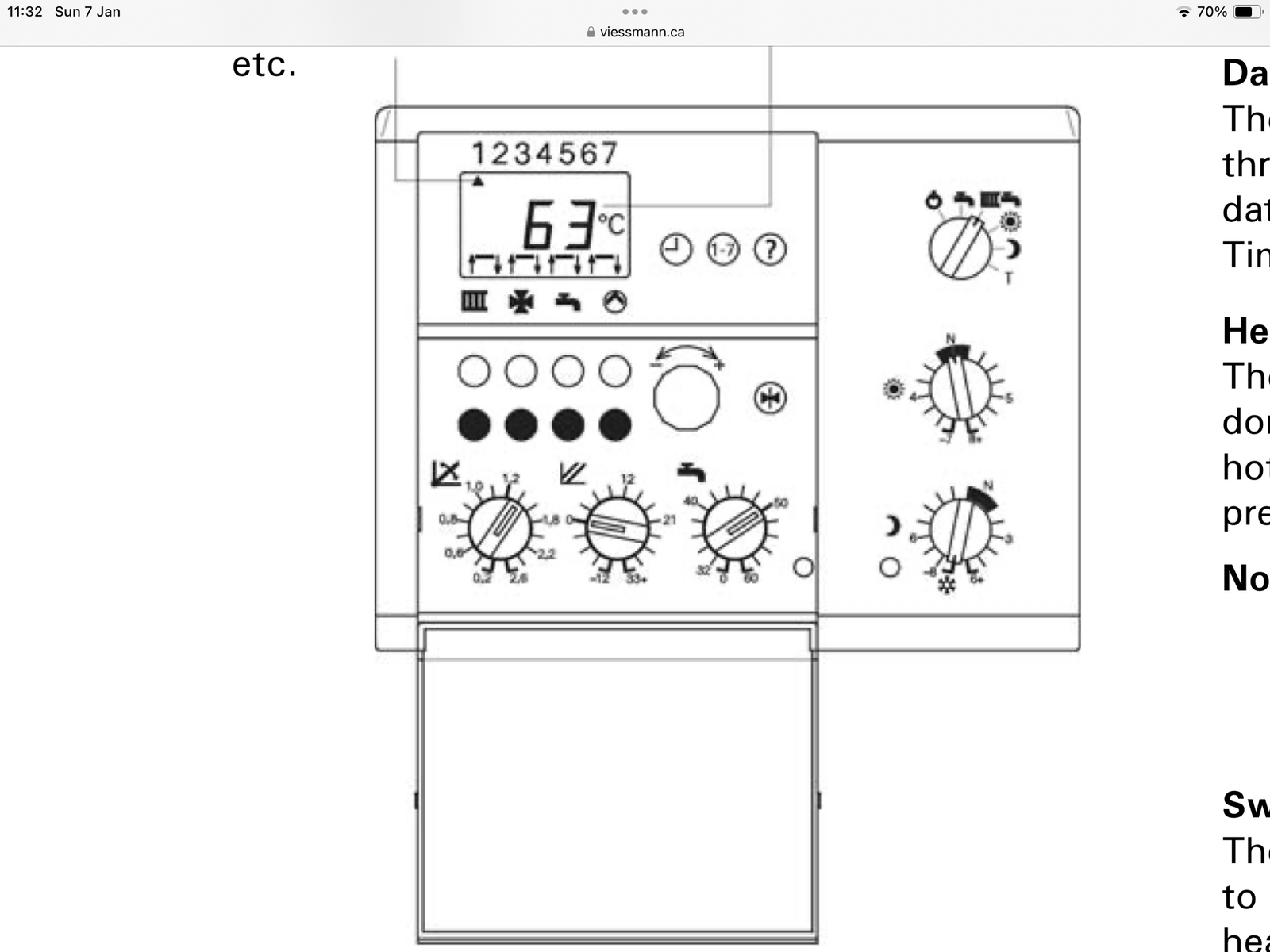

The above shows the 3 controls. Use the Tap controller to adjust the hot water temp
Thanks. However, I am familiar with the tap icon to change the HW set temp. But that changes it as a new default and only from when the set time come on. I want to give it (for example) a one hour boost, to fire up the boiler now and not to set a new default.
I do have an immersion heater boost but as that is only for an emergency, it is not on. Unfortunately, it is so bloody complex, it has a back-up battery to remember the settings. Since it has been off of a few years, the settings are lost and the power needs to be on for quite some time, to give the battery sufficient oomph before I can activate the one hour boost button.
The boiler does have 'Party' mode, which heats the DHW first before the floor heating, and comes on when activated, but one needs to set the room temp considerably higher first, and that seems a crazy way to just temporarily boost the DHW temp.
