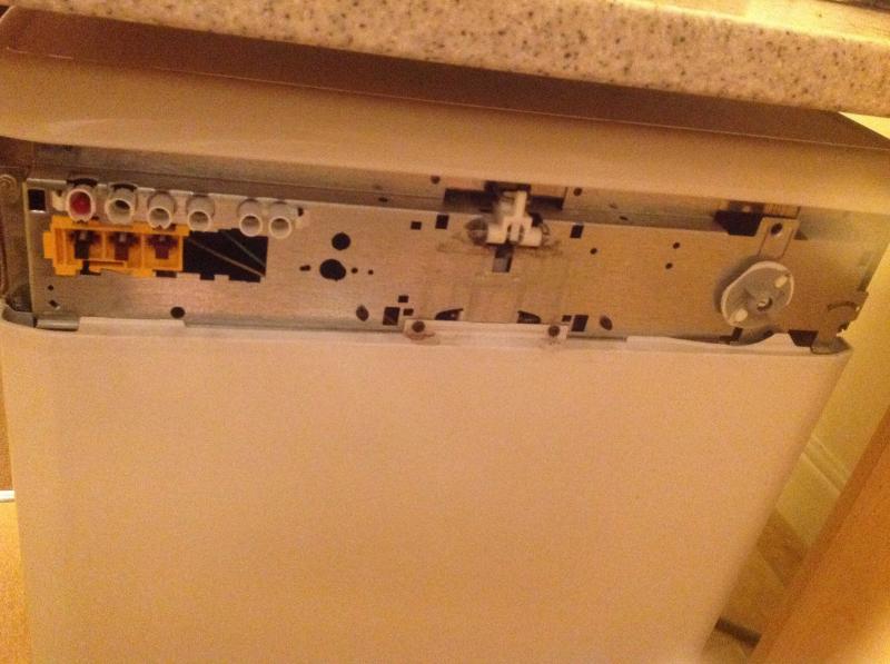

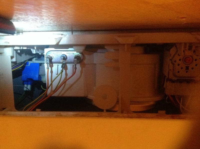

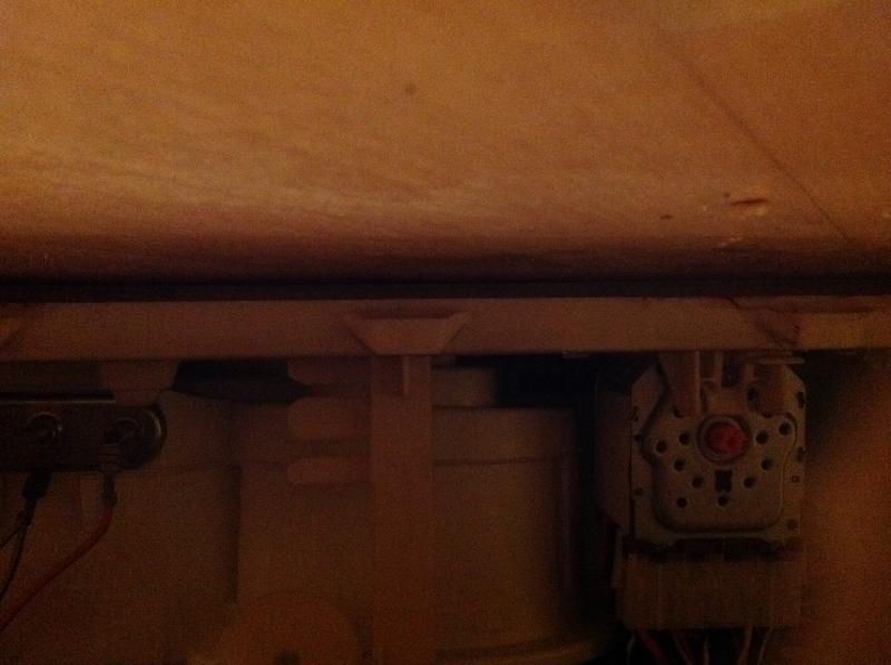

There is a reset. It's on the back of the heater. You have to remove the kickstrip and put your hand thou to the back of the heater box to press it to reset. Or you can get a torx screw into the timer at the front and turn it to the stop position.
Checked in the front , after opening the panel I do not seem to have any reset even behind the panel

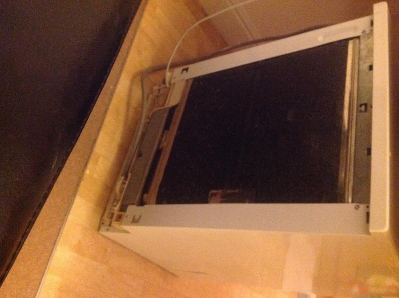

The black cover behind seems to be glued hard [/img]

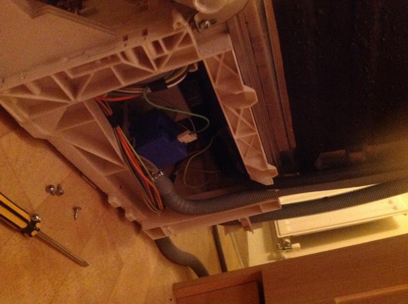

Kickstrip is down the front. right down the bottom. It's behind that.
Finally opened the kicks trip ,however can't seem to find any reset button .i have turned some orange looking thing not sure what that is .
